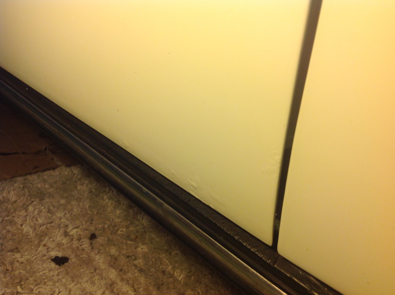

Looking for advice on whether to dive into this early, or leave until there are other areas of the car to look at at the same time. Piccie below is the lower front corner of the driver's door. I struggled to get a photo, as without very specific lighting the chamonix bubbles blend very well into the chamonix door!
The door skin is aluminium, so I guess that I'm looking at galvanic corrosion, not helped by the uk weather.
Should I wade in now, or leave it to evolve a bit? I'm quite good with steel bodywork, but I've not dealt with ally/ steel previously. Any tips? I have all winter....

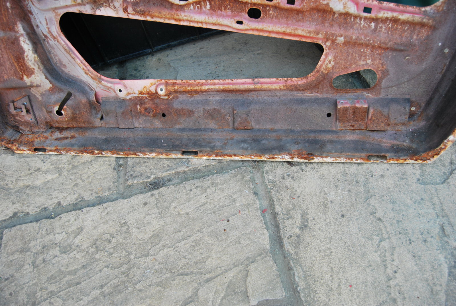

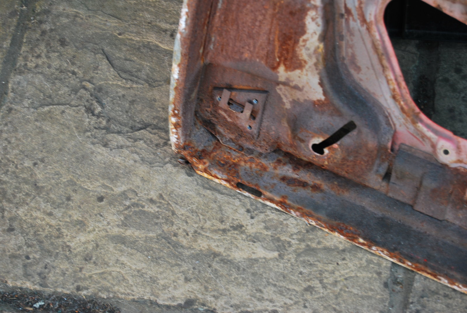

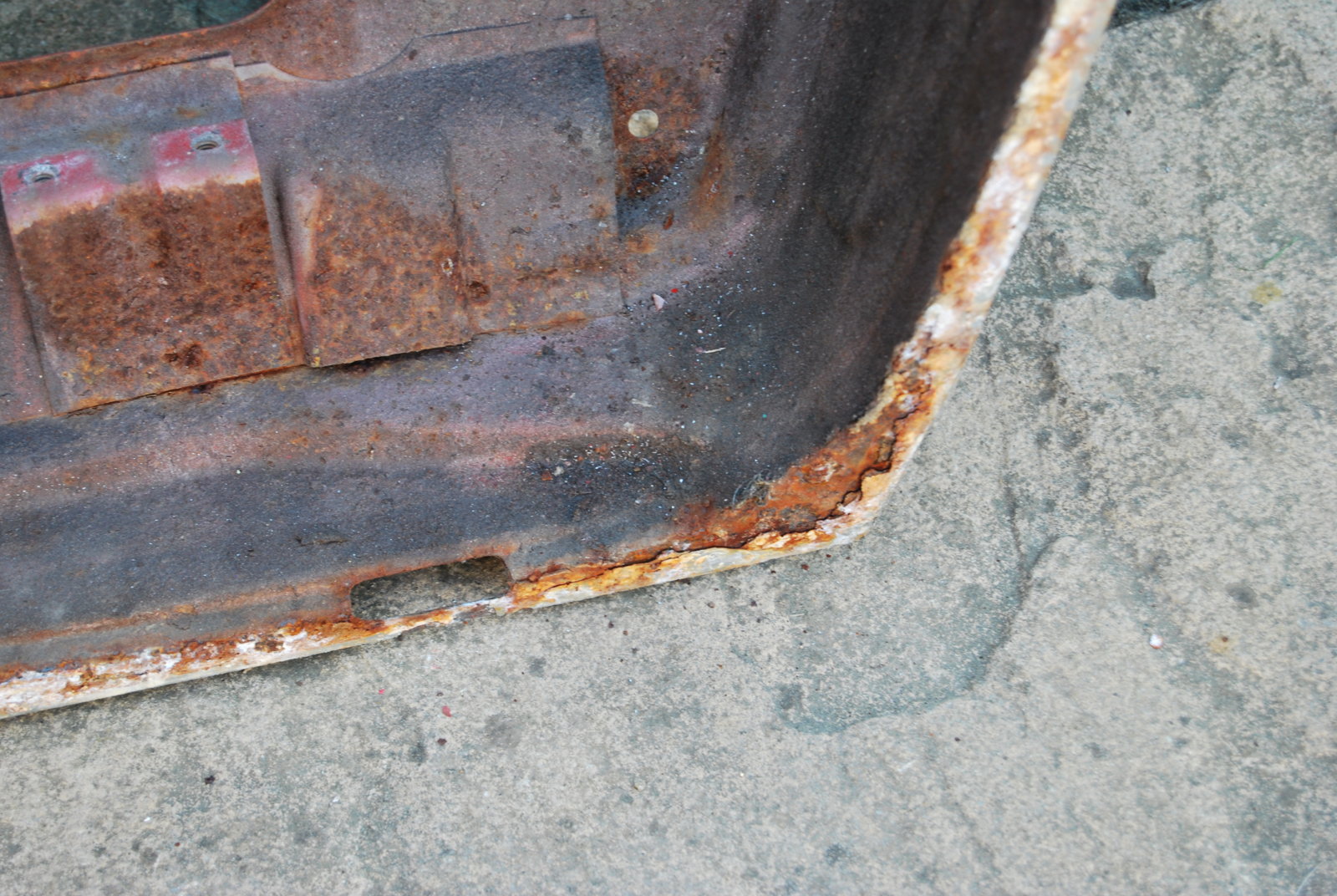

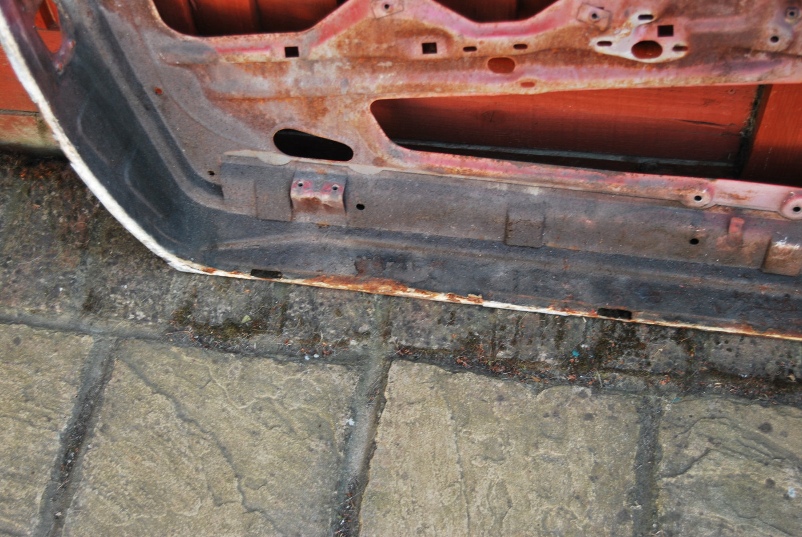

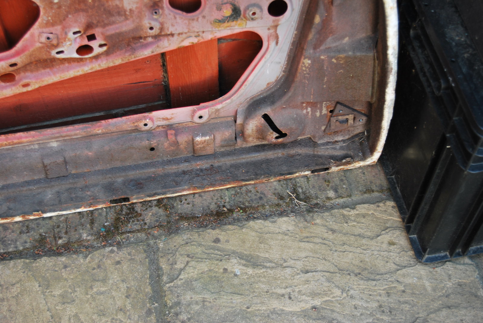

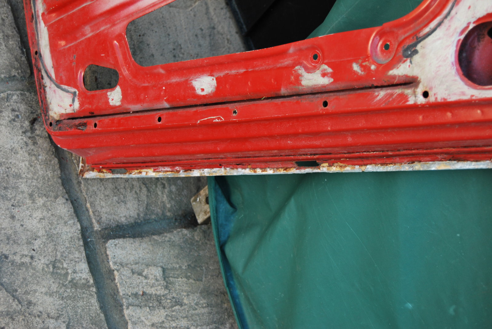

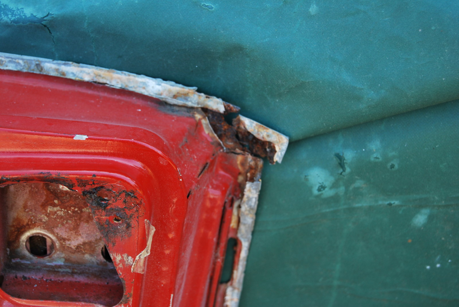

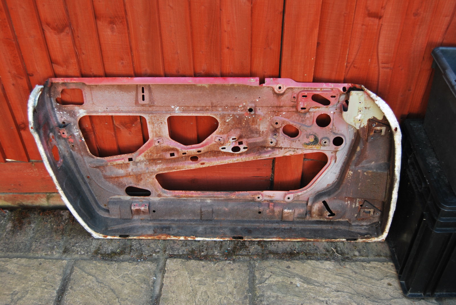

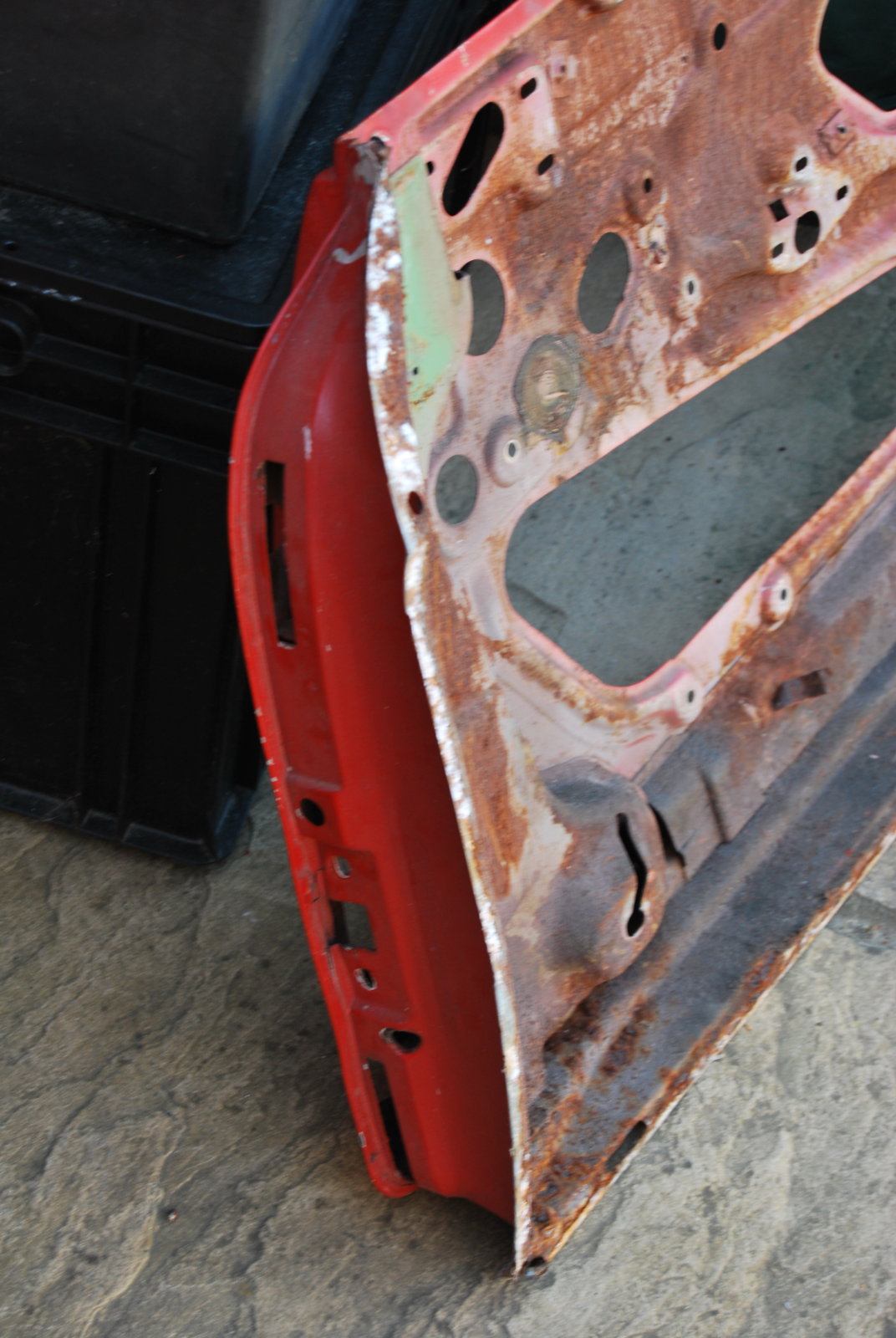

HI Drew, you can see in my pics why the ally skin goes, and always the same places, water in the doors and the skin being fitted without treatment or insulation from the steel.. My door frames are stripped back here and the bottoms were also too far gone so had to be replaced too.
I understand the Walloth door skin is reasonable but takes some effort to fit correctly.
Not shown on my doors here is the ally panel that goes from back to front at the top of the door to strengthen it.
