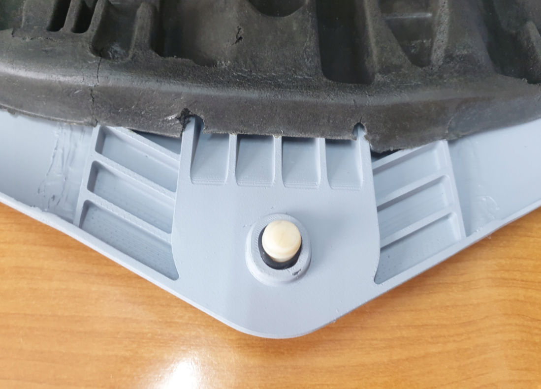

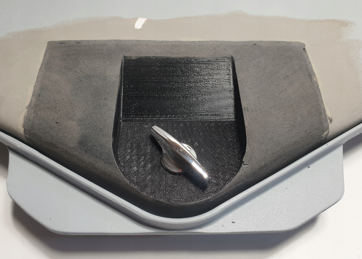

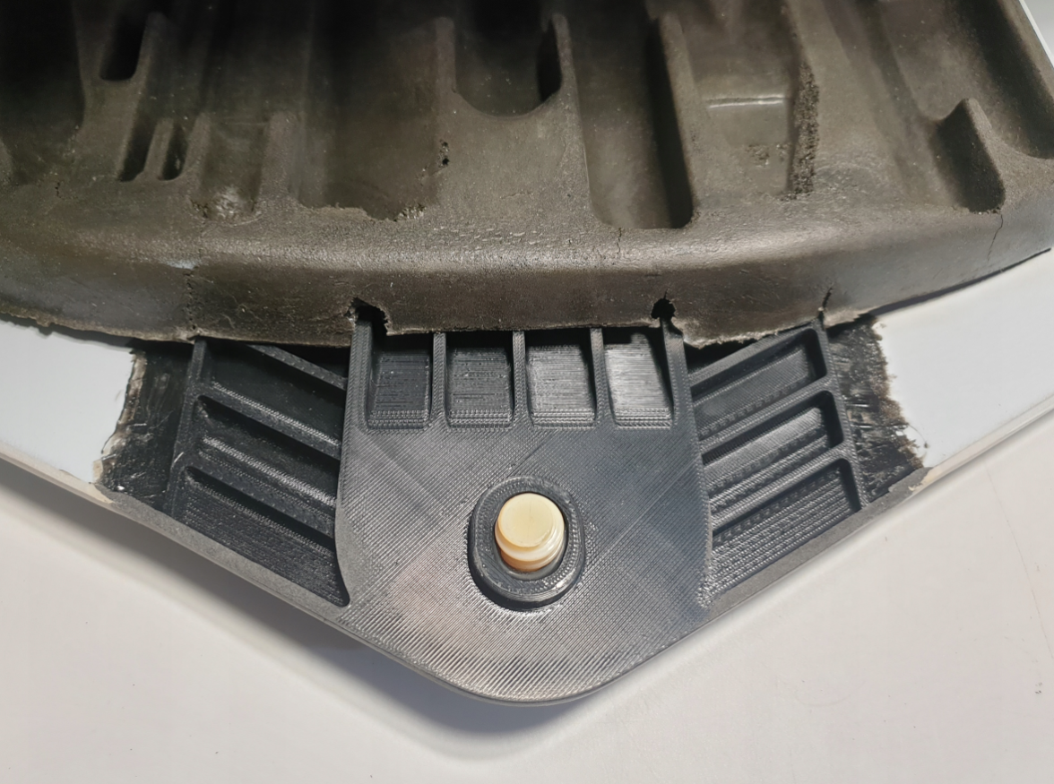

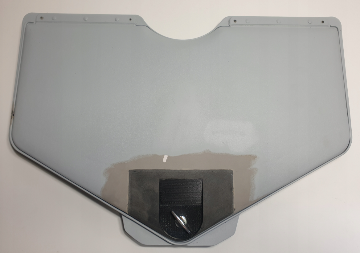

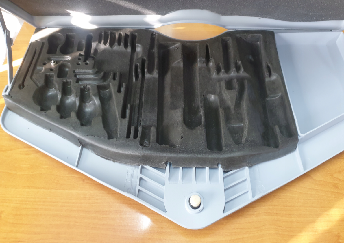

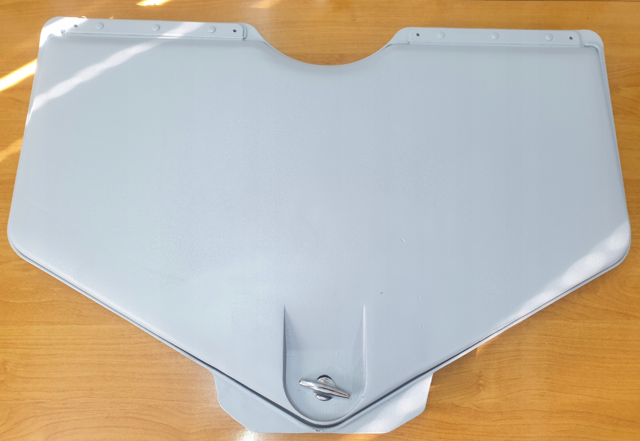

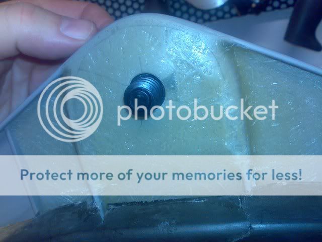

after some cleaning, redo holes, and so on
freshly renewed attachment area, circular support has been redo with composite
you may remember the "before" status:
you can see the transparent part of the circular support, that is the new circle section

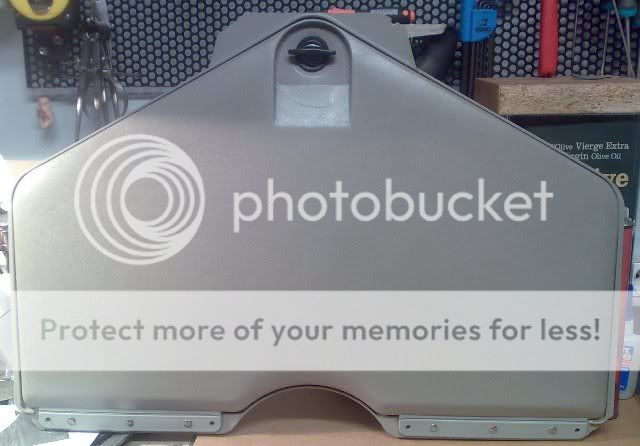

now, thanks murray for your ideas, i am preparing the adequate washers and screws, those must include a hard wide circular area and a soft adaptable rubber washer, but that one must be hand made, this tool allows you to design the exact size by a combination of outer and inner cutter
i do not hit the tool, i use pressure (it is smooth and controlable)
a view of the assembly, another rubber washer will be seating between the tool-box and the sheet metal to compensate any mishape
hope you would like it, sharing ideas is part of the hobby !
