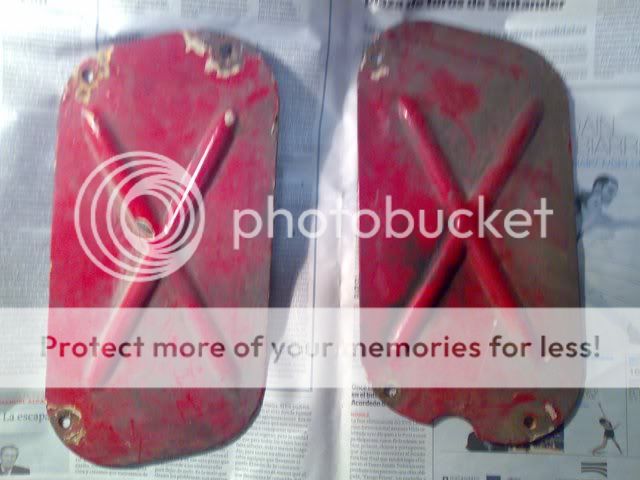

i am sharing with you a minor detailed work of the sheet metal covers that close the hole that give access to the headlamps from the engine compartment
i found those ones in germany, they were very rusty, but considering that they are not structural parts, i will do the following:
start
rust on the backside
take away the old paint with chemicals
white paint under the red one, repeat process
machine sanding, and rust converter
first paint: primer, see the holes, not very big
considering i am not an expert in welding or other skills to do it in a professional way, and also taken into account the size of the holes, i decided to put adhesive tape as a "moulding" to give the needed continuity to the shape, in order to pour special metallic compount (epoxi based), from the other side
to be continued
