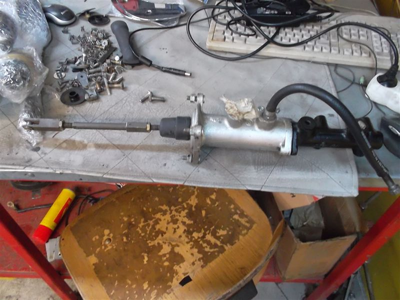

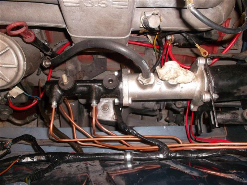

The sphere is a "bomb" and part of the engine swap.
I eliminated the normal brake booster for a hydraulic one (early 535 IIRC) and the bomb is there to serve as a backup if you lose brake pressure. It allows you to hit the brakes a few times if the "normal" pressure disappears. Like if the engine stops.
http://www.e9coupe.com/forum/attachment.php?attachmentid=11446&d=1408203386
The above pic shows the old brake cylinder with the new booster. I had to shorten the tube from the pedal assembly a bit as the new setup is a bit longer.
http://www.e9coupe.com/forum/attachment.php?attachmentid=11447&d=1408203479
The above picture shows it in place. You pretty much just have to hook it up to the hydraulic pump and it works. Been working for 12 years now without any issues or failures. Well, I had to replace the bomb once as the diaphragm in it had begun to leak but that is normal.
