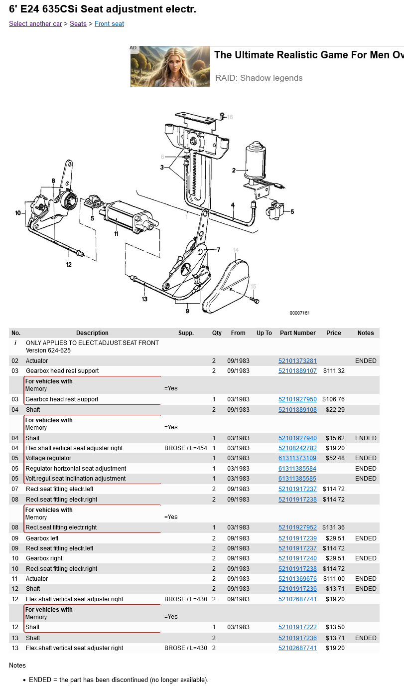

Ok, so my electric sport E24 seat has two short cables that are trashed (cannot recline) and I cannot locate these NLA parts (see #9 below). The ends of the cables are squared like a speedo cable but the center of the cable is round. I bought used longer ones but you cannot cut them and square them off, they just unravel. So does the speedo cable of an E3 or E9 have just the ends squared or is it the entire cable and if the entire cable is squared off, can someone pull a micrometer out and measure it? Of course is you have an old e24 sport seat and have these cables then, well....... I assume they are round also to spin freely in their sheath but you never know.

what year is the e24? just curious if it was a later version that was similar to the M5 / 535i seats ... or the e12 based e24 that had the early style seats. the drawing makes me think later e24
It is an 86. Cables are short, sheath is 190mm so I think these are 215mm overall.

I looked at the lengths in RealOem and the shortest is 215mm which prob includes the 190mm sheath and 25mm for the ends that are squared off. GetBMWParts still lists them so I will call before I order and get the NLA email the next day. If NLA, then a search for a speedo cable. WN seems to have them but 50 euros to ship 30 euros in parts, I'm not there yet!

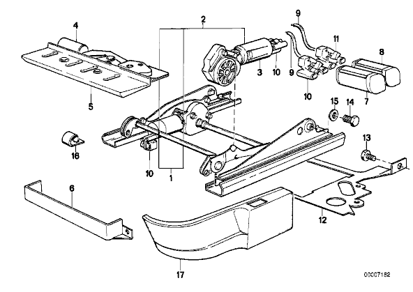

the realoem page you attached is for vertical height adjustment - what about this? parts number 12 + 13
I measured the sheath and it is 190mm, threw in 1/2 inch to stick out at each end or 25mm more and that's 115mm. I ordered 2 , 115mm length cables from the dealer. Coming from Germany, 25 bucks each. Let you know when I get it.
