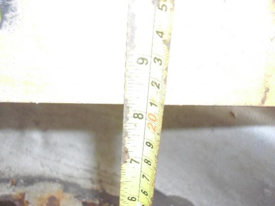

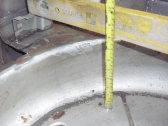

I'm looking for some rough dimensions in the trunk area, any help greatly appreciated:
The depth of the main trunk floor from the raised area near to the rear seat/firewall area, i guess about 3"? Plus the depth from the main floor to the bottom of the tyre well, perhaps about 9"?
My car had its original trunk floor cut out some years ago (pre my ownership) and replaced with a flat floor. Its all been cut out and will be replaced to hold a recessed fuel cell. Just looking to get a rough idea of the original depths.
JP
Boot Dimensions
I've been working on mine this weekend so have some photos for you.
Good guess with the 3" step but the wheel depth is 8 1/8".
John.
