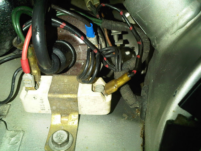

Check the green and other wires at the resistor by the ignition coil - if they are loose it can cause jumping:

The pic of the resistor smack dab next to the coil is just asking for problems (seems to me, anyway) with the HT lead so close to other conductors.

a picture of your coil wiring and a video of the tach acting up so we can see what's up.
