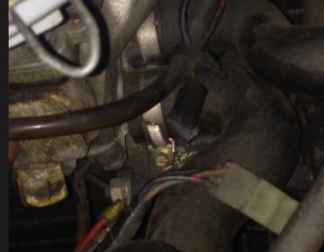

  • not sure what else to say or report, other than there appears to be a cord/sensor that has nothing attached to it, see picture link below. Not sure if related or what that is for, but if relates to something that would warn me when it is out, i need to fix that asap.
