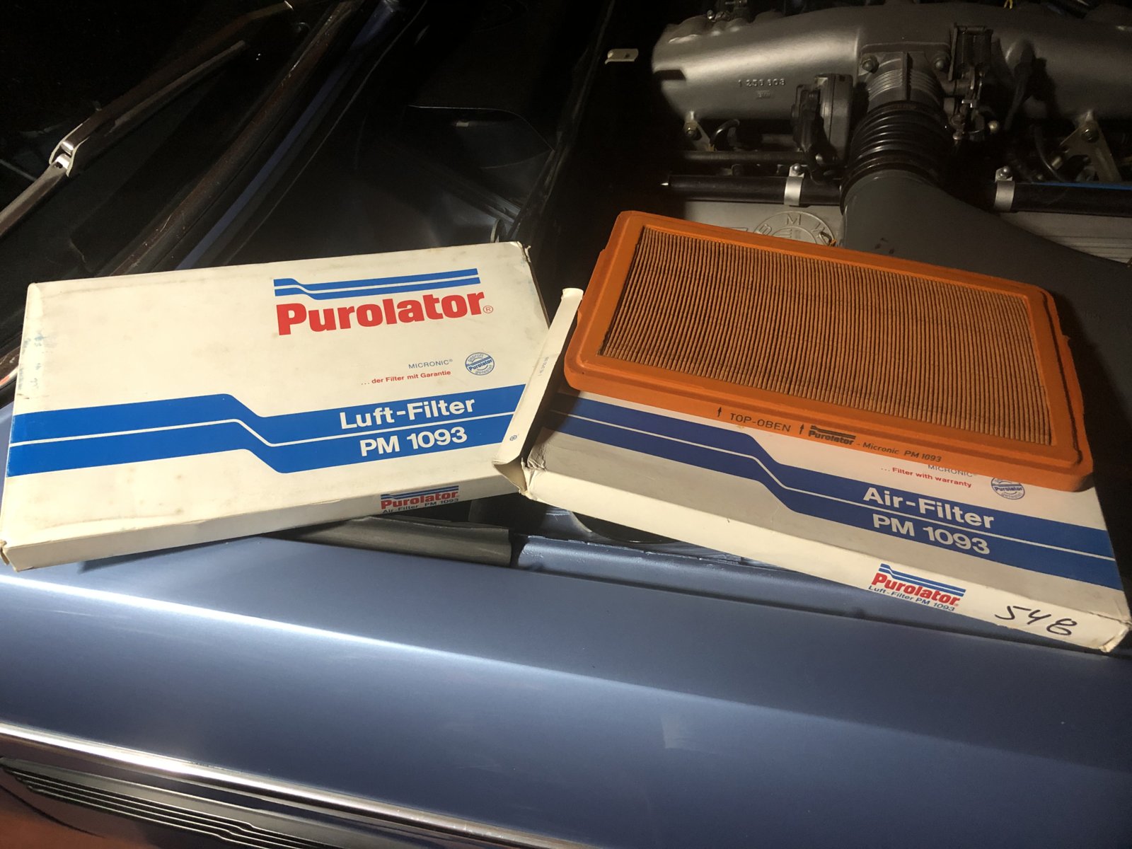

Where to buy the CSi air filter in the USA? I see 2 part numbers, 13721256548 and 13721256390 so not sure which to search for and what will show up at my door. Any accurate sources appreciated.
There are 2 that will work. Purolator PM 1093 & Mahle LX 252 which has metal reinforcing on top.
Part numbers 13721256548 and 13721256390 are like the Purolator PM 1093s
