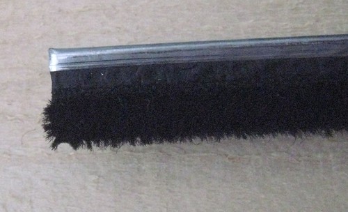

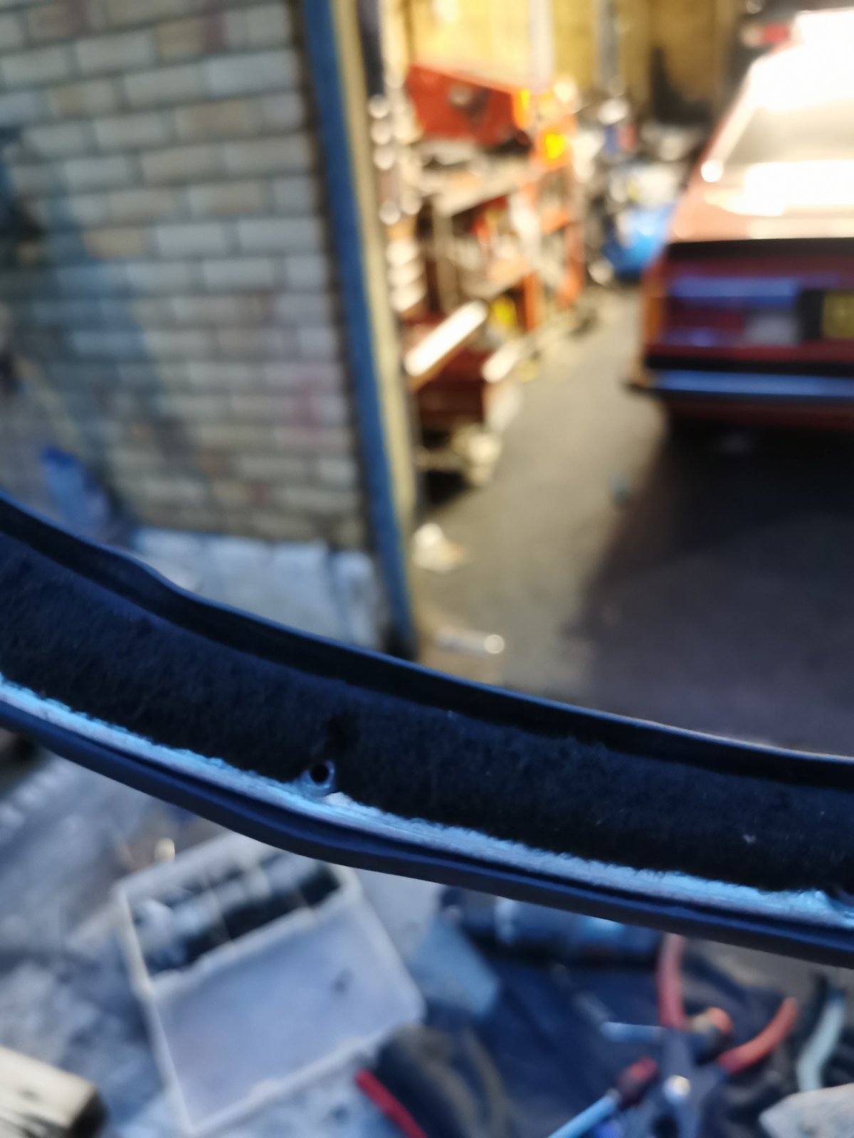

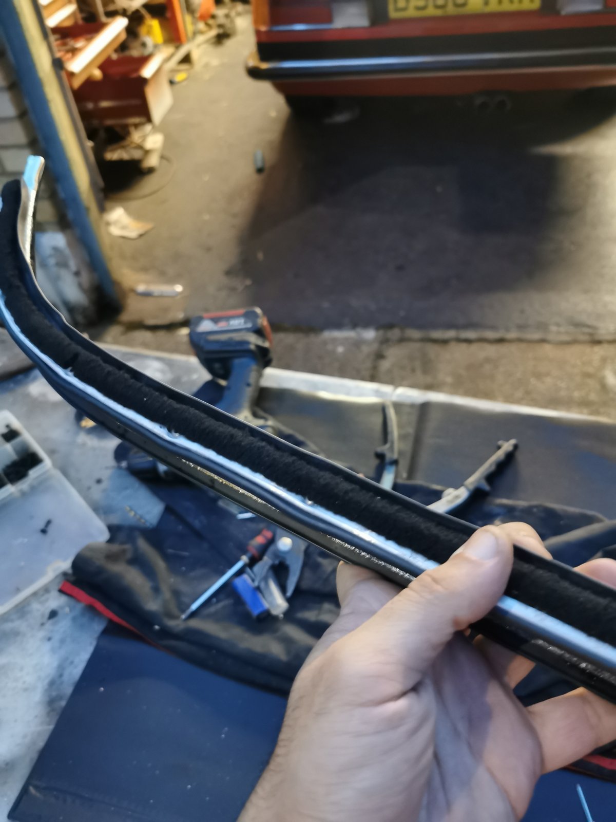

If anyone is struggling to find the rear window brush felt that rivets onto the chrome, I've found that 2 of these fit well, can be bent to shape and drills easily enough.
