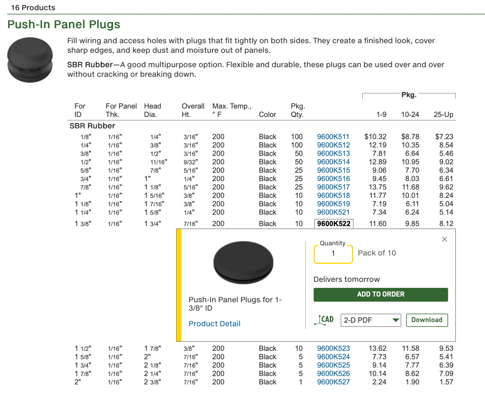

Are you looking for original,, or just a panel plug to fill a 35 mm hole?

i've got to fill the holes - and i would think it needs to be water tight. i would like it to look original, but doesn't have to be original ... i didn't find a part number in realoem.
The ones in the attachment above will fit a 34.9 mm hole. No idea what the originals look like, but these seem pretty ordinary. Made for 1/16 panel, which might be somewhat thicker than 18 Ga steel (0.0625" vs 0.0478"), SI the diameter is right. Should probably be OK.
