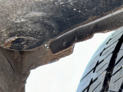

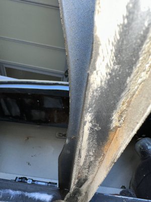

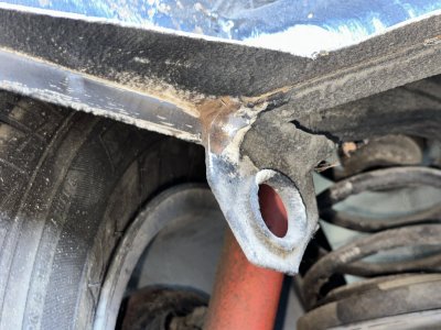

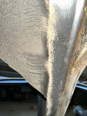

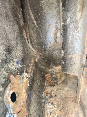

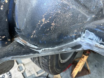

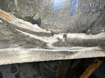

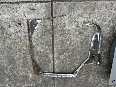

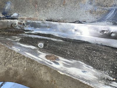

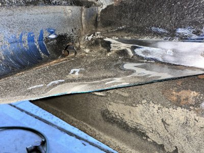

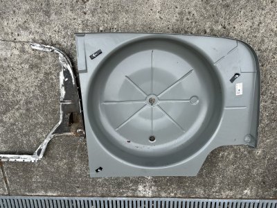

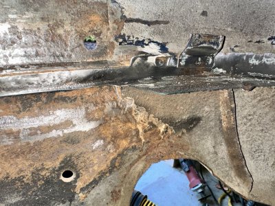

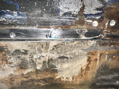

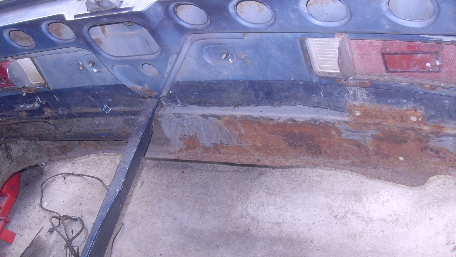

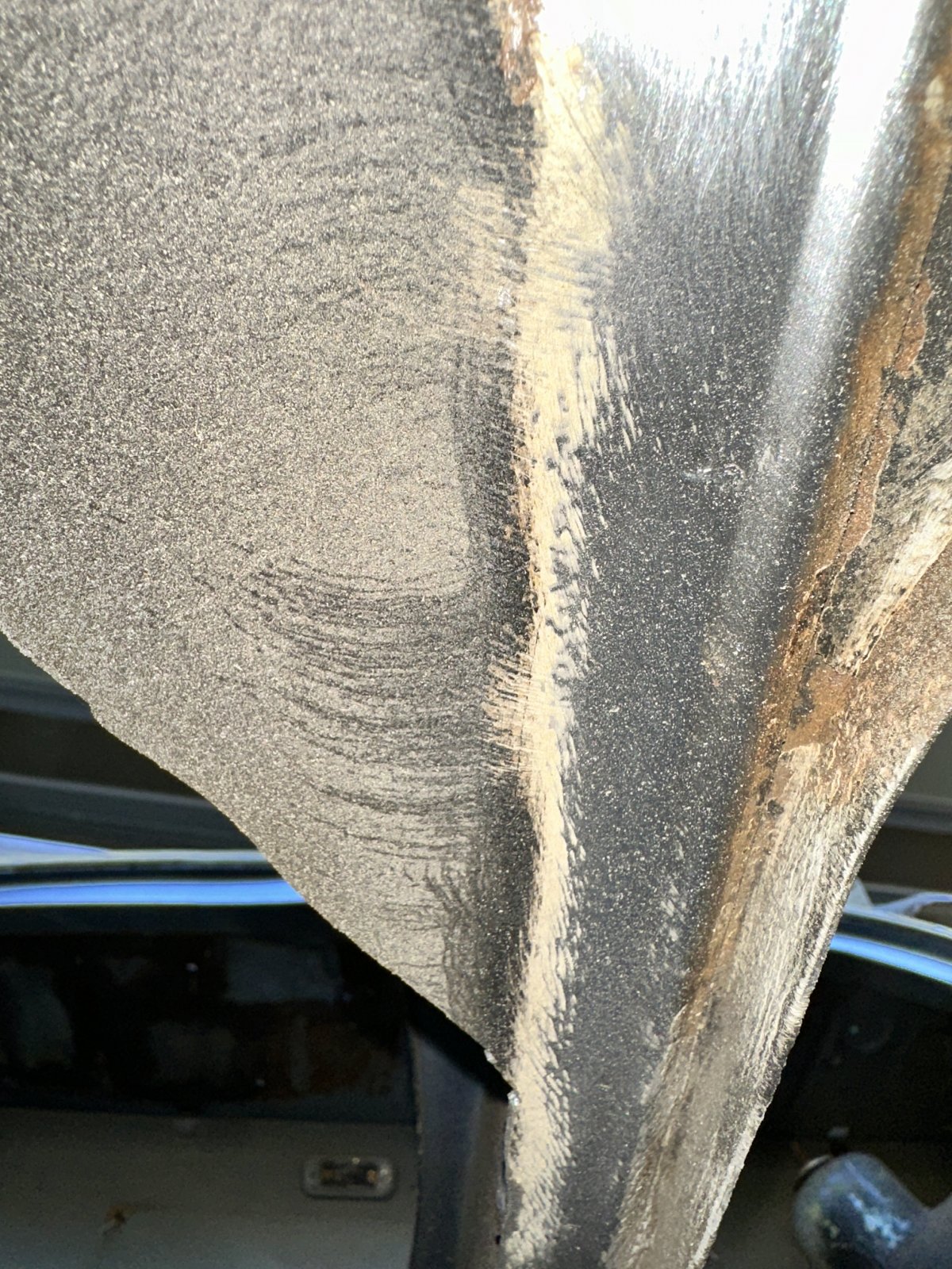

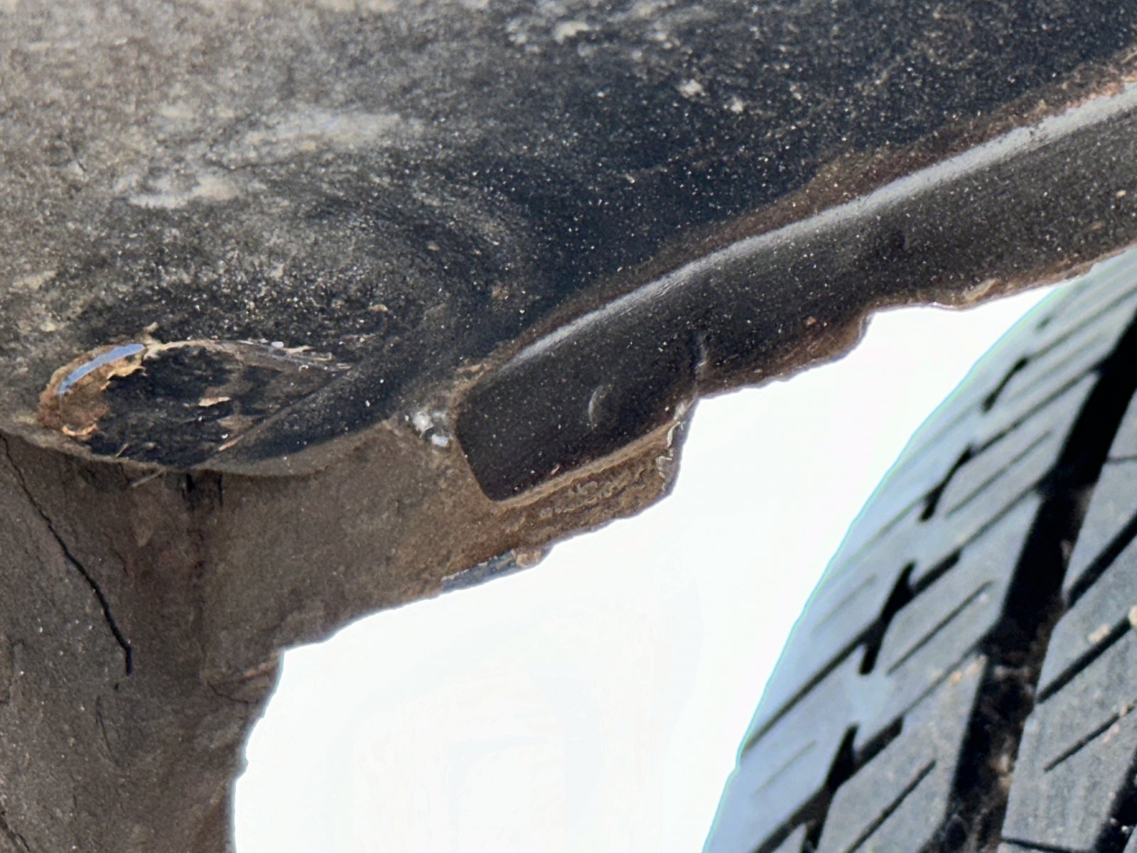

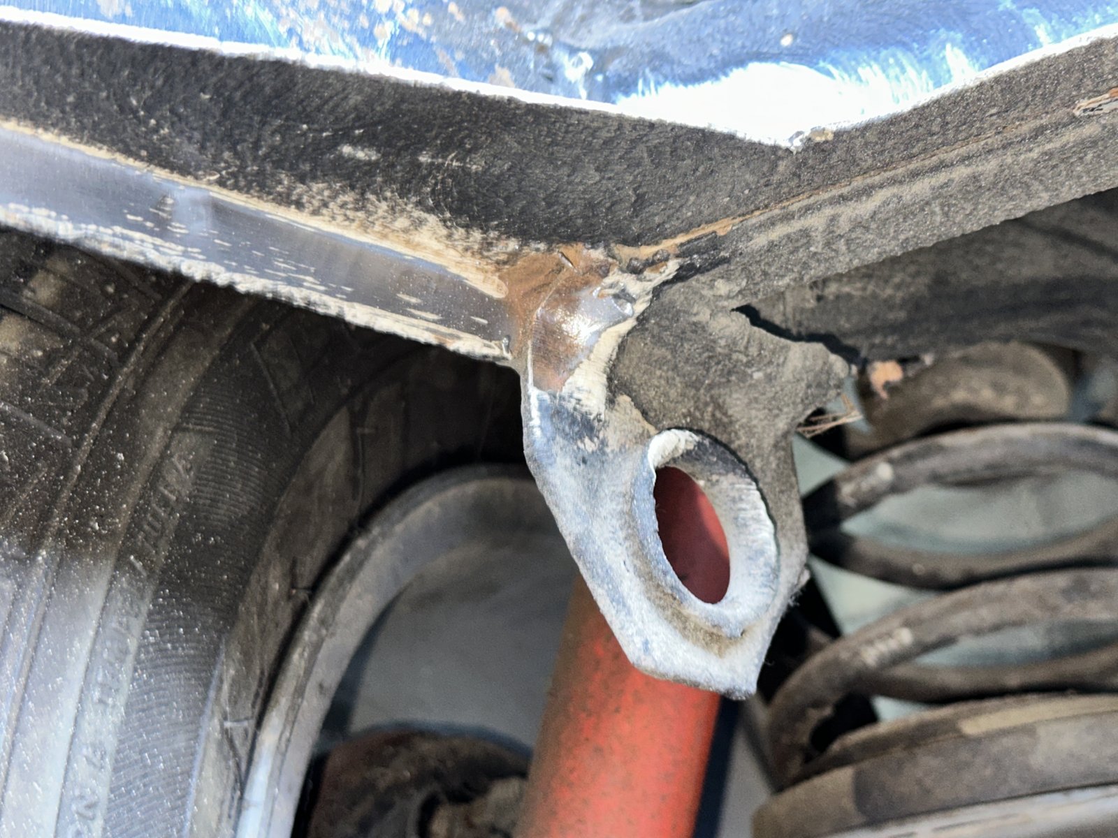

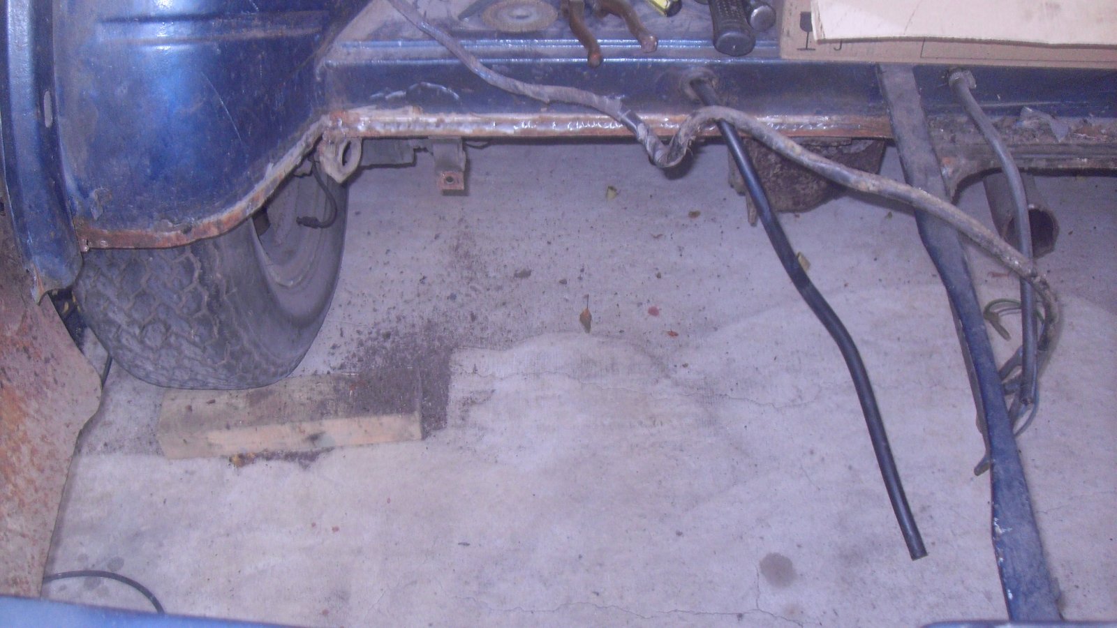

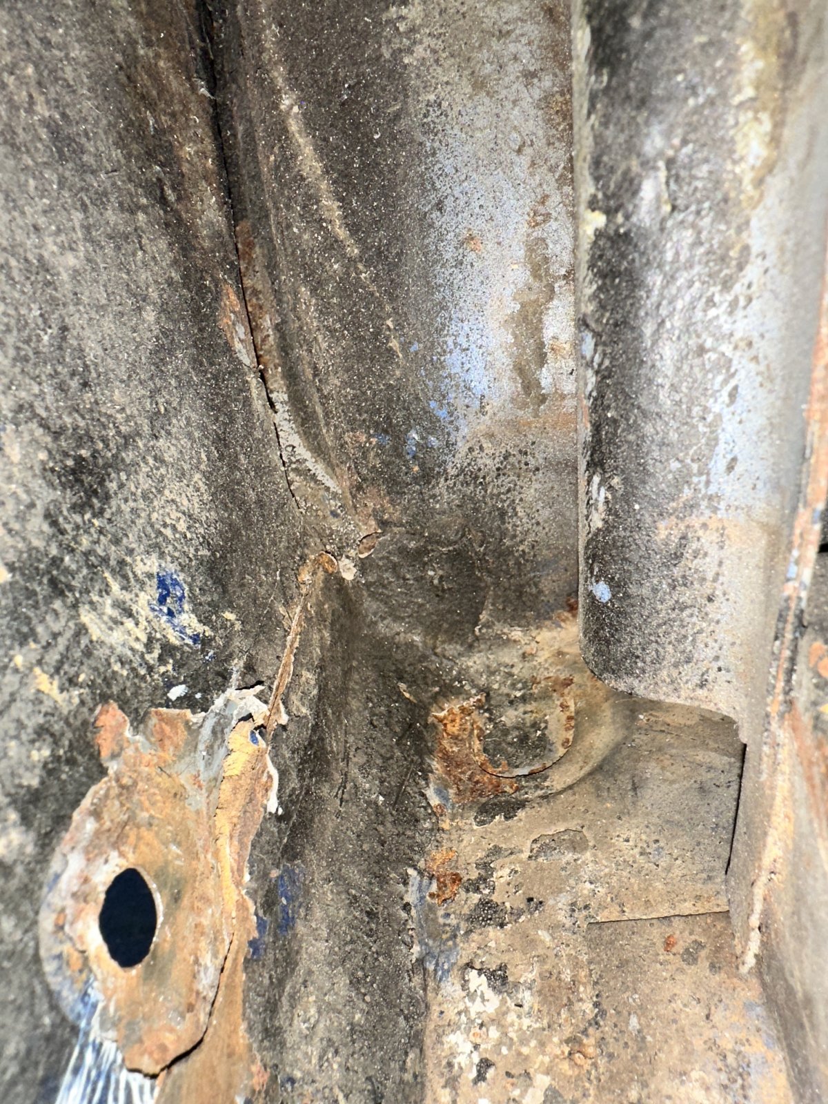

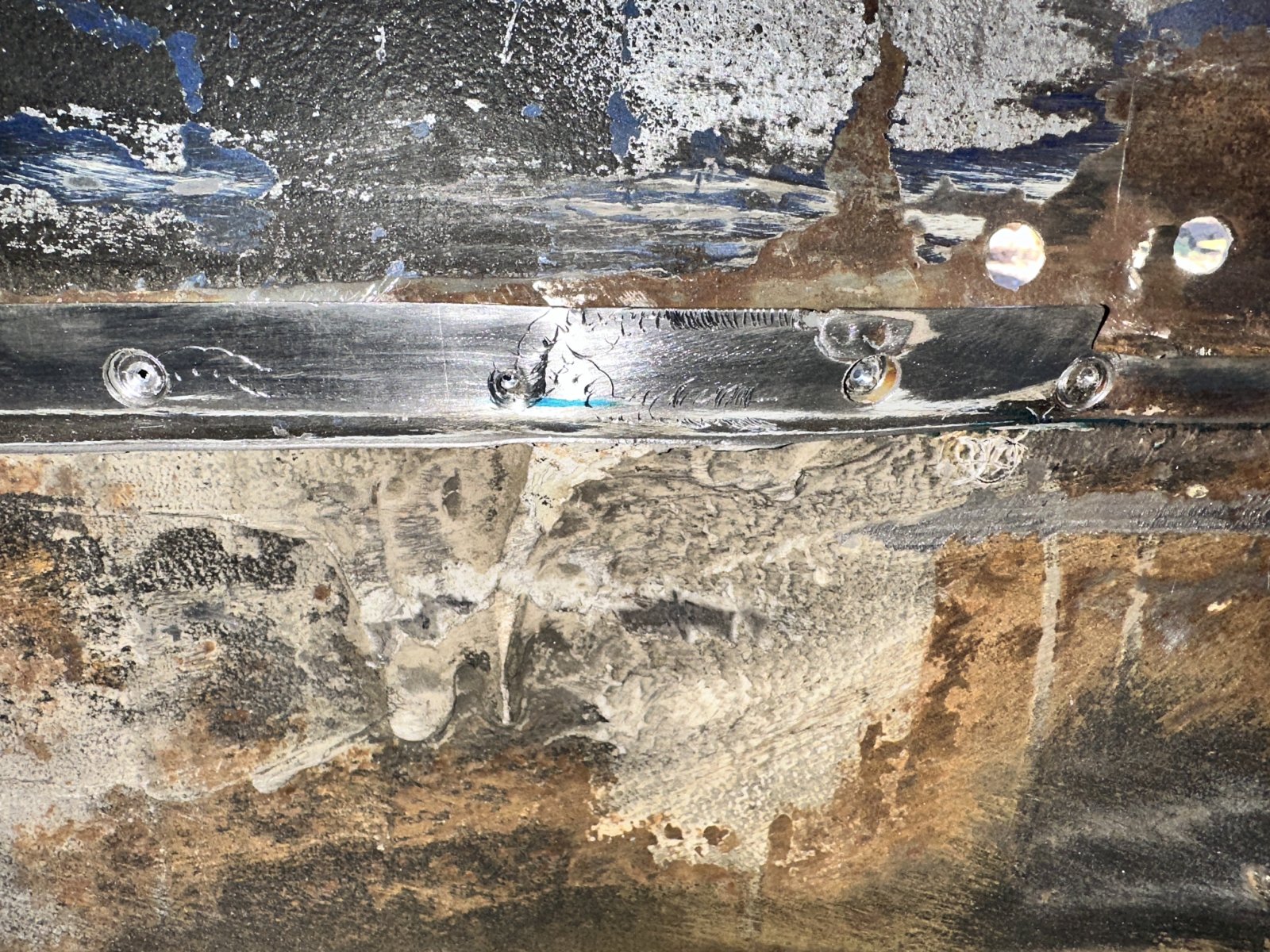

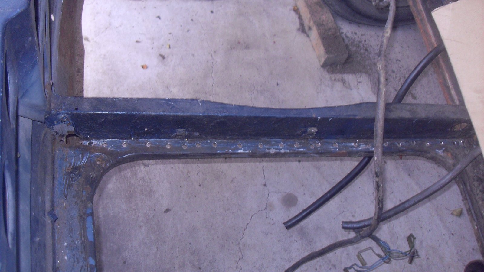

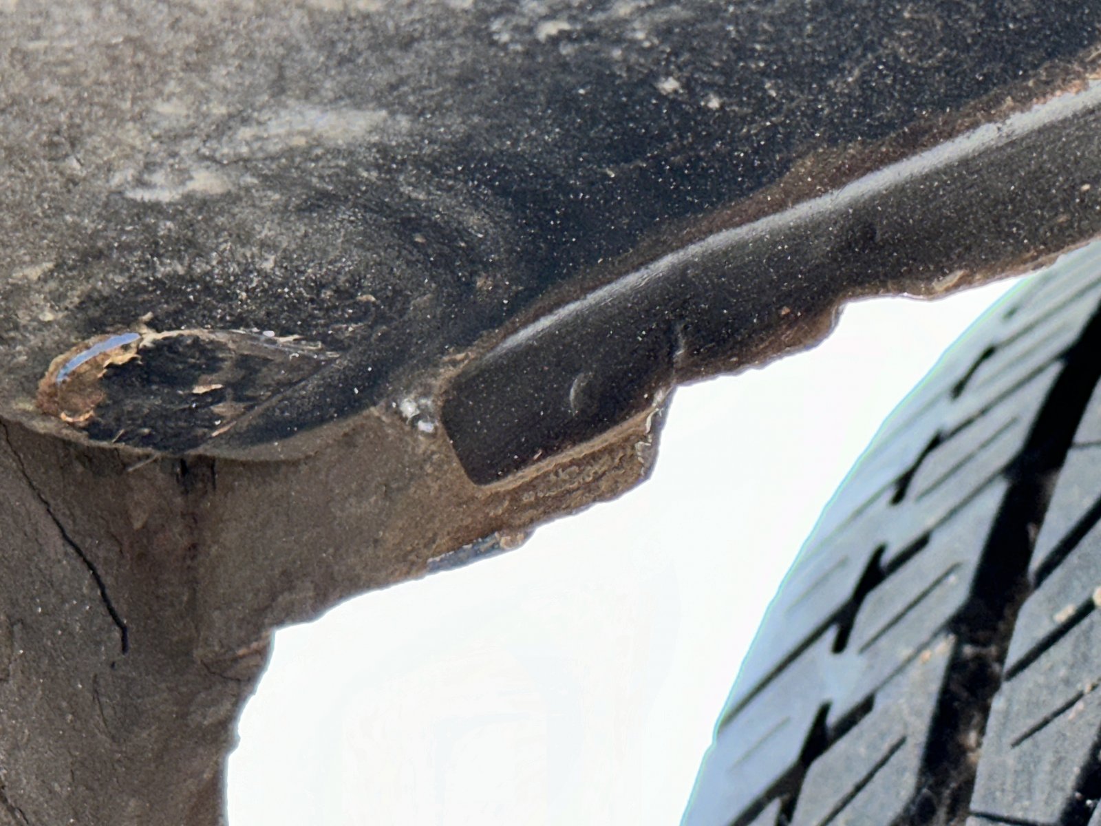

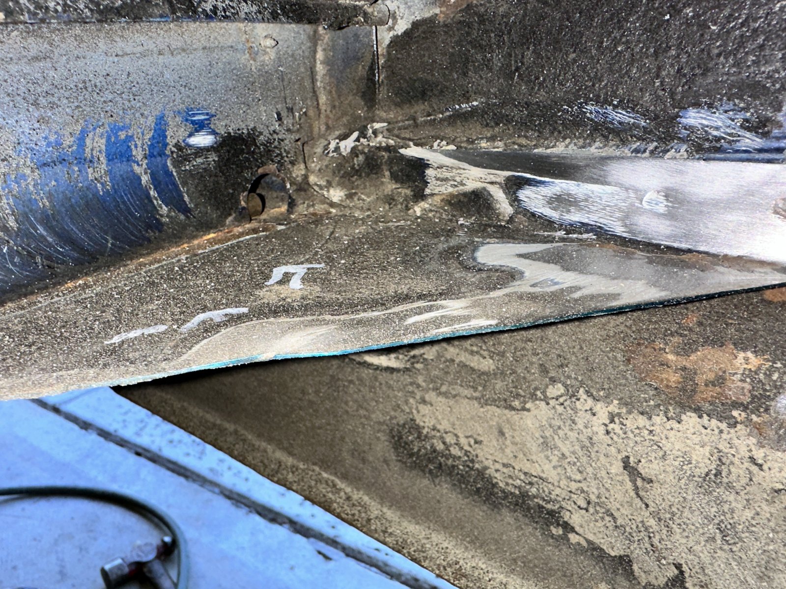

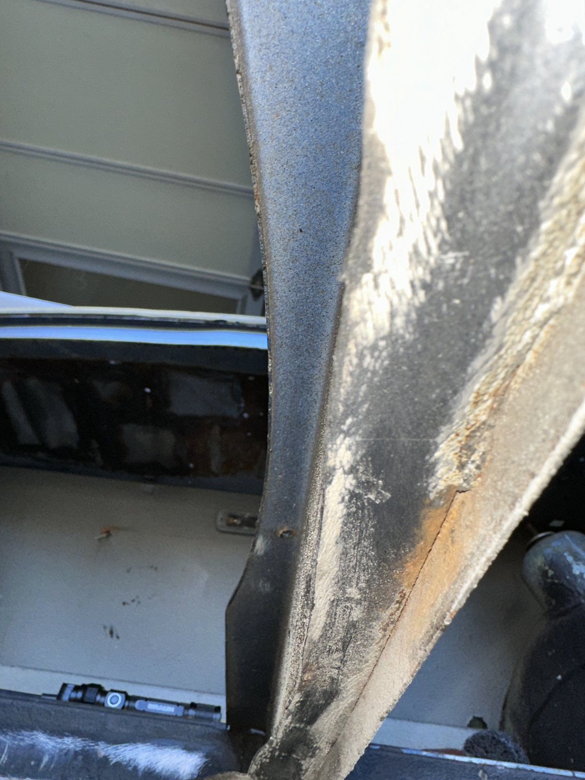

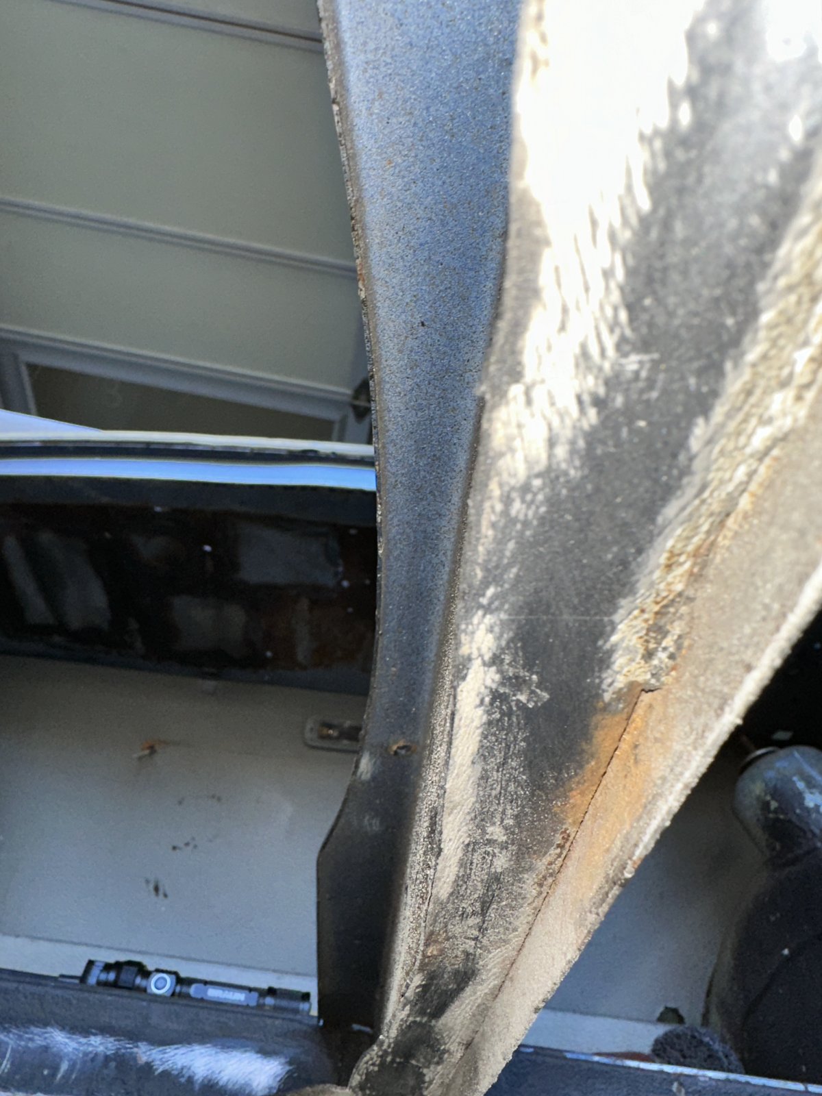

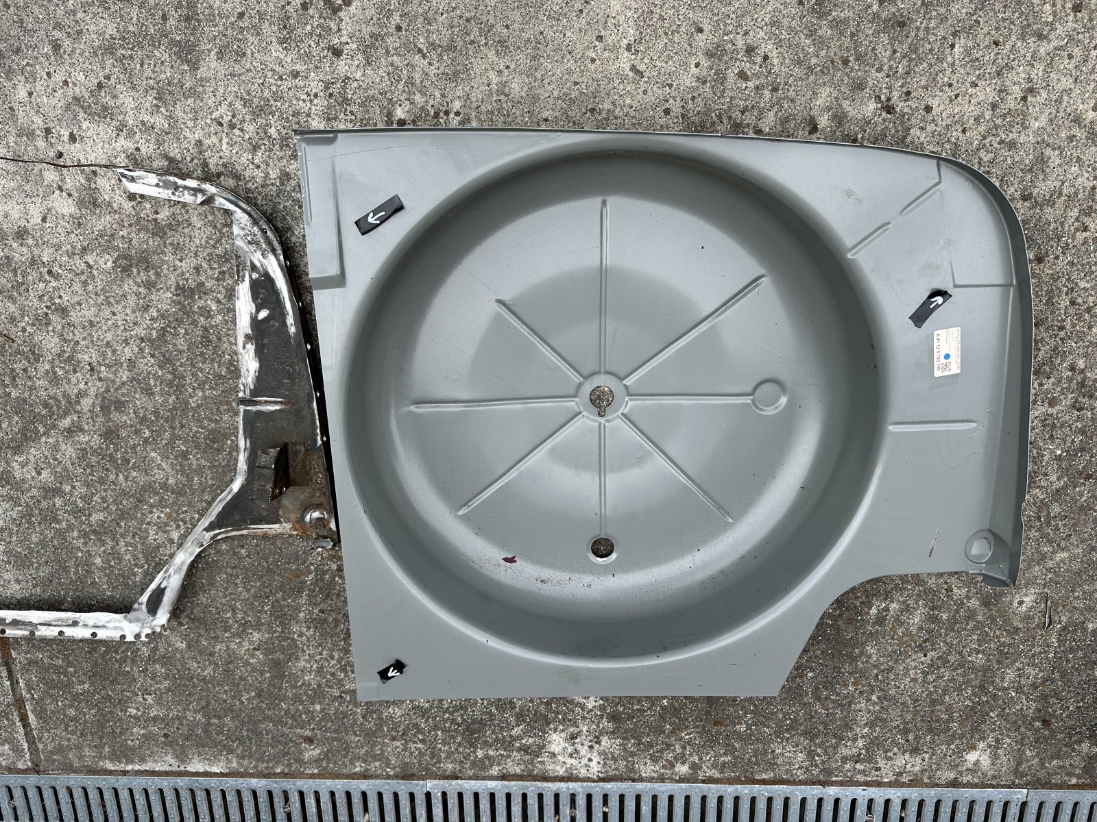

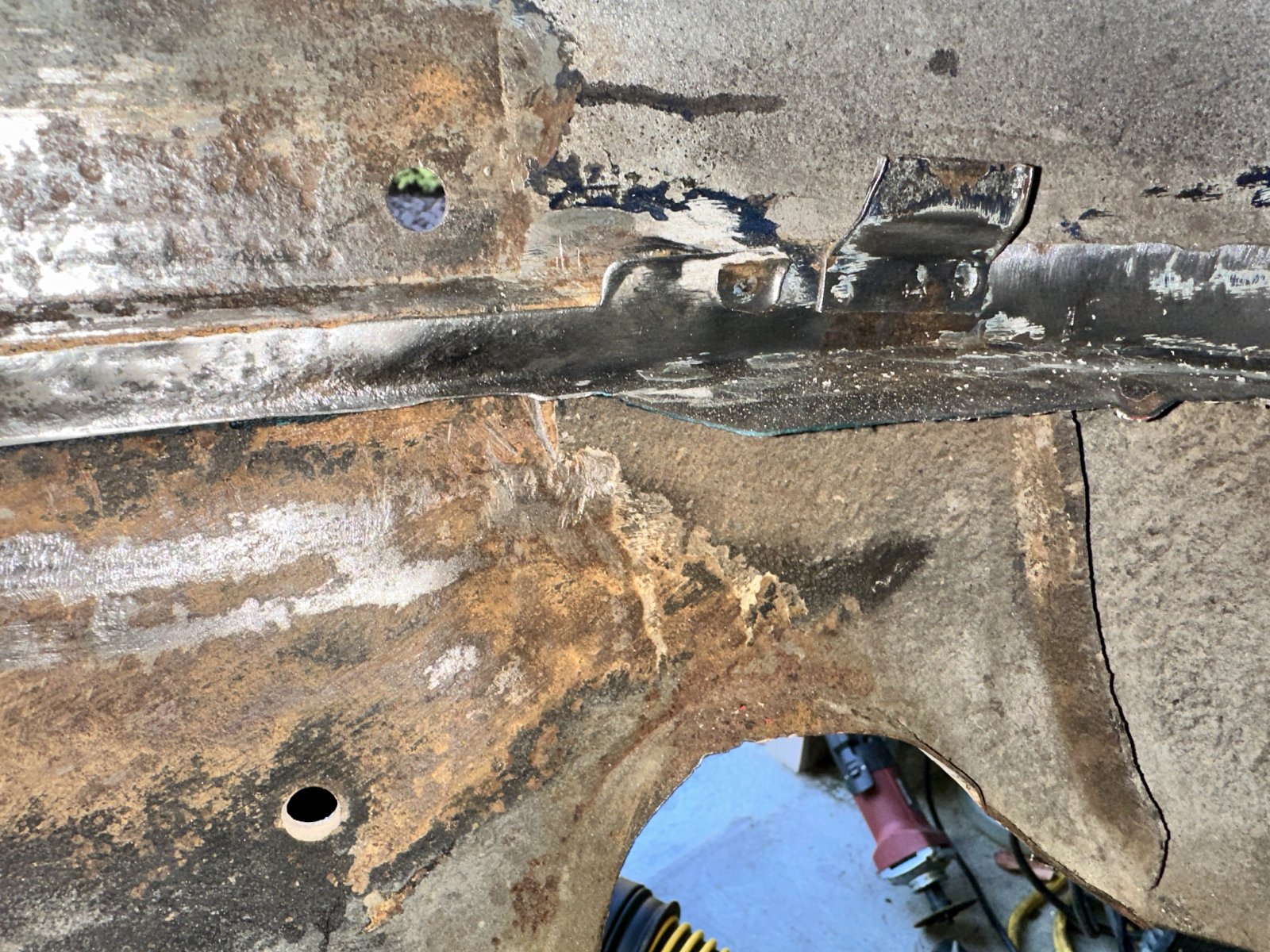

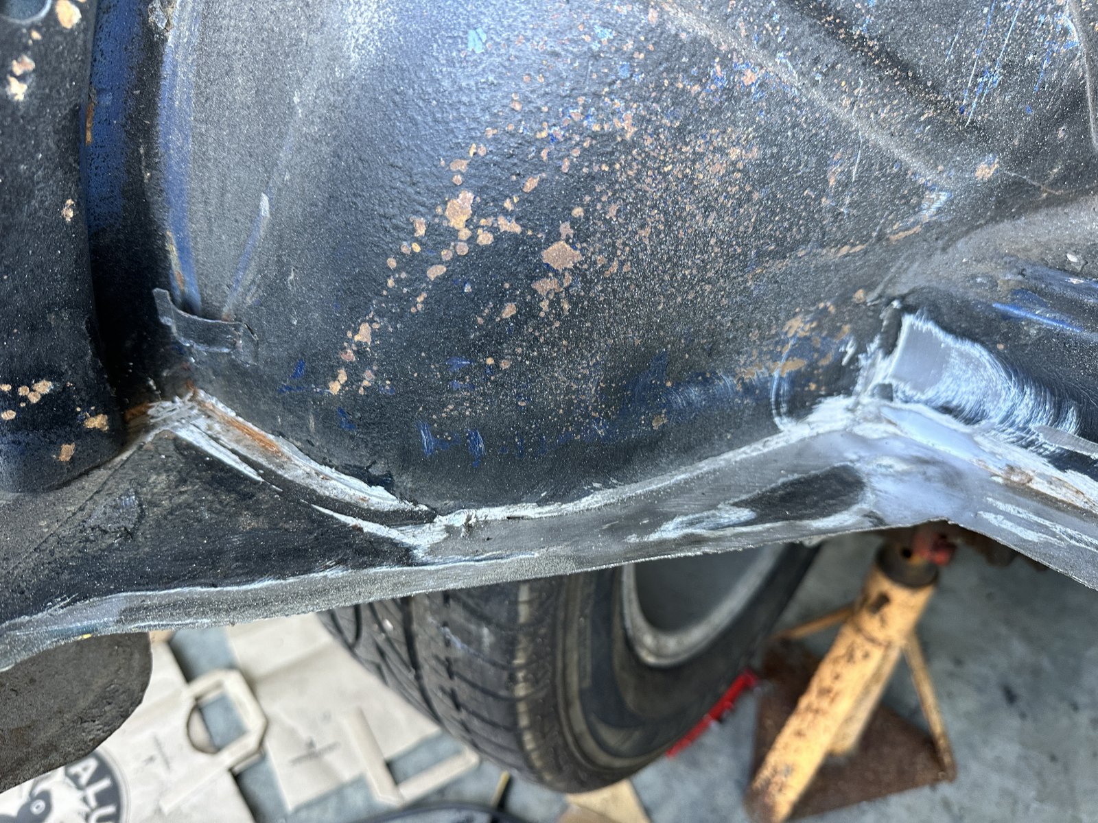

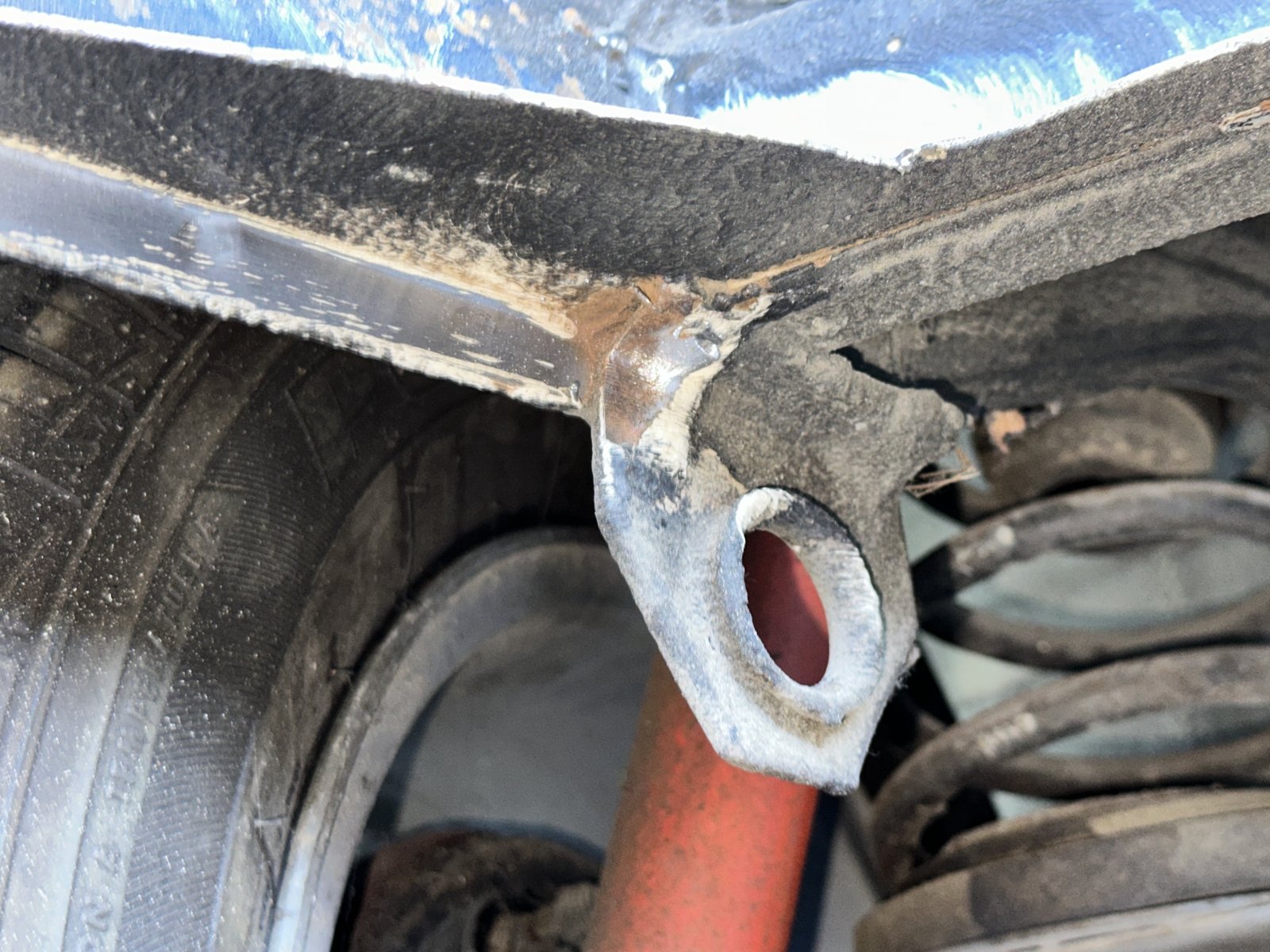

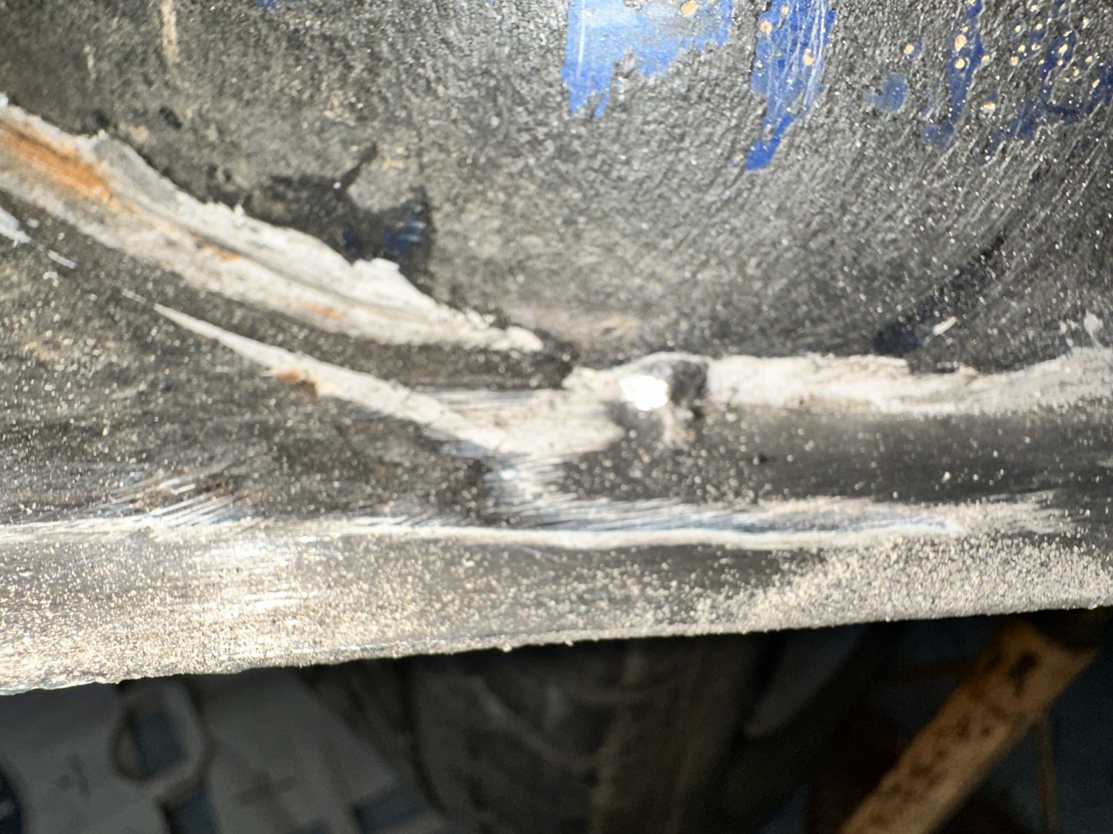

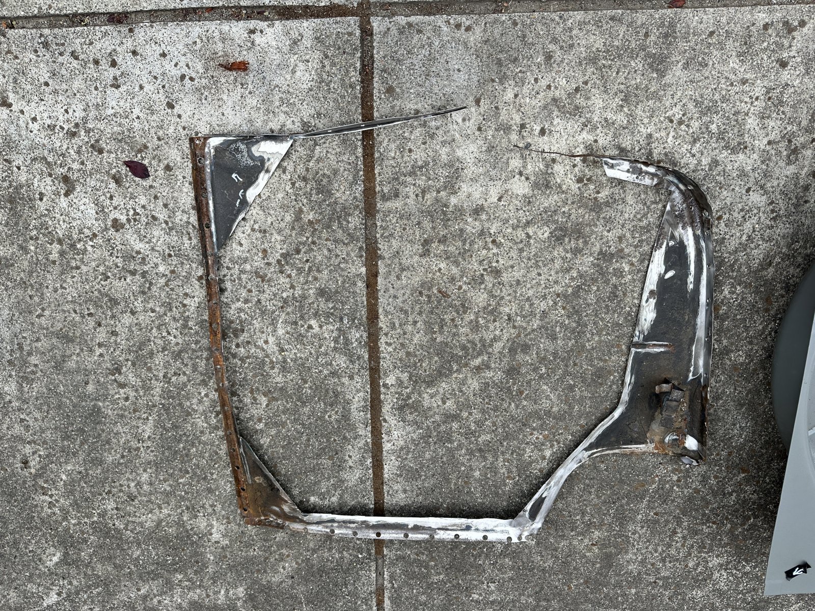

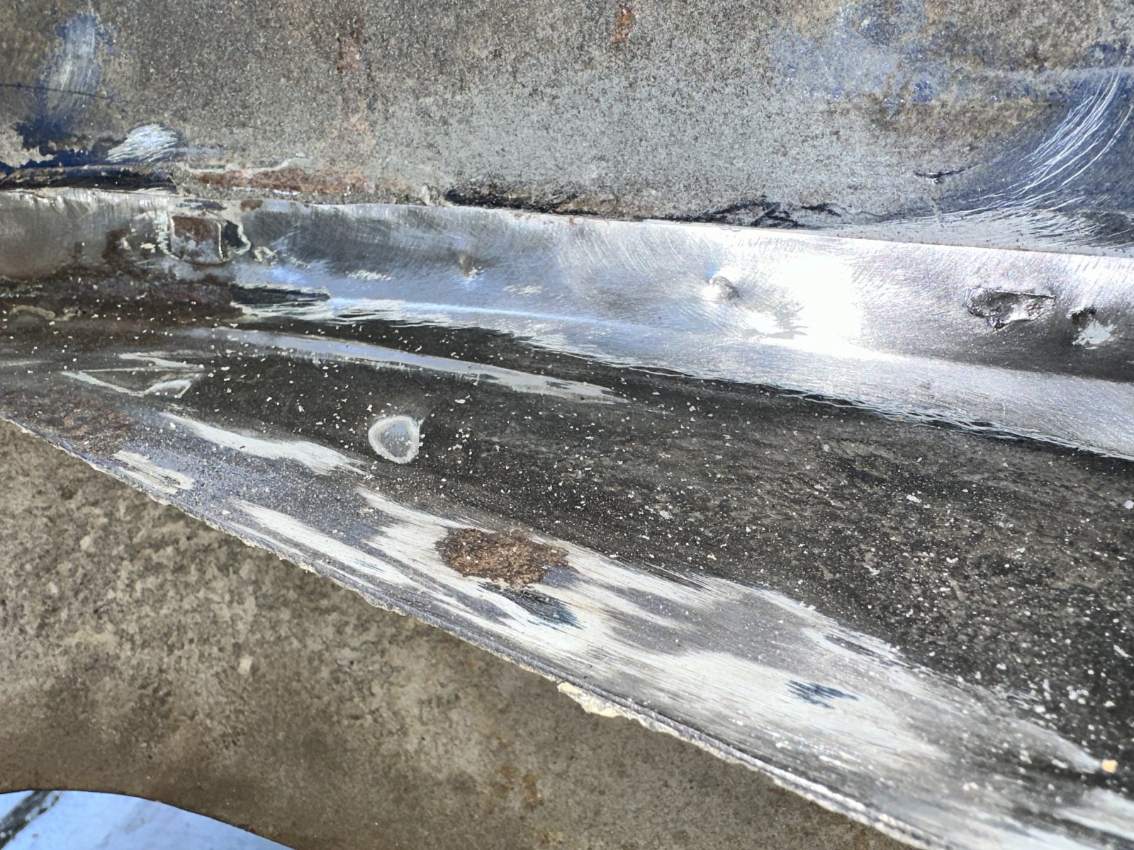

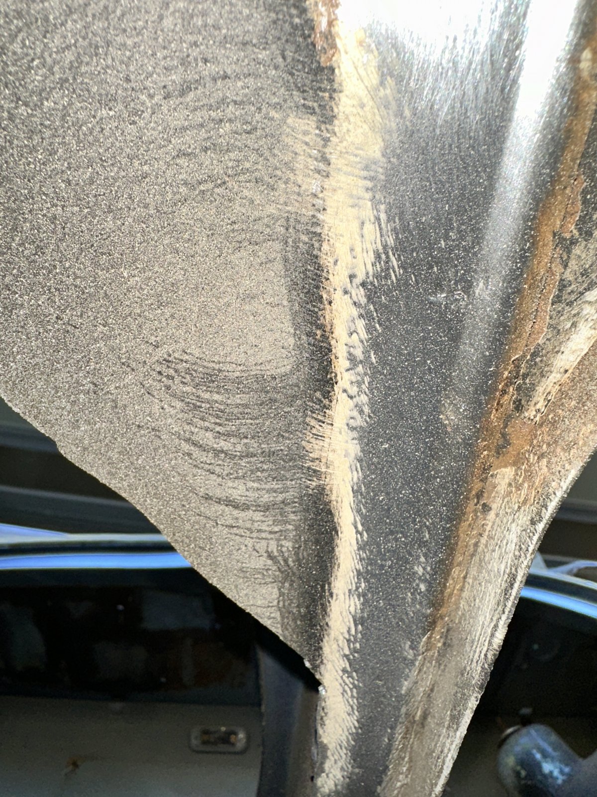

I'm wondering how many of you have tackled this, I waited to summers end now Its my turn to: I found that spare well it tacked to underbody tie down, which looks needing cutting off, trying to figure out how to get the final spot weld behind the. arch which comes down almost touching but not. bunches of weld underneath along fuel tank support--guessing now why they sell all these pieces, while I'm finding they are similar they are not guessing this formulation came from way later car--perhaps 2.5 euro version. here are some pics of where I'm at and all should be out by the weekend.............maybe. anyone with advise please speak up- also I thought a guy from the Netherlands spoke about where to find similar seam sealer. all heads up appreciated.

I am not sure what you're question exactly is, but the spare tire wheel well is spotwelded to the sides.
Then it also has strip welds to the rear wheel arch, these welds are located inside the boot, and placed horizontally.
US versions have these extra beams running to the rear of the car, and you seem to have them as well. I think (never seen them in person) these are spotwelded to the spare tire tube as well.
The tie-down loops, on either side of the rear axle, are welded with strip welds as well. There is often some rust behind these things. They serve no real purpose anymore, they were meant for tie down during transport in the 70's. Nowadays a car would be held by it's tires, rims or suspension parts when transported.
In a non-concourse restoration, one could simply leave em out.
Does this answer your question?

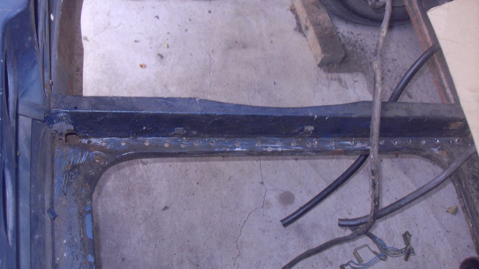

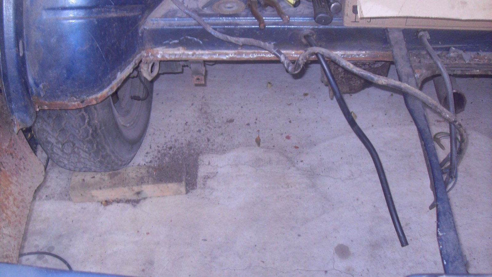

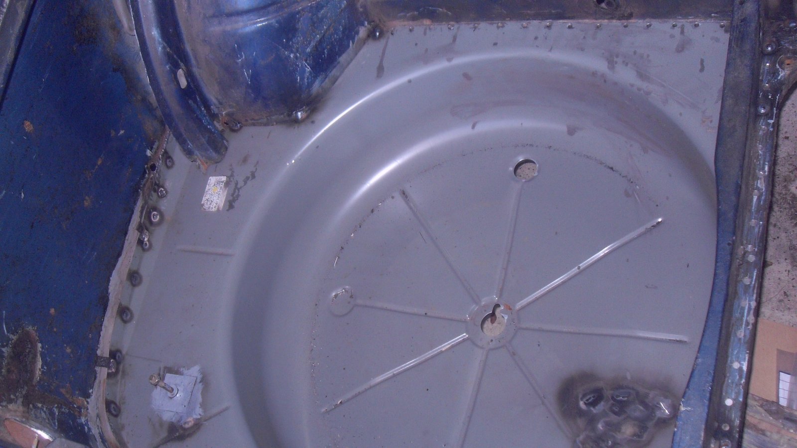

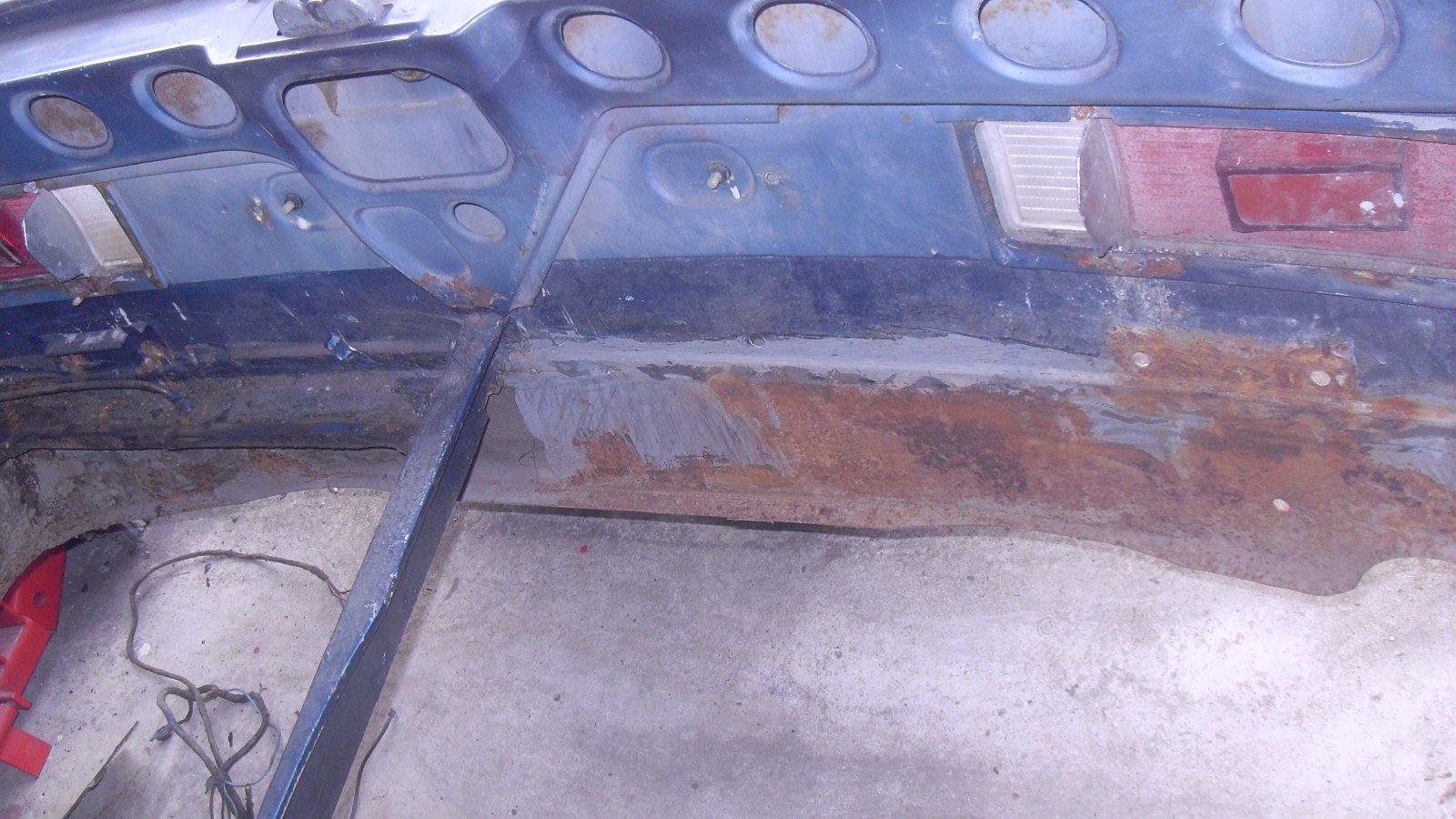

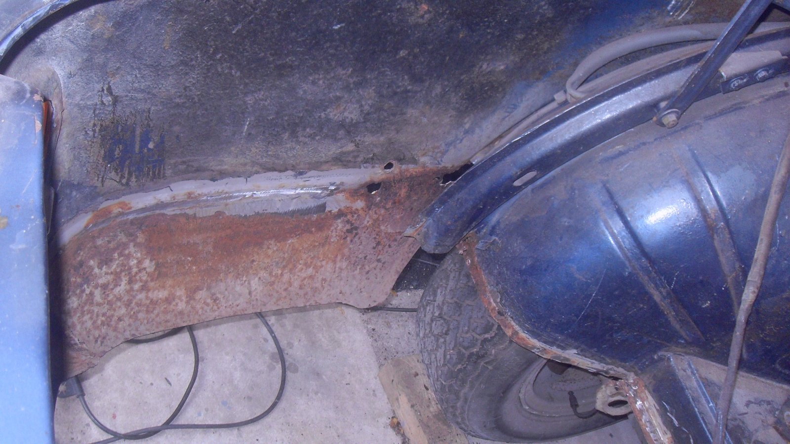

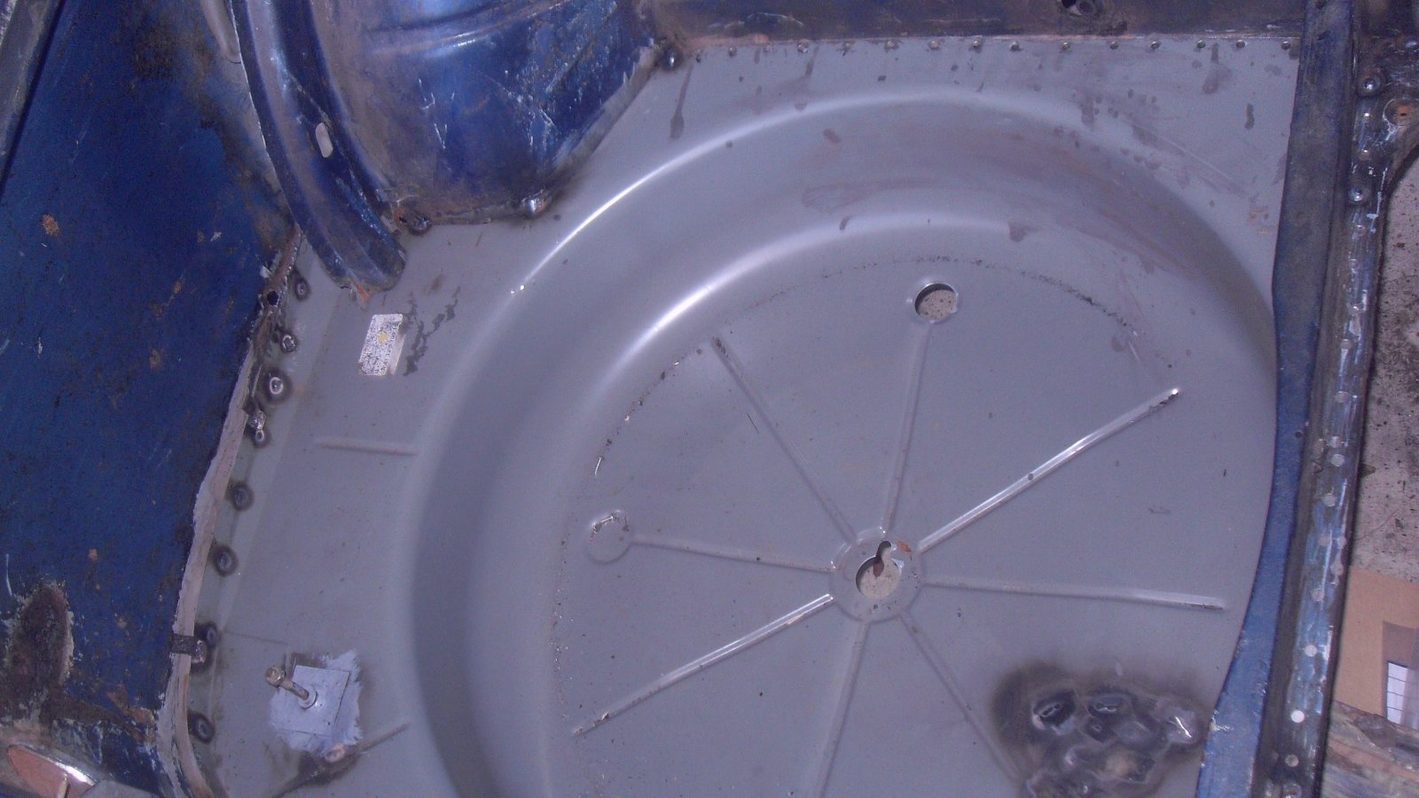

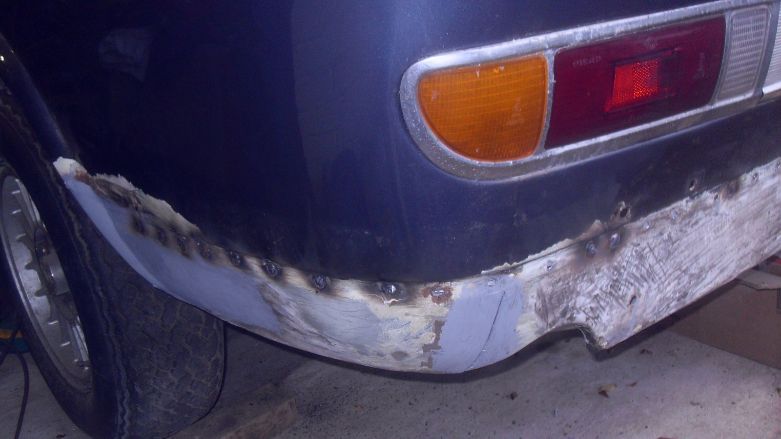

Here are a few photos of the work I did on that area on my own coupe.
I didn't have to cut off the tie down - I think it may have been welded to the floor underneath, but must have managed to get out all the fragments of the old floor somehow. The bumper support bracket needed to come out. I saved the various mounting brackets for the spare wheel, jack etc. from the old panel and transferred these over.
I had no need to remove the right hand side of the floor/tank support so left that in. It did make getting the floor panel in tricky - I seem to recall it needed a little delicate trimming to enable it to be tucked under the various sheet metal sections where it meets the central support rail.
I don't have a spot welder, so plug welded the joints and ground flat. It was easier welding in some areas from the outside
It's a worthwhile job though, as one large piece fixes a big chunk of the car!
Thanks everyone- all in all not that bad - mine was welded at left wheel housing random spots right front under fuel tank support made no sense- now the hard part begins…..wondering if I need to mod fuel support and jack storage as they are different

I have the same with the marked spots, seams like a late 74 version.
I just hammer that areas flat.
Need to cut and weld, but than it's similar to your old spare well.
Breiti
View attachment 189628View attachment 189629
