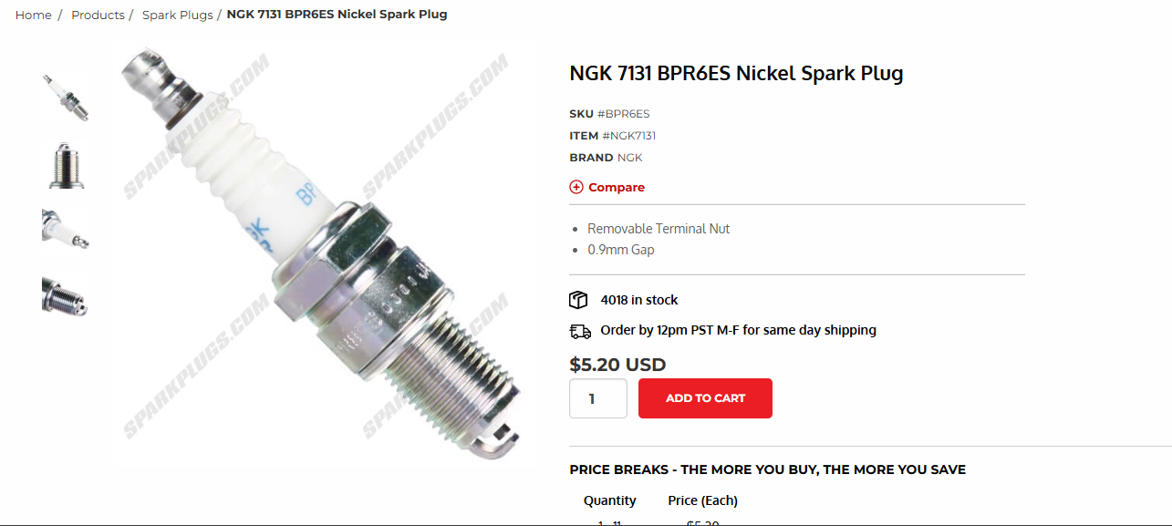

The one you want is NGK# 7333 with "Terminal Type: Removable nut" vs. #7334 which is a "solid nut"
See 7333 specs here:
http://www.ngk.com/product.aspx?zpid=9405
and 7334, here:
http://www.ngk.com/product.aspx?zpid=9406
I have been using NGK BR and BP plugs in my English cars for 30 plus years and each require removing the nut. I have never had a plug where the nut couldn't be easily removed as the NGK website states.
Cross threaded at the factory? Send them back or just buy new locally. They aren't that expensive. All major parts chains can order and usually have the plugs in a day.
And....this type of plug connection is the best IMO.
