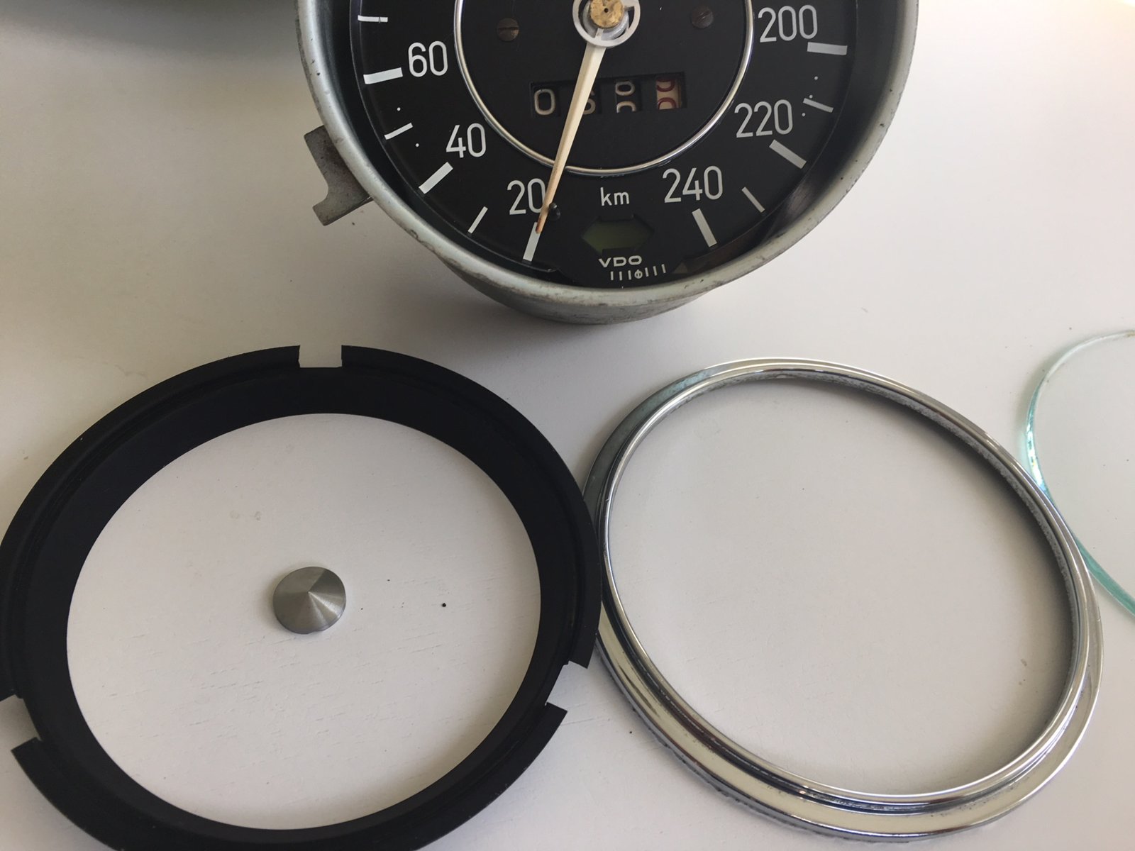

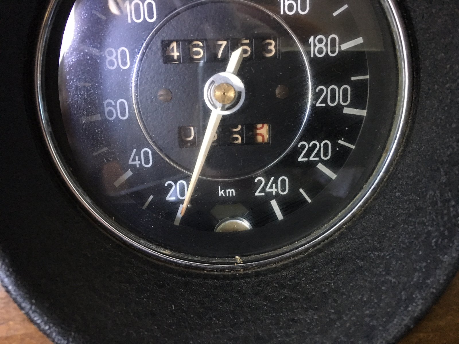

Looks like I will be learning how to remove my Speedo gauge today. The center cap fell off the needle. Does anyone know if it just snaps back on or do I need to glue it?

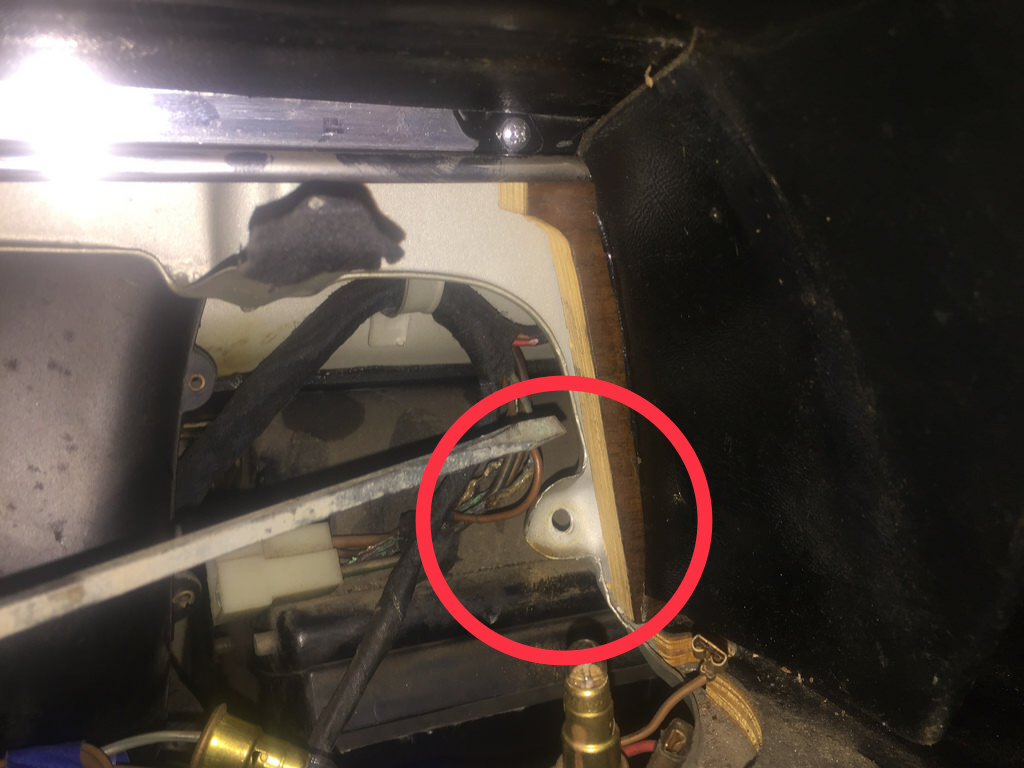

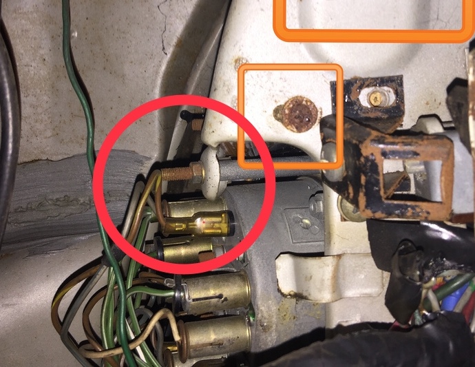

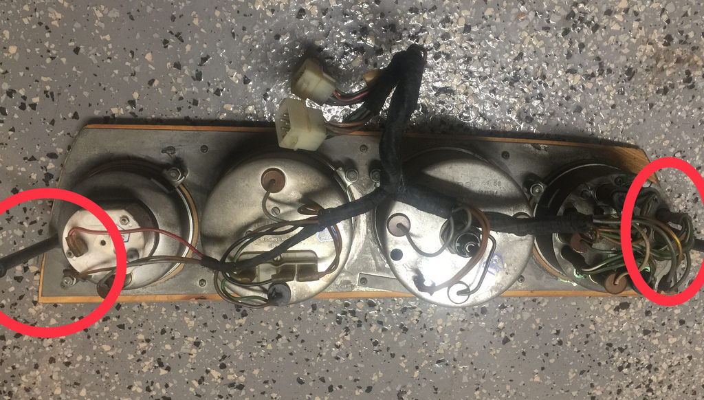

There are two 8mm nuts that hold the cluster wood in place. One on each end. You can remove them all the way and push the cluster forward or loosen them enough for the speedo to clear.
Passenger side body mount:
Cluster - see the threaded posts
Driver’s side - ignore the orange highlighting

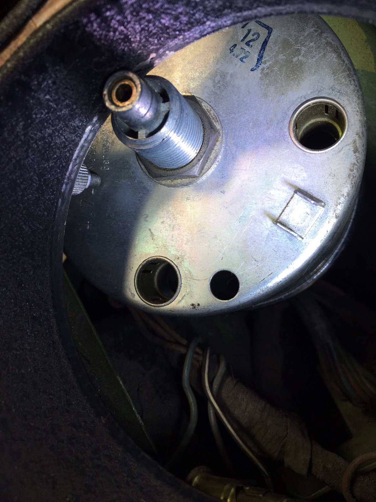

Thanks, I will try that tomorrow. I gave up and went inside to have a scotch (or two). I was about to loosen the back nut on the center of the gauge to push it in a bit but was unsure if that would disturb anything inside.

The speedo needs to be flipped 180 degrees then it and be finessed down through the metal dash support pieces and out. Reguires a mixture of patience and blind zen but it can be done.
Speedo is out! I ended up loosening the center nut on the back and pushing the face dial into the housing about 1/8” and then was able to instantly slide it over without any more drama.

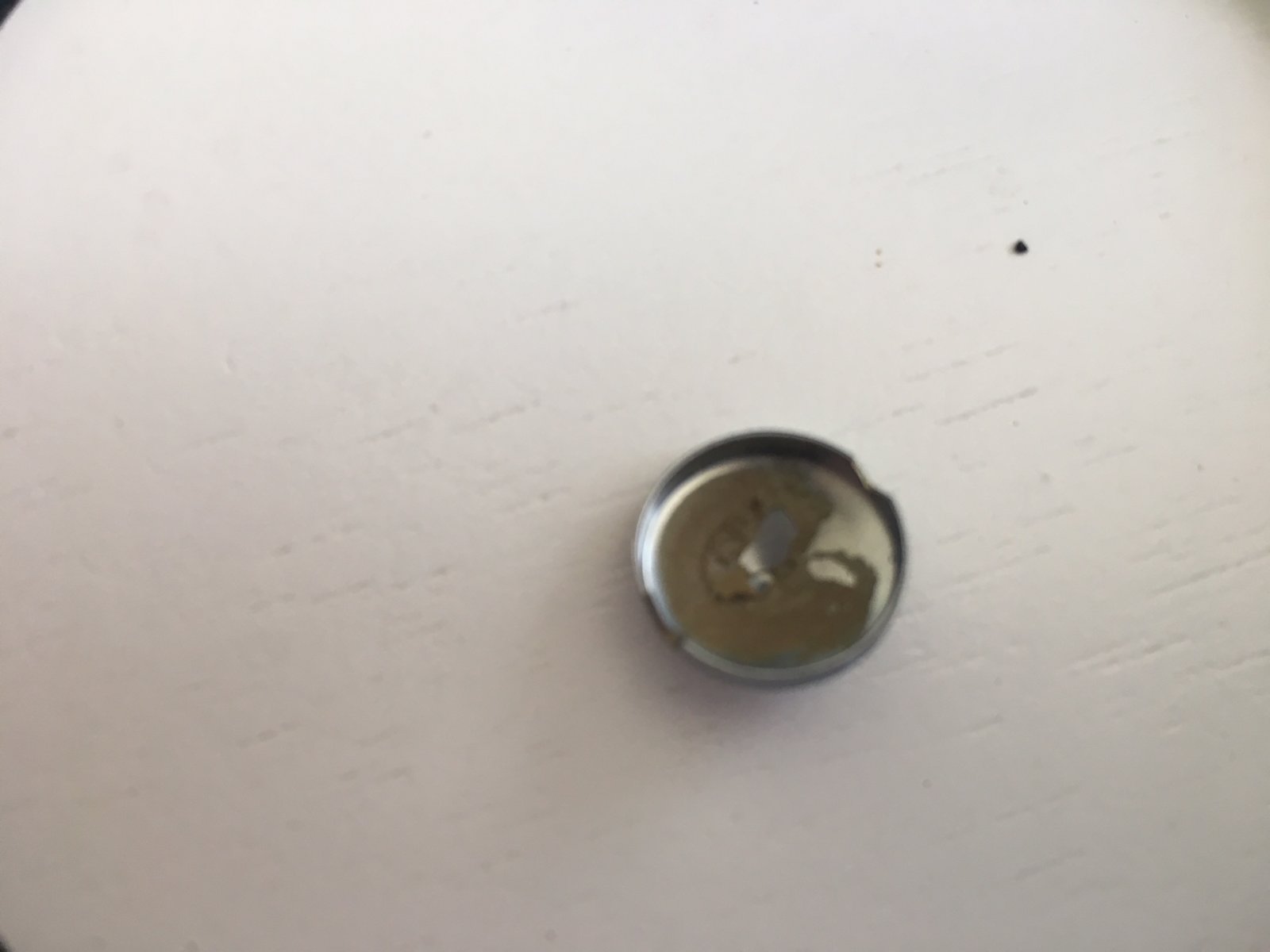

The center cap was just glued onto the needle. Still not sure what I will use to glue it back on.
