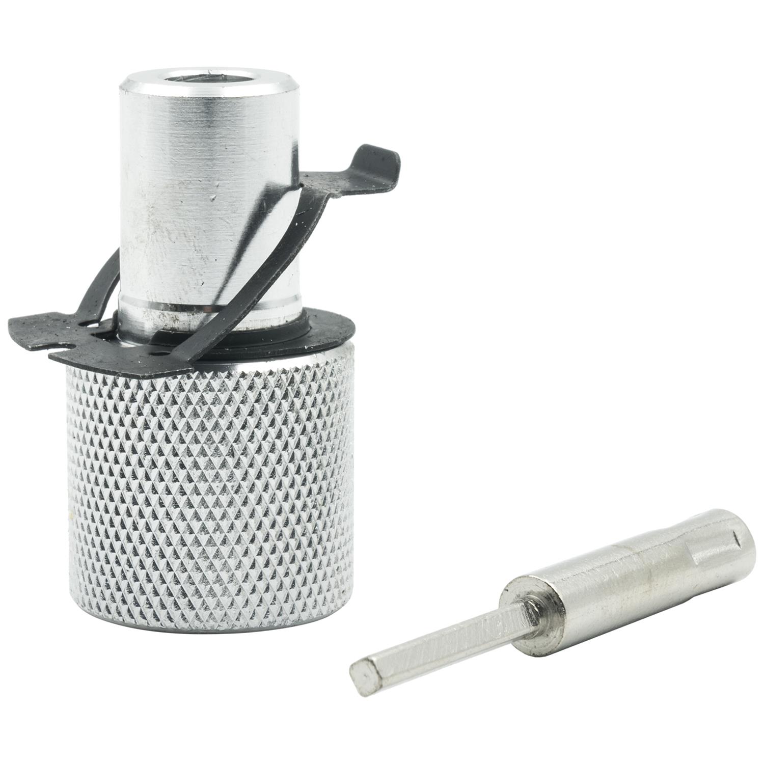

Last time I looked at an E9 speedometer cable it had a squared terminus. Haven't examined the receiving end for quite some time, but I recall that it has a rounded and wider mouth than the cable. The pictures bear this out. Despite appearances, in my experience, it accepts and is driven by a square shaped cable end.
Adapters obviously exist, but I am unfamiliar with a need for them - unless you are using custom/non-stock setup. http://www.summitracing.com/search/part-type/speedometer-cable-adapters It is possible that the cable was previously removed, replaced or repaired with a "universal" cable that may have had a crimped terminus or "adapter." If the crimp became detached, some confusion might be understandable. Note non-stock examples below, essentially square - but not completely.
