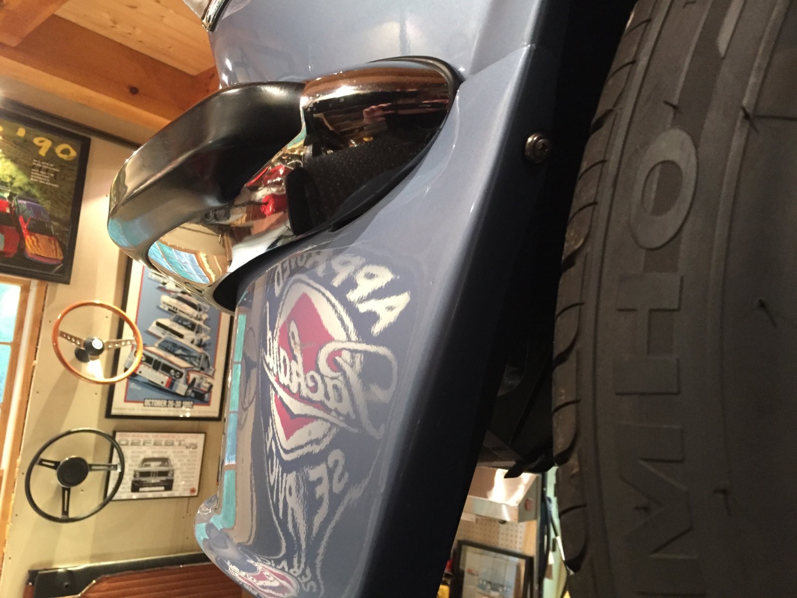

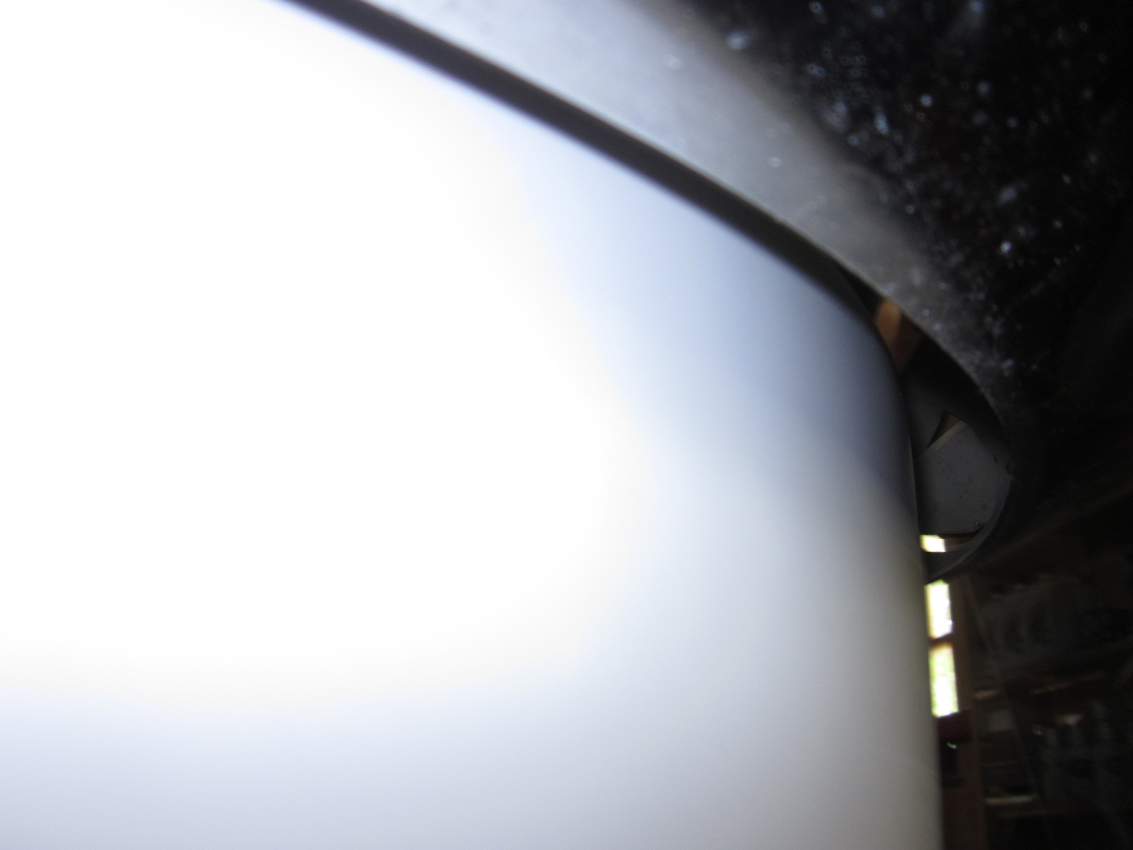

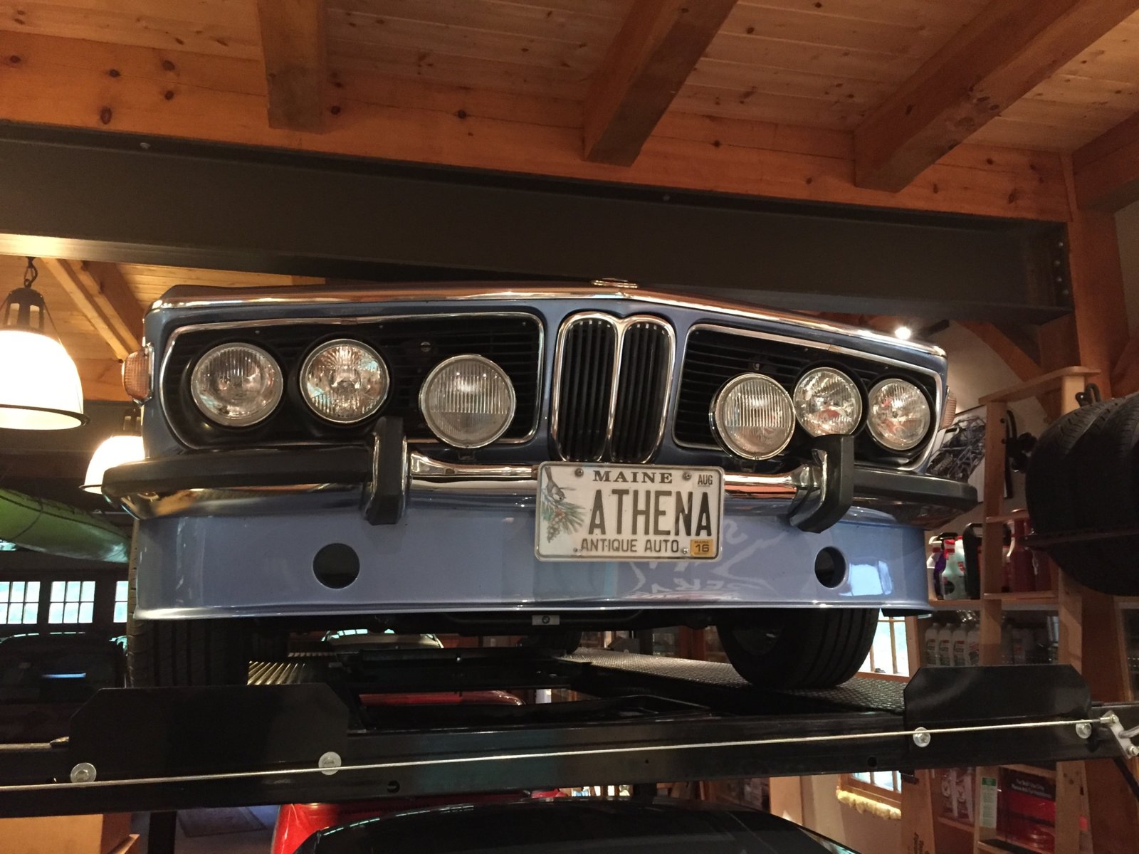

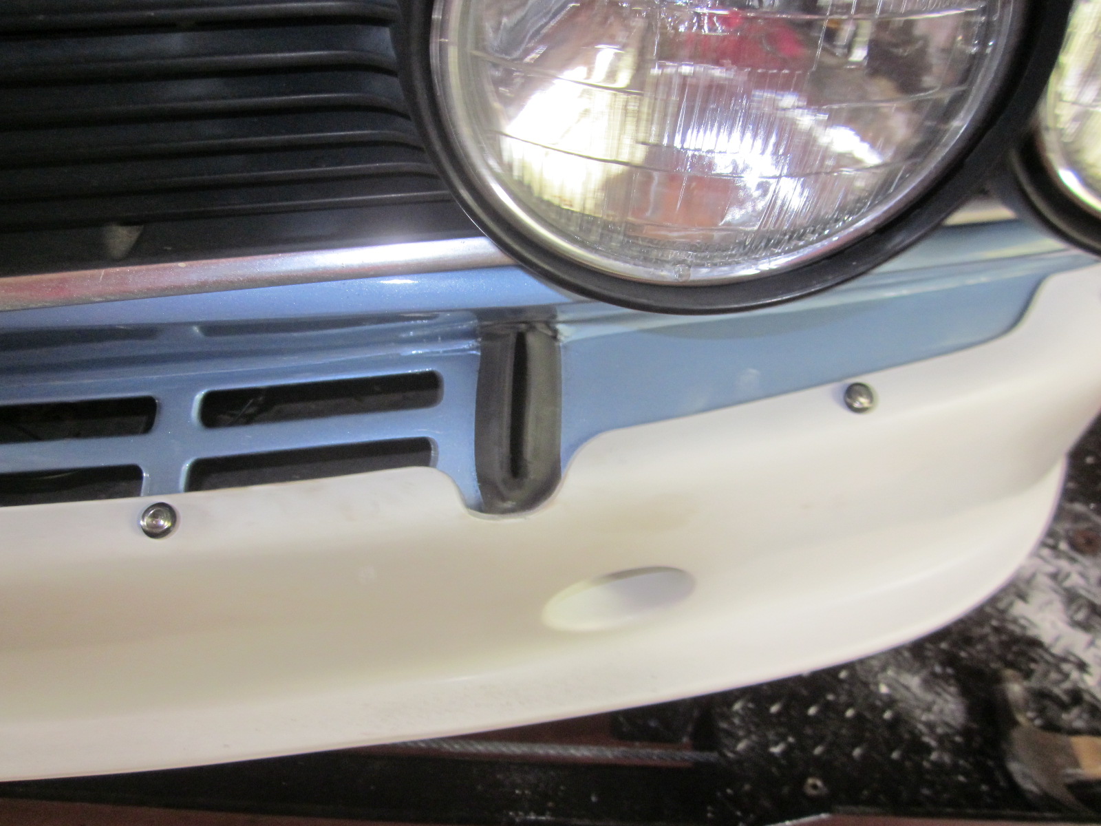

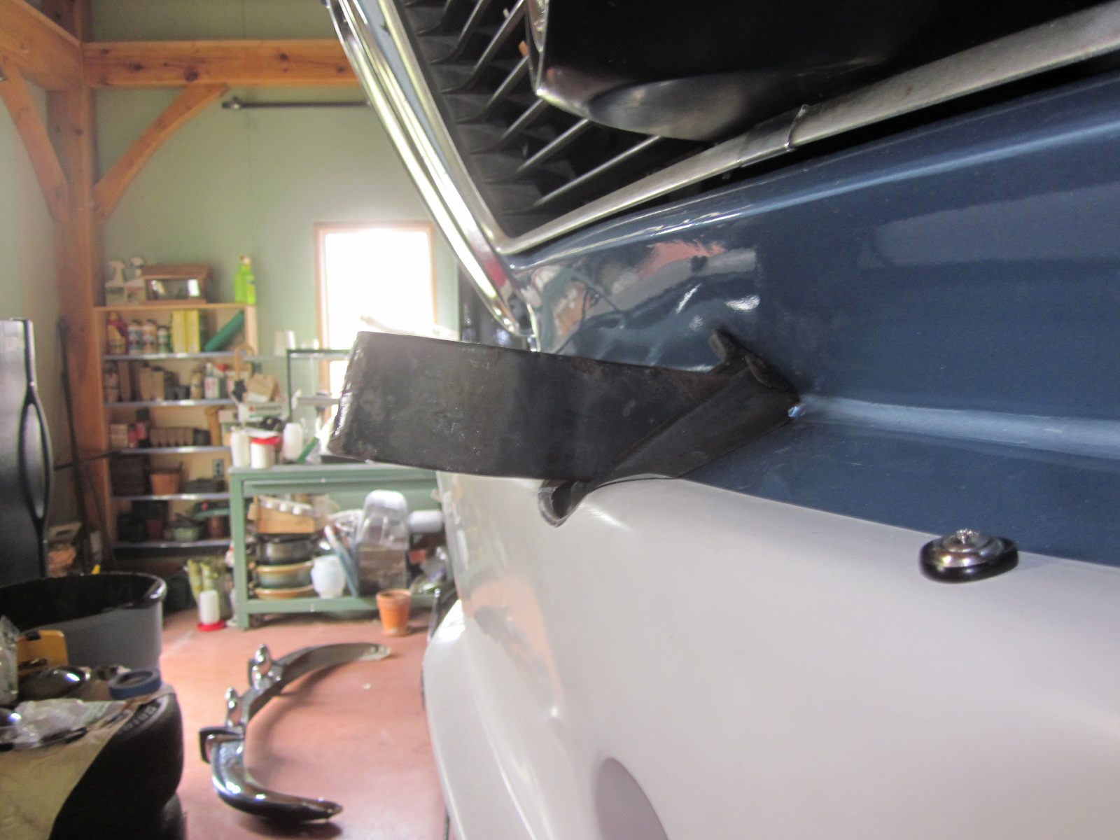

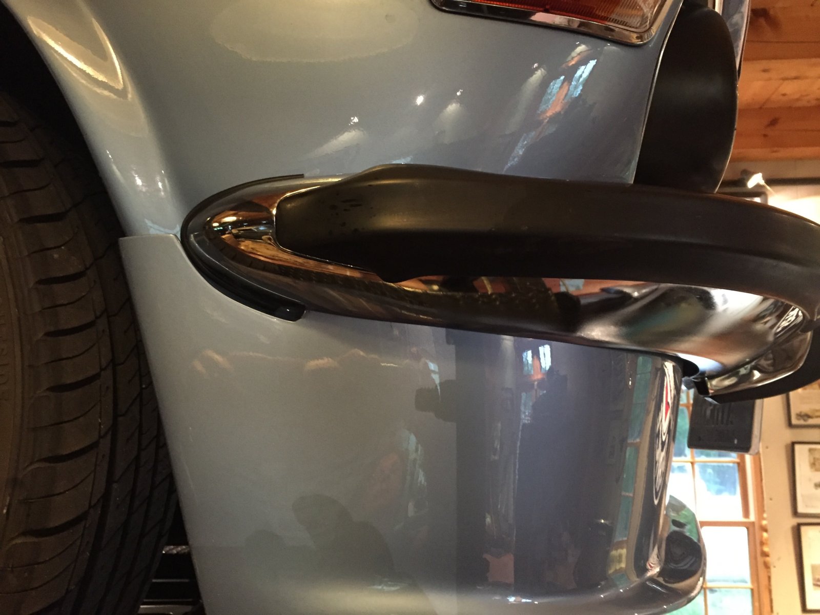

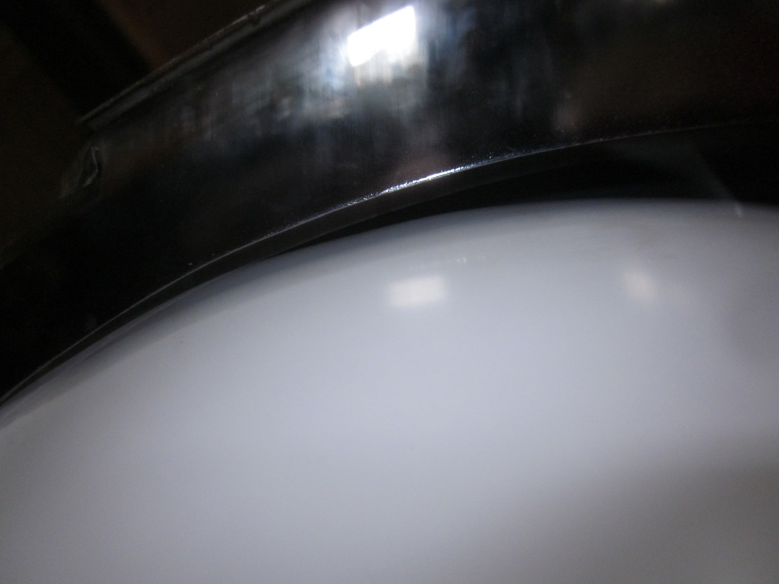

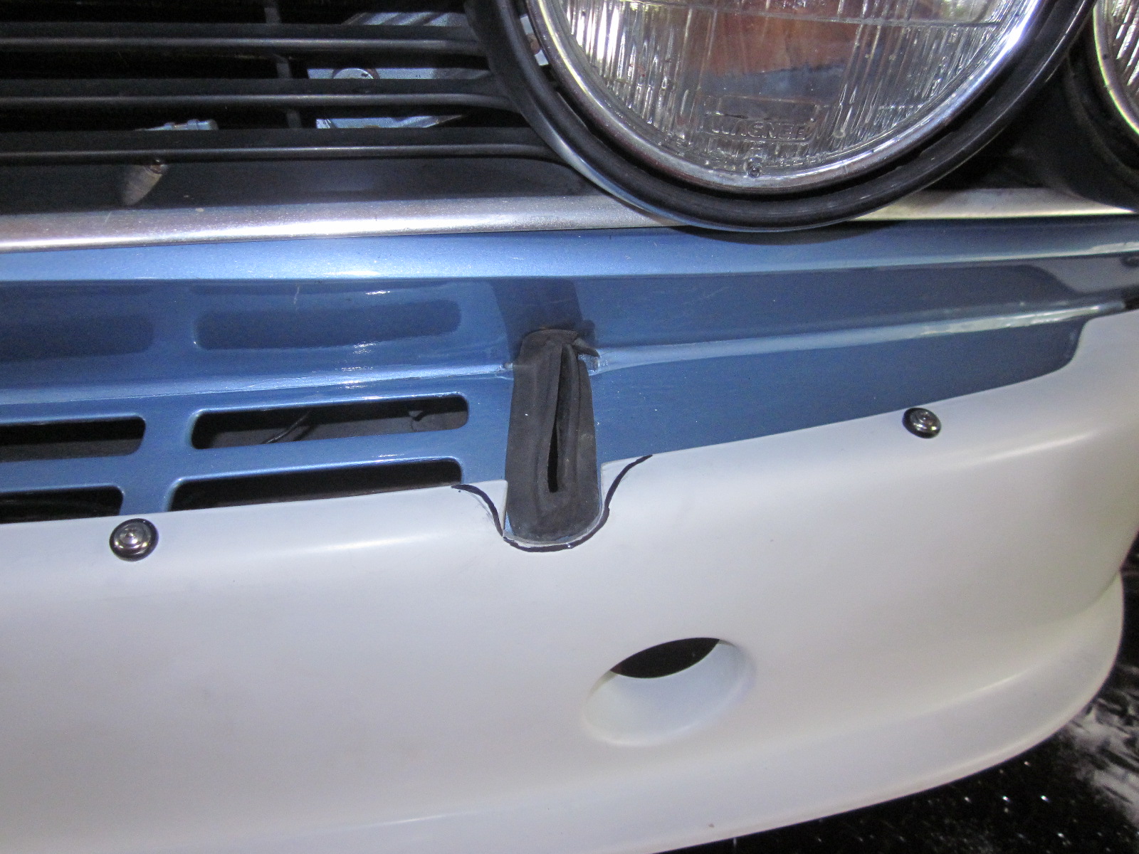

My spoiler (from VSR1) fits fine with pre-73 bumpers but the clearance is indeed small (about 1/4” at the tightest — center area). I think this is the tightest configuration.
Your air dam has to be cut around the bumper bracket rubber gaskets. Scribing the sides is a 2-3 person job to get it correct. The bumper tolerances are very tight fit.
Nicely detailed pics, Andrew. Tells the story well.
I assume that you had to do the same pattern work at the black "gasket" (just in front of the tire) where it meets the quarter...
