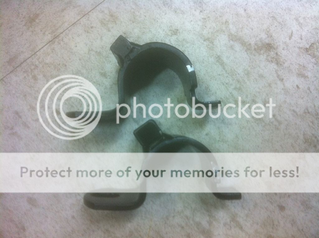

So this set of ST swaybars came with the car. But upon trying to install the front one, there's a problem. The supplied mounting brackets for the front are too long to fit in the allotted space, and the tabs are too narrow for the slots they go in. I notice the instructions list this bar as fitting E3, E12, and early E24, but not E9. Is there a difference? The bar itself seems to fit fine. A photo of an OEM mount looks like it has neither of these problems of course, but I'm not sure if OEM brackets will fit over the ST bushings. Are they larger overall? This new bar is 28.5mm. Unfortunately I don't have the original brackets in hand to compare, but I may be able to find them among all the parts and answer my own question.
The length issue: I could cut them off easily, but I'd have to slot out the holes, and that still leaves the tab issue.

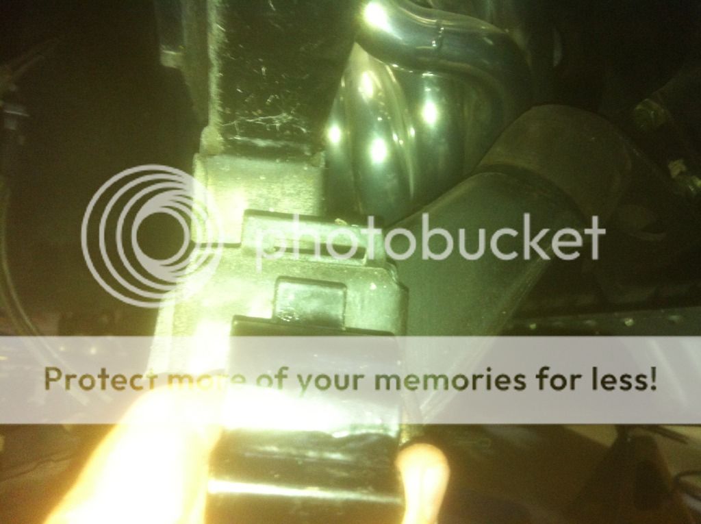

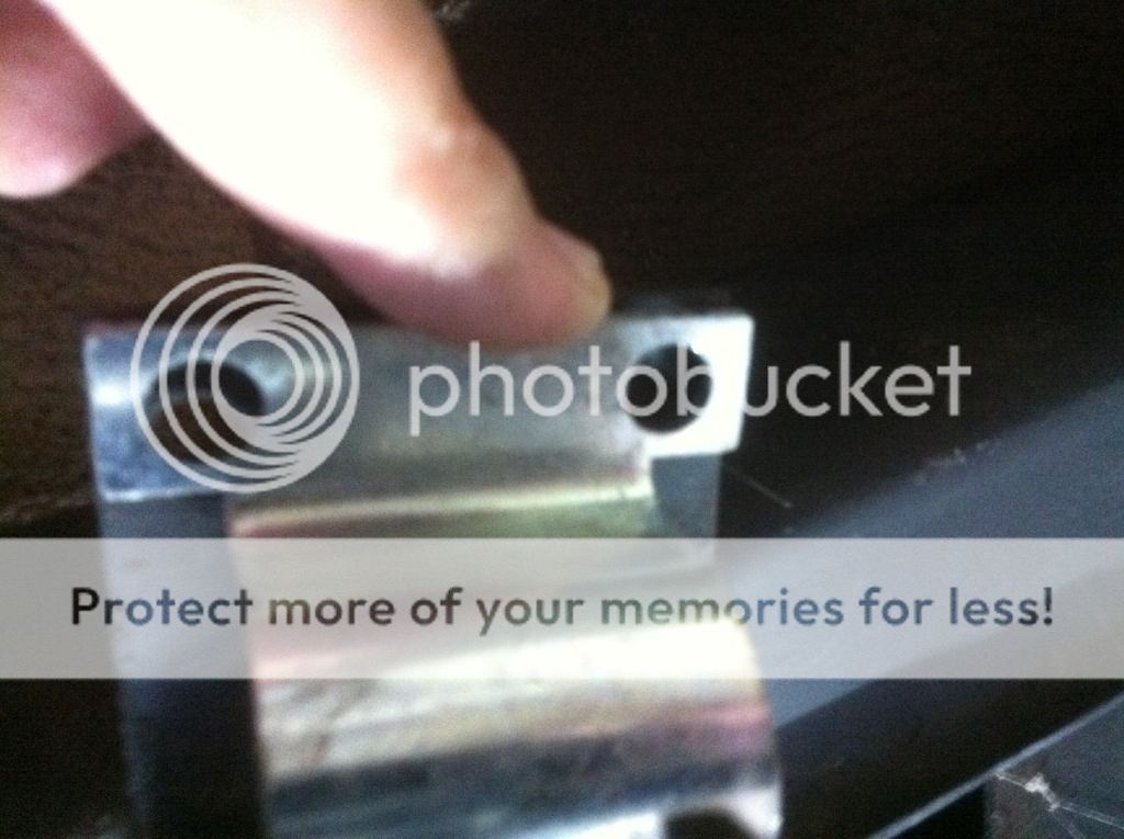

Here's the tab compared to the slot. Probably not good for strength if the tab is so much narrower.
I have no idea what the bars on top of the brackets are supposed to do. Can't see any purpose for them. Strangely, one is solid and one is hollow.

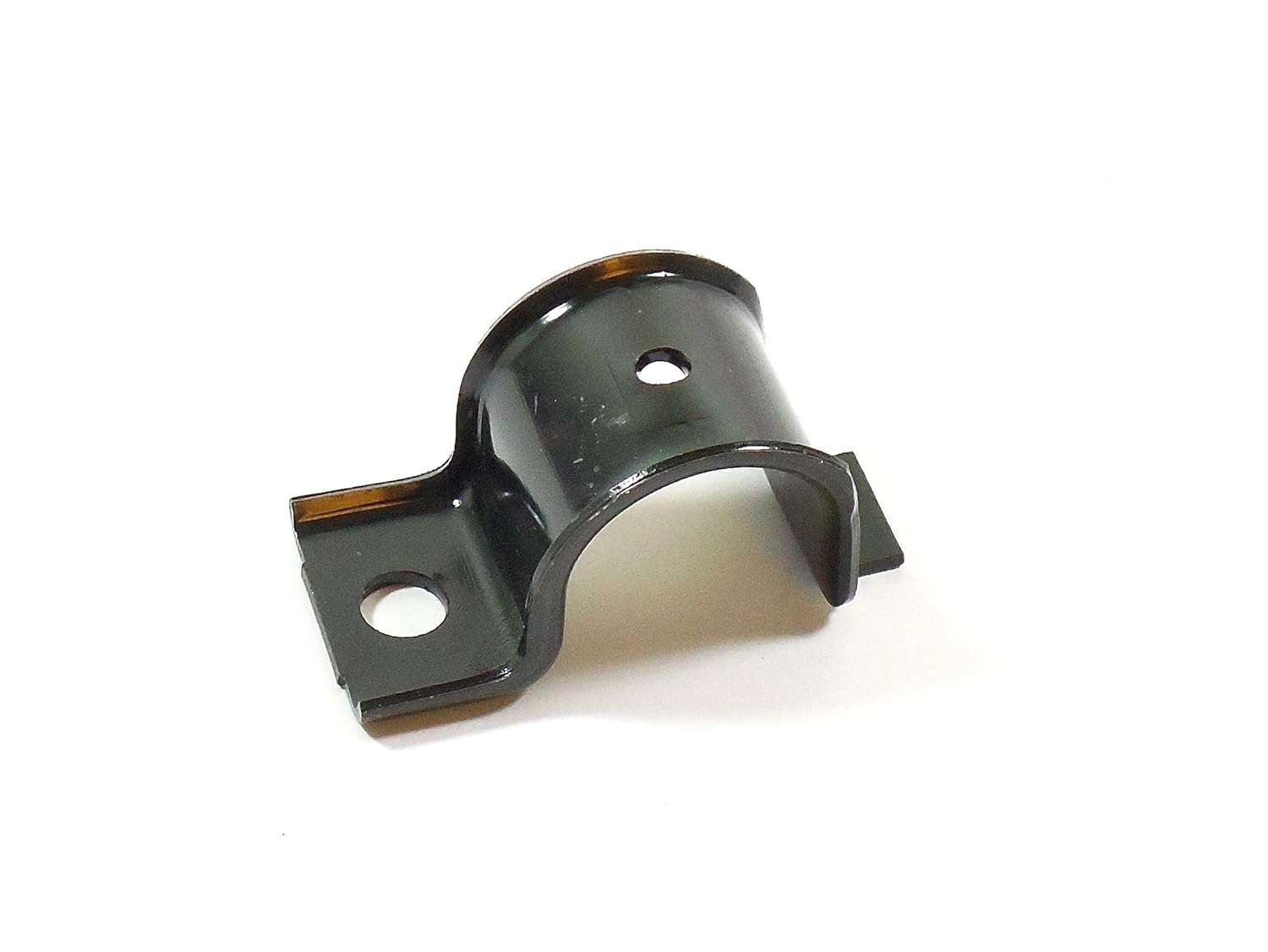

And a stock one for comparison. Seems to have a shorter length and a wider tab, but does it fit over the ST bushing?

wait a second, they will fit into the available space, but you can not place them like that !
first, do not cut them or they will be useless
then, you can not introduce it laterally but tilting it, first introduce the tab frontally,( from behind), and then tilt it down, it will fit
second, there is absolutely no problem with that tab (narrower than the hole), forces do not compromise thedifferent in size between hole and tab

Not the case unfortunately, they would not fit. I have no idea how long these swaybars have been sitting around, it's likely ST has improved the design since these were made. Once I cut off the useless bars on top of the brackets that prevented any attempt at installation, and shortened the overall length to fit in the allotted space, the bolt hole was still 1/8 inch away from lining up. Definitely not a matter of forcing it into place. So I'll slot the hole and weld a washer on top to strengthen the area. I have a new welder arriving tomorrow, so I set this project aside for now.
I found the original bar bushings, and was able to answer that question: The ST brackets and bushings are bigger. You could not put an original bracket over an ST bushing. Somewhat obvious I guess, if you could, they would not send new brackets with the kit. The original bushings were 30mm thick, and the ST are 35mm.
