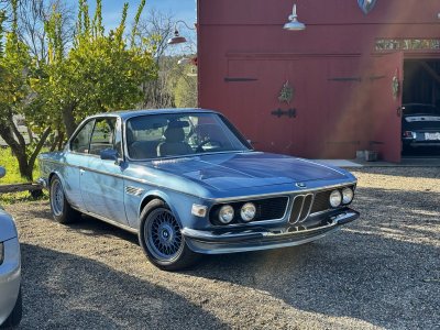

I originally had a square set-up on my E9 (with 16 reproduction Alpina wheels). Then I sent it down to Alameda to have Don work on it. He offered me a set of better quality rep-Alpina's (still 16", but staggered) that were coming off a customer's car (to be replaced with real Alpina's - I think).
I took him up on his offer. Came with nice tires as well. Don's set up is on the car now.
I do not notice any difference in how the car drives (as such). But while the wheels themselves look better, being larger in the rear does look (at the overall car level) much improved compared to what I had earlier.
If he had not offered these new wheels to me, I would have been happy to keep what I had.
Gratuitous shot with Don's wheels below....
FYI - The location below where I took this picture a while back was just recently under about 4' of water (in case you have been hearing about the weather up near Seattle recently).

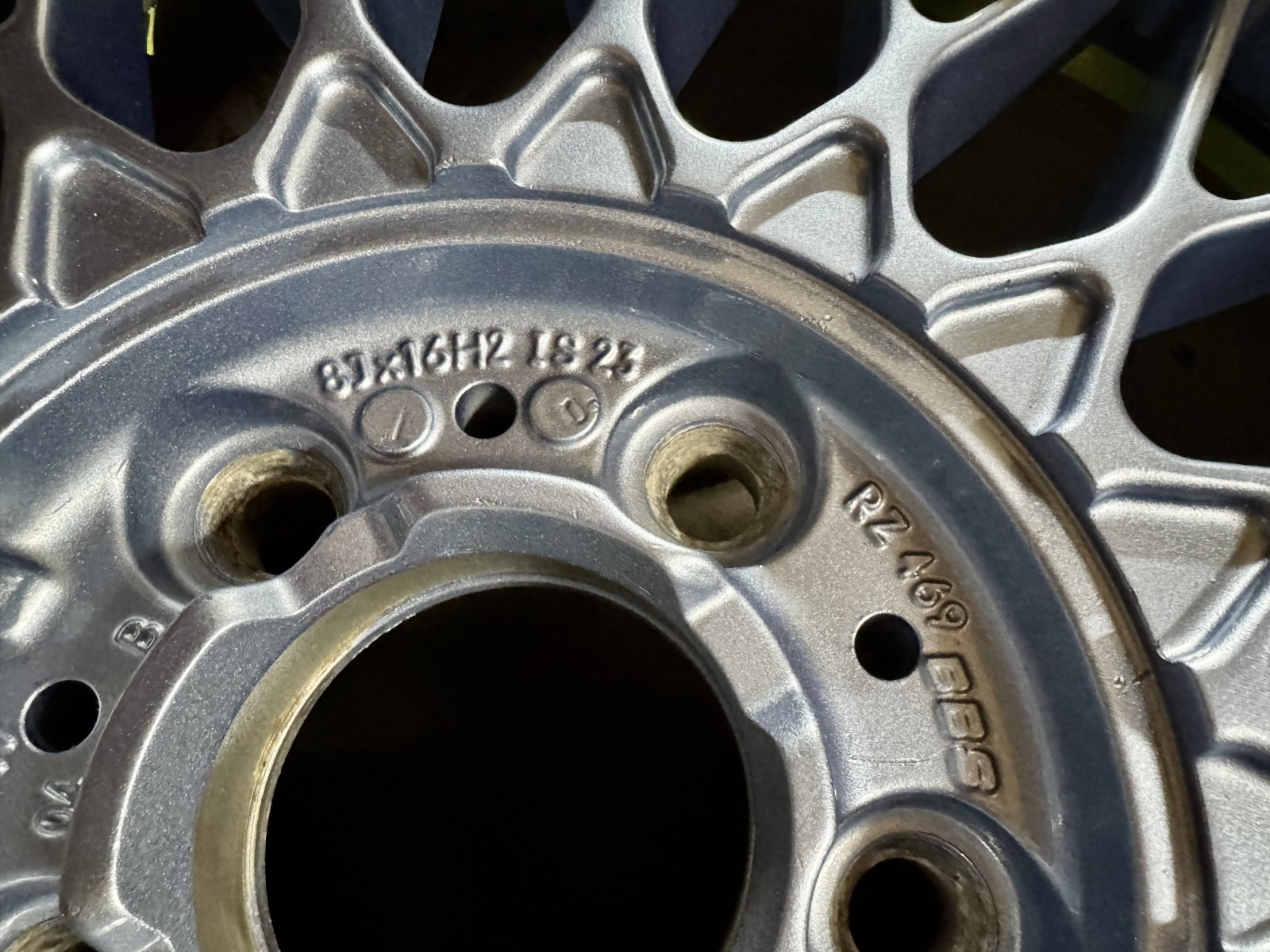

Quick question, what ET are you running on your wheels? I like the idea of 225 all around, I thought 205 was the limit up front. I saw you mentioned the spacers and studs.
I'm used to square setups on all my cars, it also makes tire rotations easier.
ET is 23. Depending on the tire profile, I had to use either a 5mm (Michelin 225) or a 10mm (Dunlop 215) spacer. With the 10mm I decided to use longer studs because it was getting a little tight. I have rolled fenders and no rubbing issues

Based on the dimensions, does that mean the forged E38 Style 4s would work? They are also 16x8 ET23. Part Number: 36111181841.
