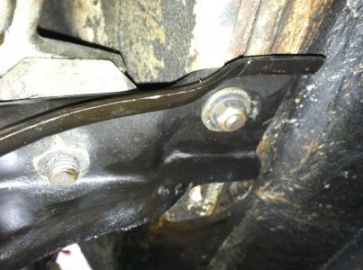

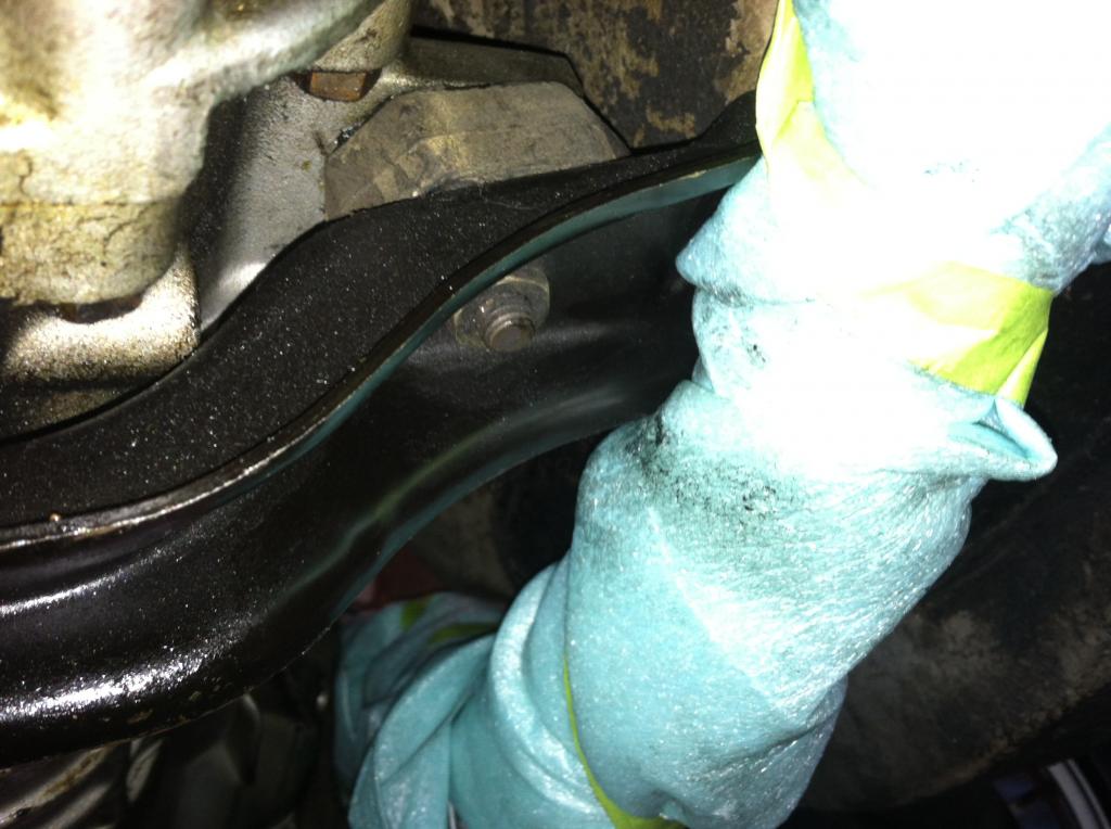

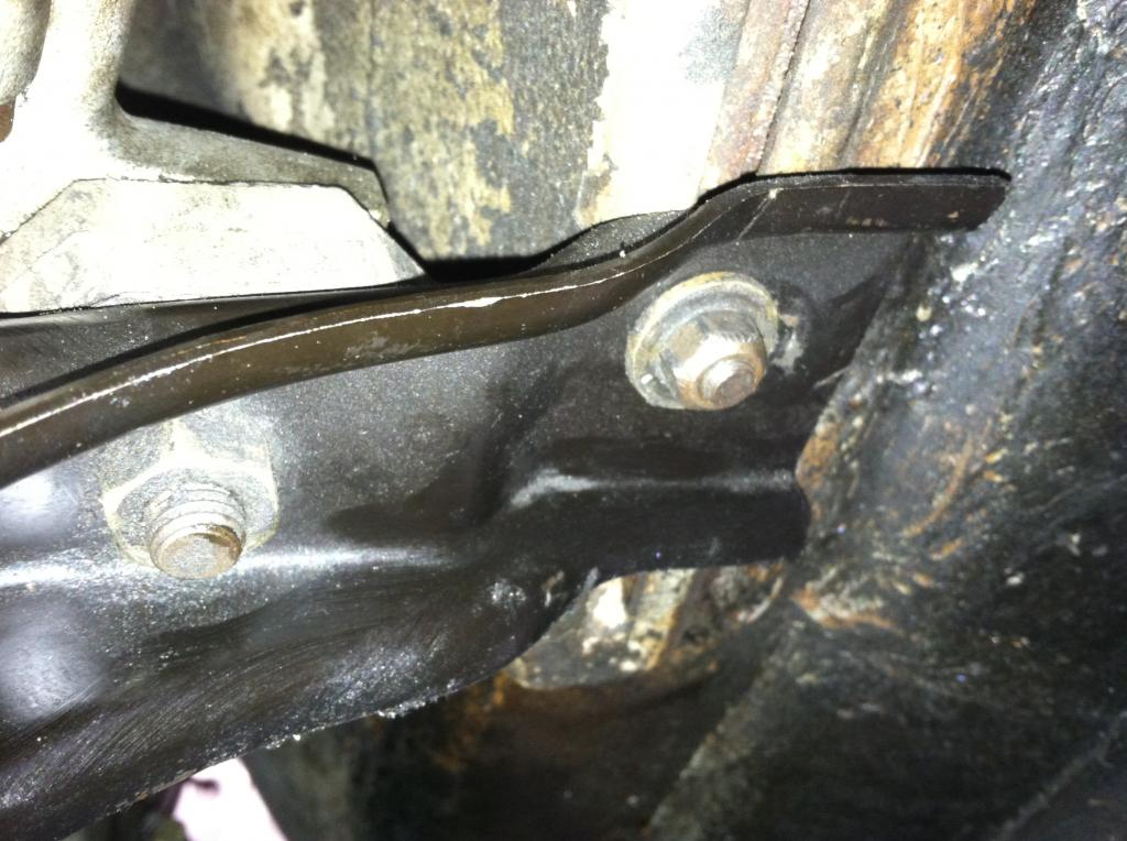

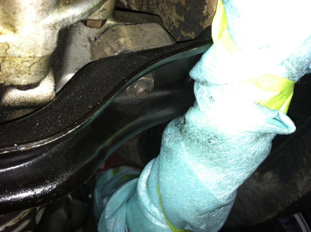

On mine, it's hitting the transmission carrier (5sp)--passenger side. I was using the original e9 carrier, but I just switched to an e24 carrier which is supposed be thinner at the point where it is contacting the header. I have my doubts it will be enough to matter.
Photos of where mine are hitting
Right here, on the transmission carrier:
Well, that didnt work.
The e24 carrier is clearly a superior design, much stronger and a bit thinner. However the Stahl headers still wont clear. I put the OEM pipes back on.
Not sure what to do next with these....
Can't tell how close it is to fitting but if close part of the brace holding the transmission could be ground down or have a welder box the end right next to the nut. That would keep it strong.
Gary
Header performance is not degraded at all (or almost at all) by dimpling the header pipe to provide clearance past the trans support.
HTH
James
It's too close for grinding the brace or dimpling the header to be a good option. What's strange is that Ben over at LJI says their Stahl headers just bolt right in with no problem. It doesnt seem likely that my headers would be different so Im wondering if my motor isnt sitting correctly in the car.
It looks like your close to Ben.Maybe take your's over there to compare the bend?
