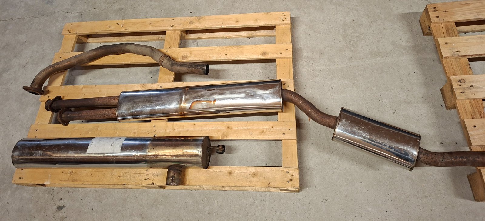

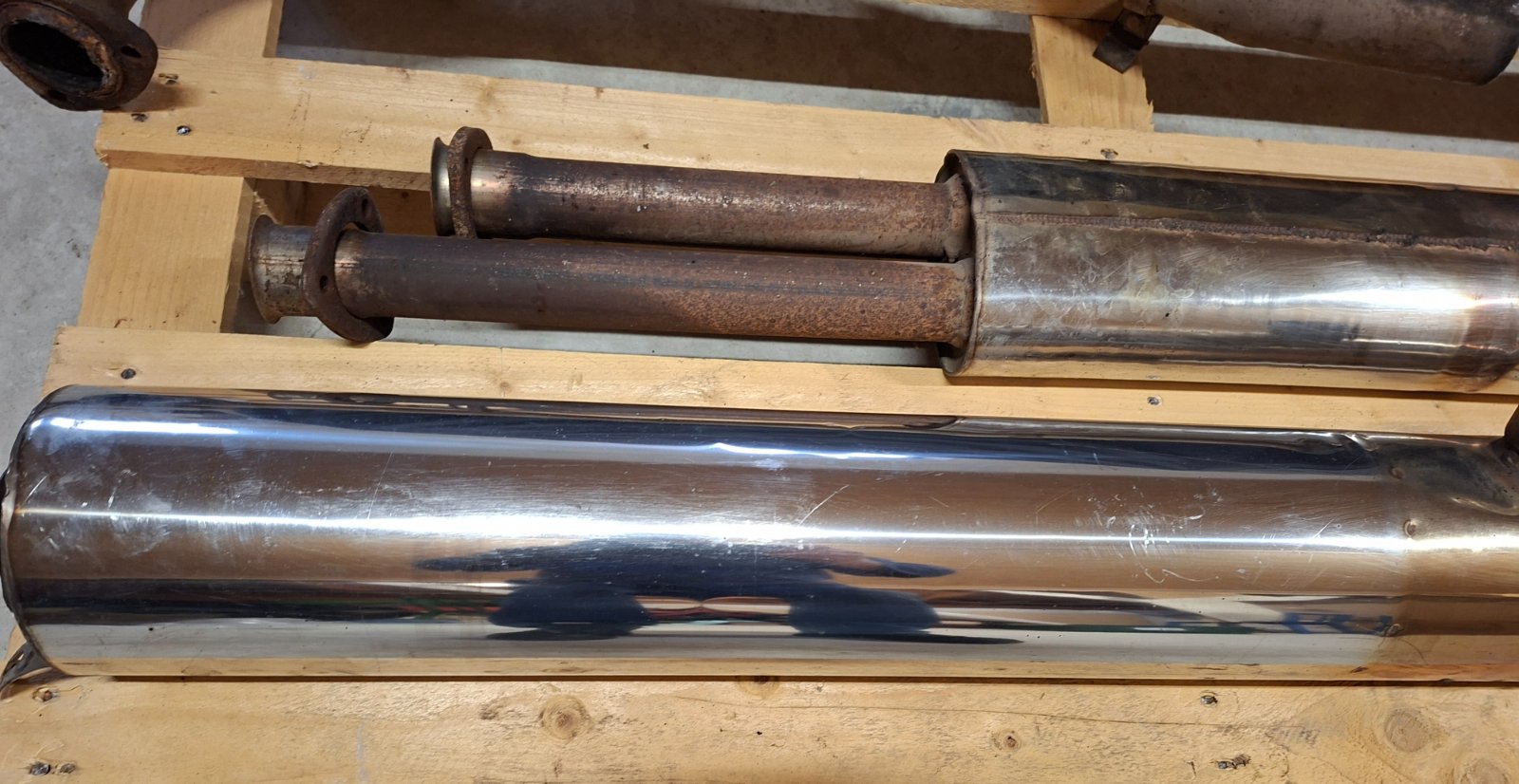

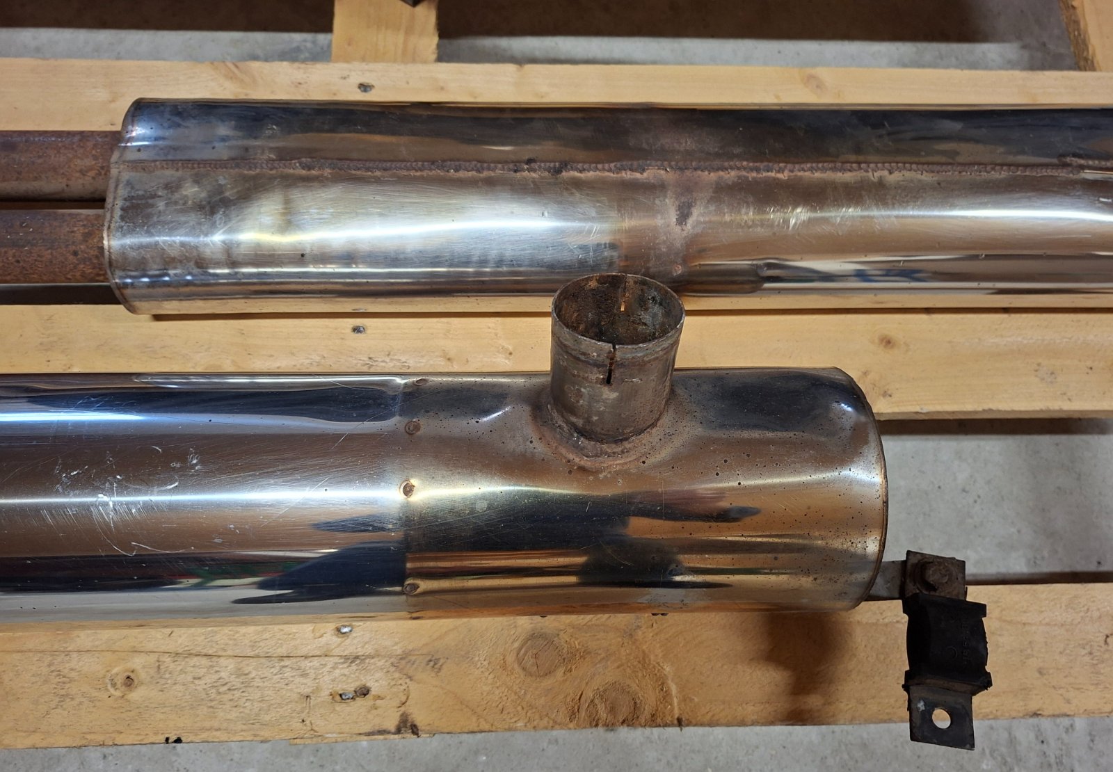

This one was installed on my RHD E9.
Made in UK. Does anyone recognise it?
It's on sale for 500€.

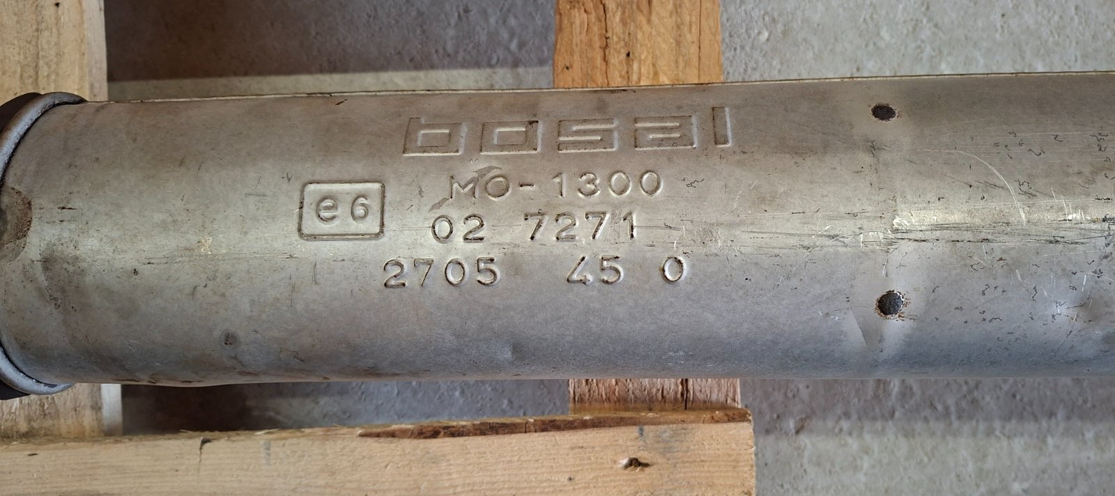

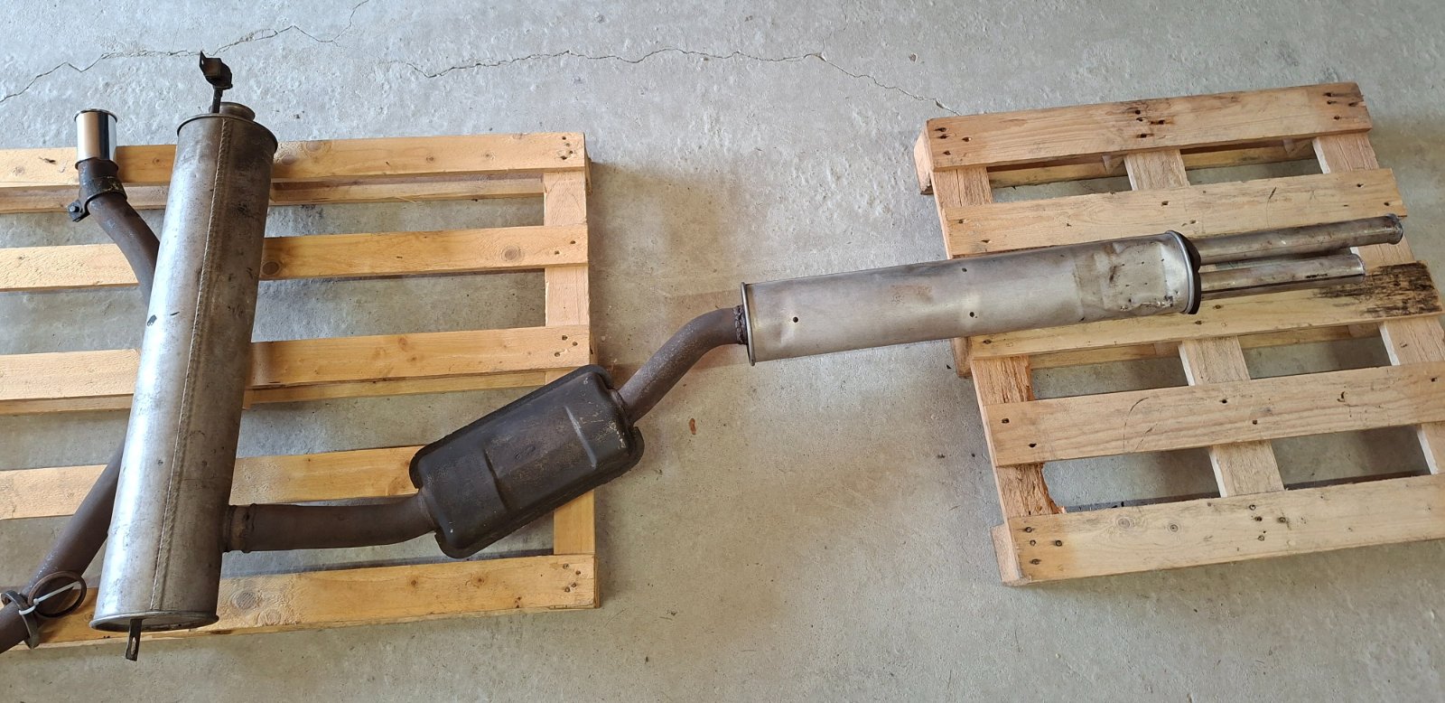

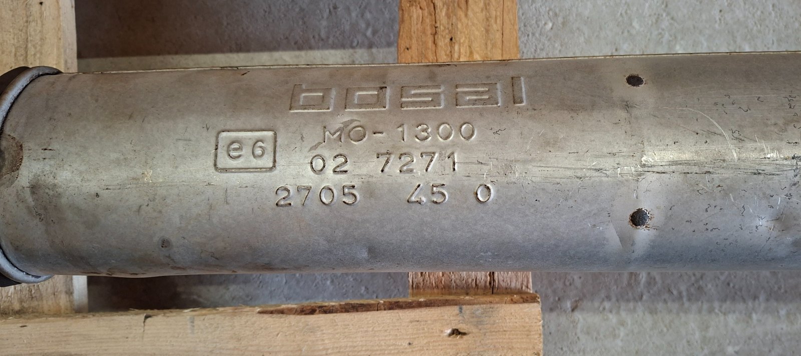

I prefer the original Eberspächer. The real sound!
Or Bosal.
This one is on sale for 700€.
Fear I cannot ship them.
Thomas
