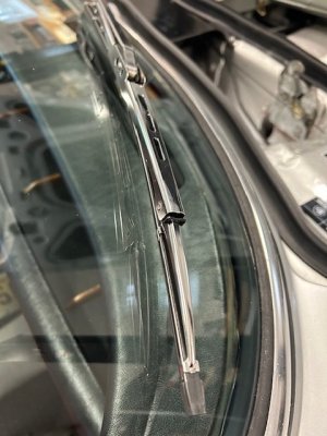

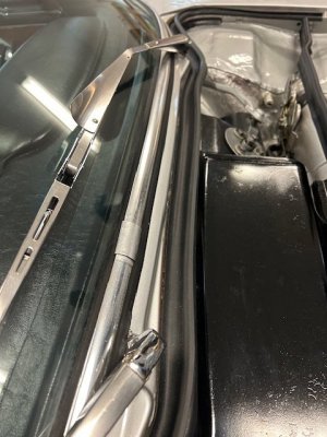

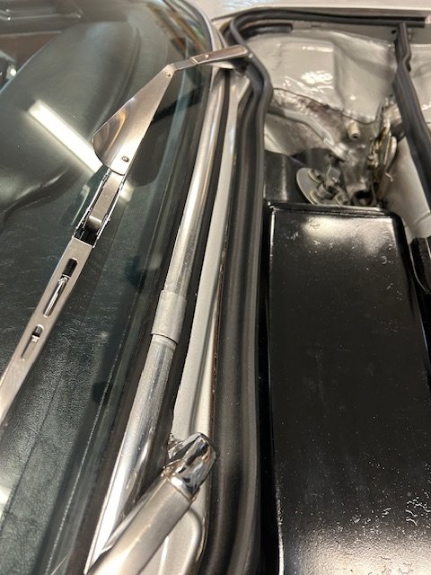

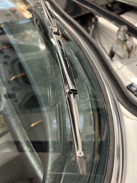

Just wanted to communicate that I found a set of beautiful SS wiper blades on Amazon that work great on my E9.
COST: $24 each, including shipping.
These will require a different mounting clip than the one that comes with the new blade. If you have these clips already on the old blades on the car, you can un-clip them from the old blades and transfer them to the new SS wipers, they will snap into place with a bit of determination. I was able to message/slide them into place and lock them on the wiper arm. My E9 has the u-shaped wiper arm blade ends on both the driver & passenger sides.
Here's how they look below in the photos. If you find that you need new mounting clips, (which I did not) you might find them too on Amazon. They require the rounded end clips so that the hook at the end of the arm can slide over them.
COST: $6.00
I am very pleased with the look and have now eliminated the black wiper blades from my 1971 E9....
