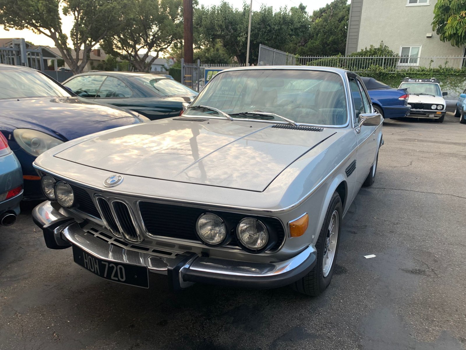

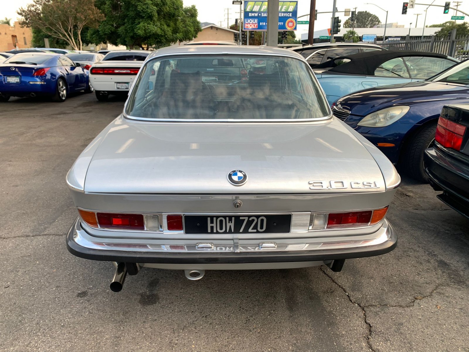

My friend just imported a CSi that is apparently going on BAT.
He has an issue with stalling once the clutch is engaged, otherwise runs fine.
Any thoughts?
