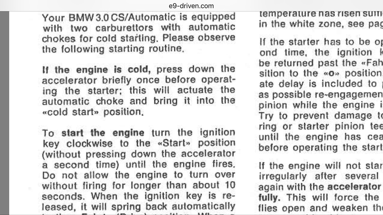

My car is an auto so I followed the instructions from the manual, which says touch accelerator once only.

So you need to push the accelerator a second time? I didn’t know that, I thought it was one touch on cold start.

the theory says one push, i find a second push very useful when the car has been sitting for more than a week, so i do this always
i shared this tip with friends that told me it has proven to be very effective, and no harm
