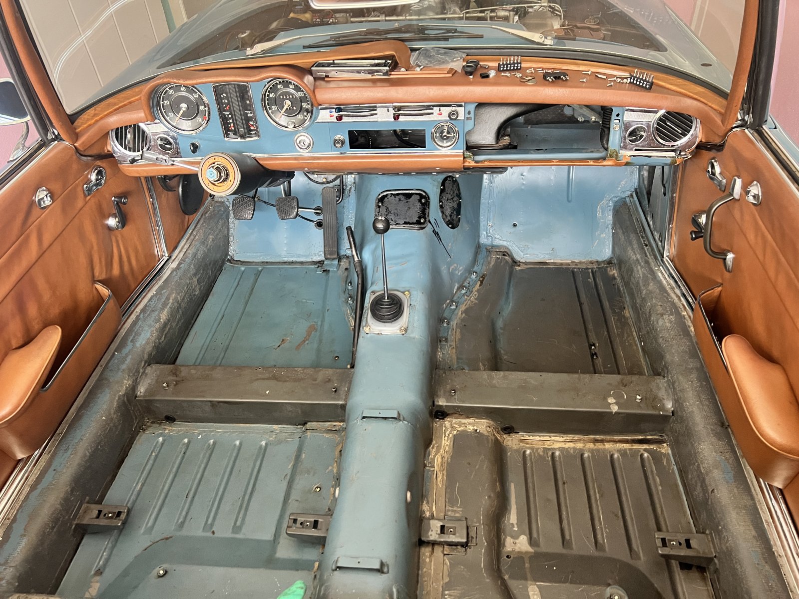

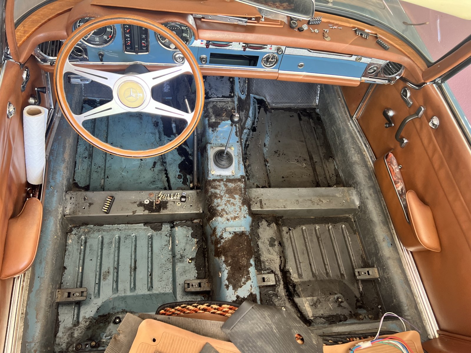

I've been researching soundproofing in between wiping off old layers of melted bitumen from the floor pan of my SL. I'll be happy to be rid of all the stuff. Still one section left, barely visible, on the top right where the glove box is supposed to be. That one will be a tough removal! A technique I figured out is to use a very stiff brush head on a vacuum, spray down the melted foam or whatever with your choice of solvent, and scrub it off. That kept the paint looking nice. And yet, it's tiring working under a dash.

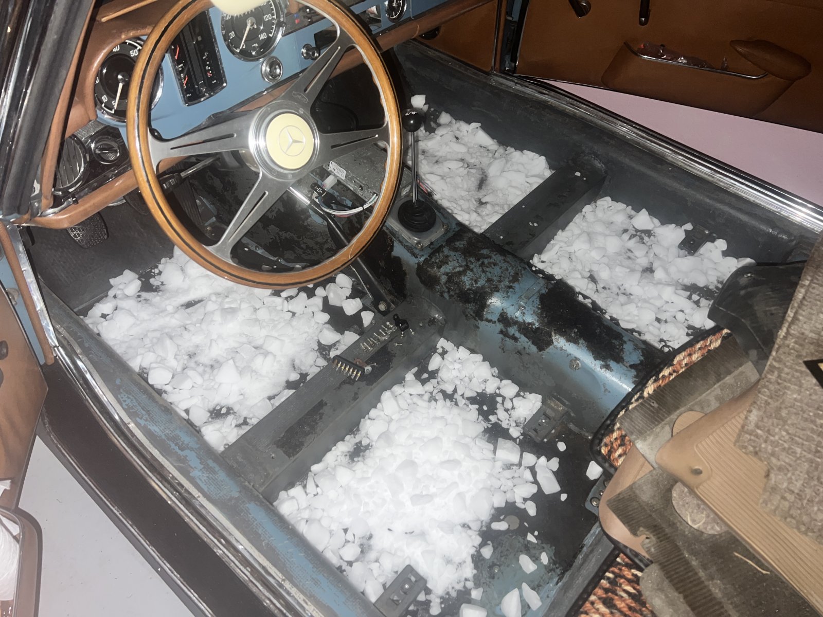

There has been some success on our forum using Dry Ice to remove all that stuff:
Oh yes! I used dry ice to get the bulk of it off. Sadly, everything that was left required lots of solvents, scrubbing, and chiselling.
