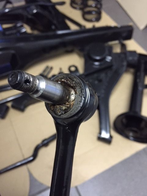

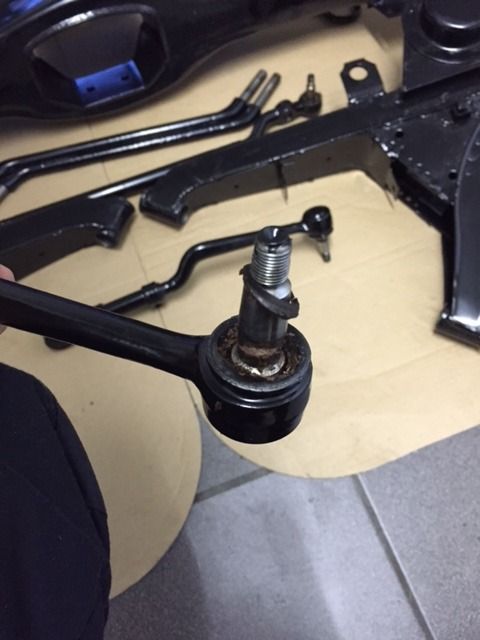

Hi everyone,

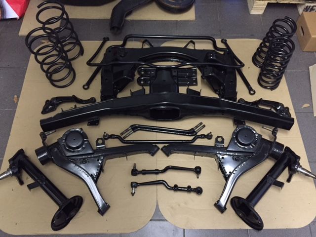

Last week I powder-coated some parts of my sub-frame.
I taped off the outer threads and put some bolts in the inner threads.
For the ball joints I used bushings and washers to protect them from coating.
Mission accomplished I thought, no coating on the conical parts...
But I noticed that the sealing of the ball joints got wrecked by the high temperature and popped out as you can see on the pictures below.
The ball joint self seems to be working fine.
You guys think the steering arms are still usable since they still need a ball joint cover filled with grease anyway?
Or do you recommend to buy new ones?
