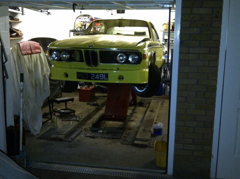

Here she is up in the air awaiting a manual steering box and head gasket!
