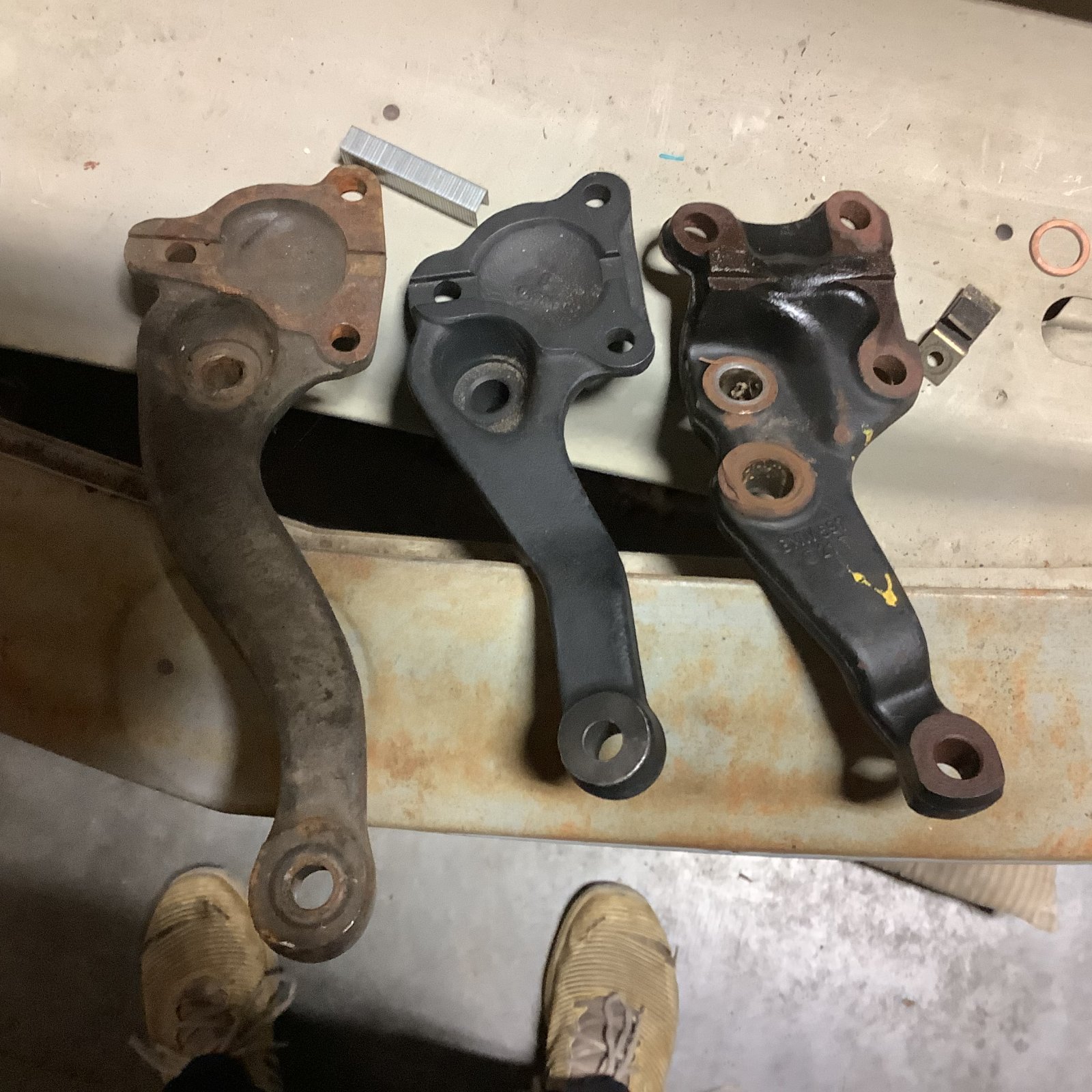

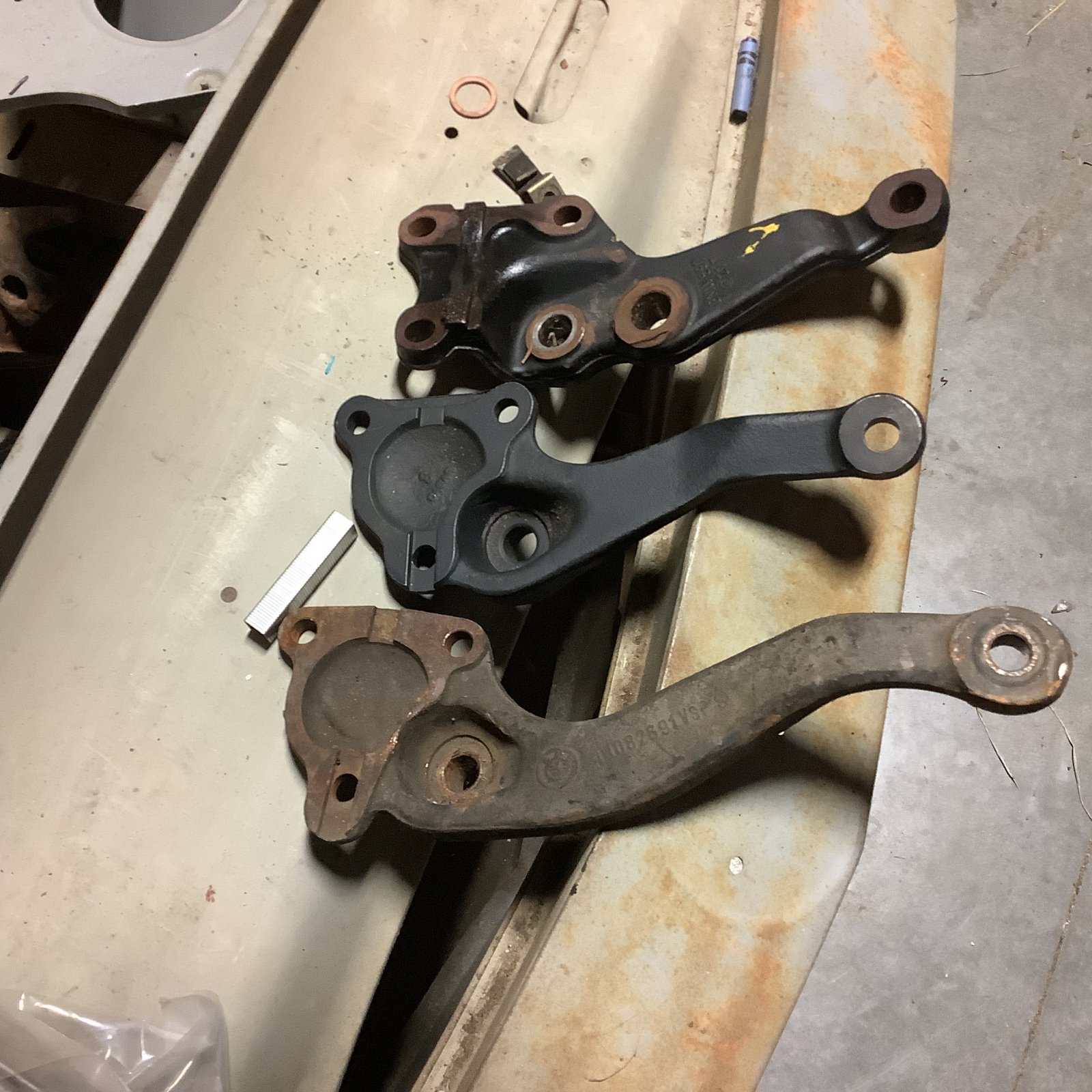

I was working on something else when I found a steering arm in the trunk of one of my cars and compared it to the steering rack arms I have that fit the CS strut…is almost identical in geometry…the arm is off an e34 or e39, have to make sure but I “think” some folks in the past have used later front strut housings and am curious how that would work…the e34 Bilsteins inserts have about twice the upper mount bearing surface area which is really nice for using caster camber mounts up top. Also the choice of brake upgrades like 540/750 single line calipers with the later style master cyl would be great…

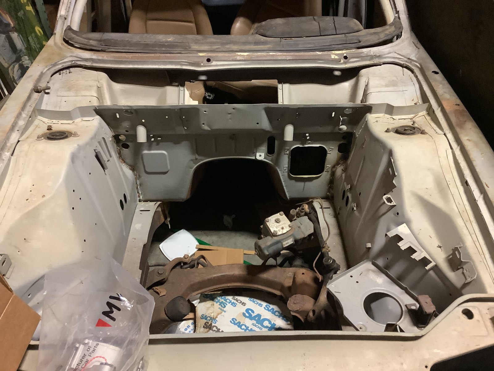

Going to mock it up on the tub in the picture with each set up and stock upper bearing and see where it lines up. photo of arms is stock CS, CS steering rack, e34.
