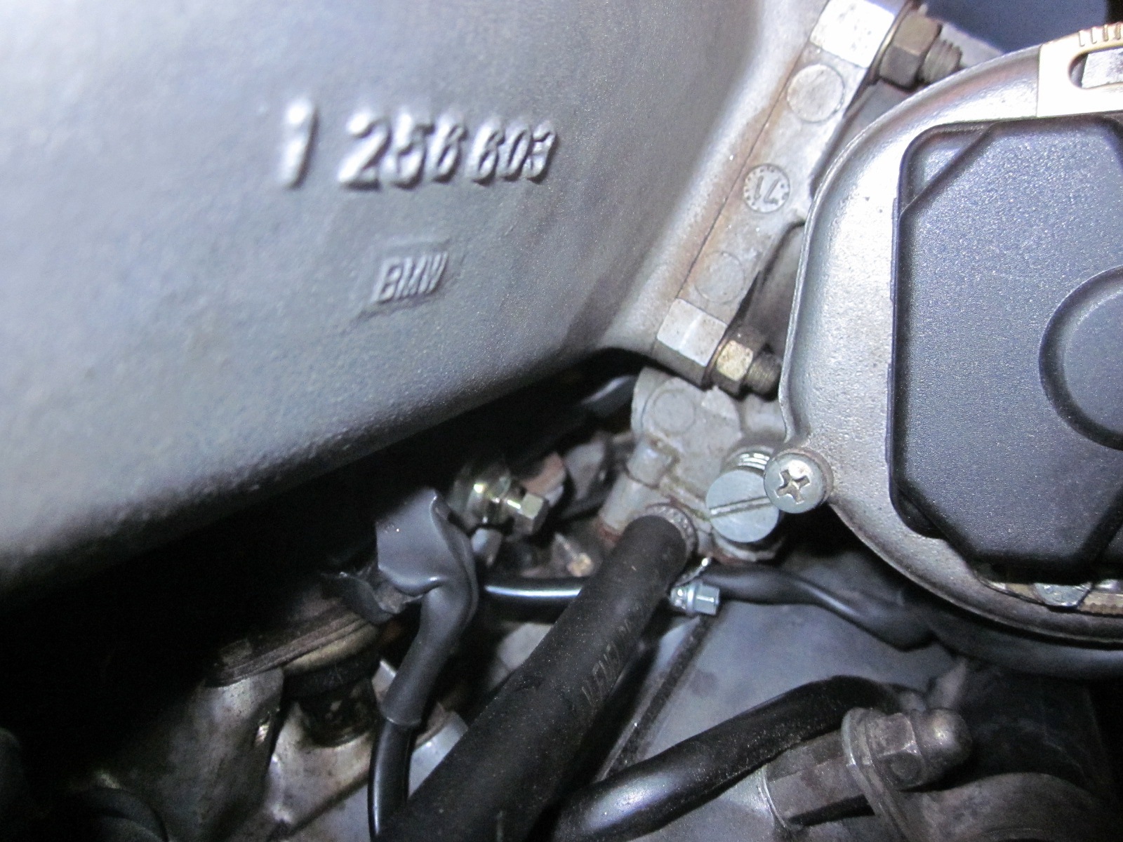

May only need adjust the large Throttle Air Adjustment Screw under the back of the Throttle Body, a 1/16 to 3/16ths of a turn out.

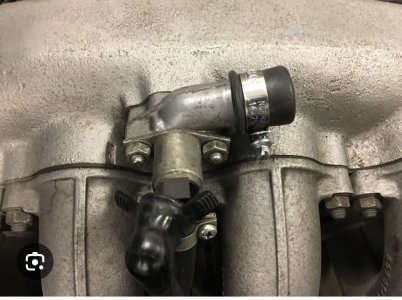

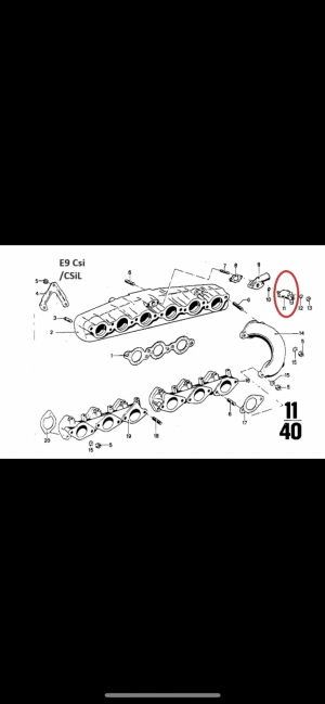

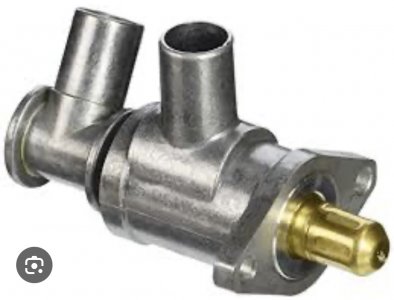

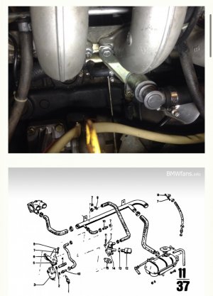

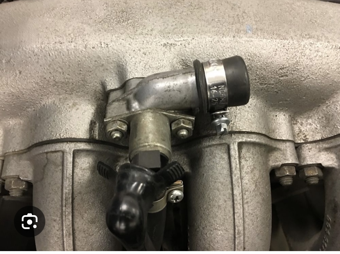

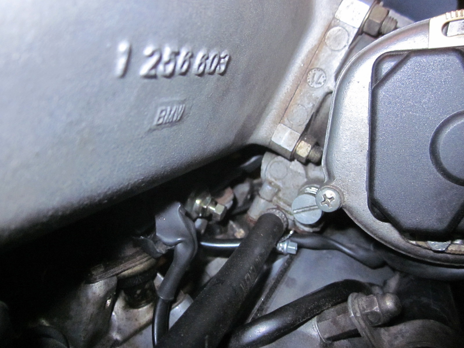

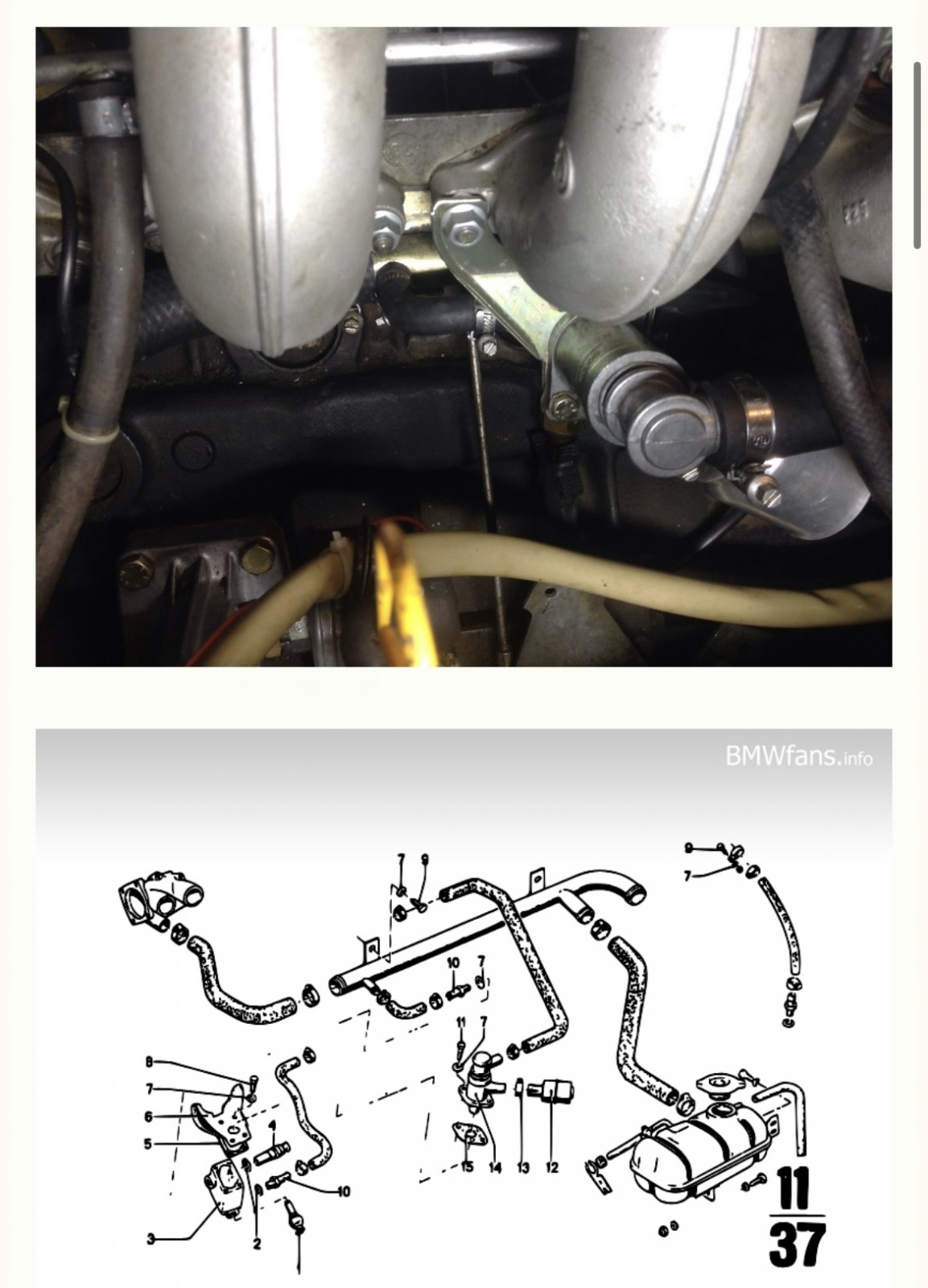

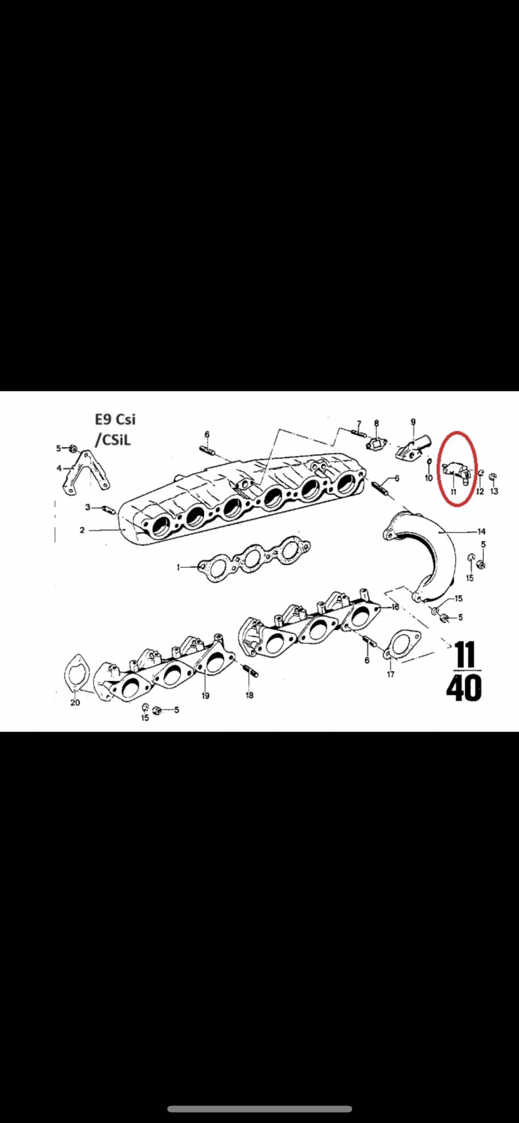

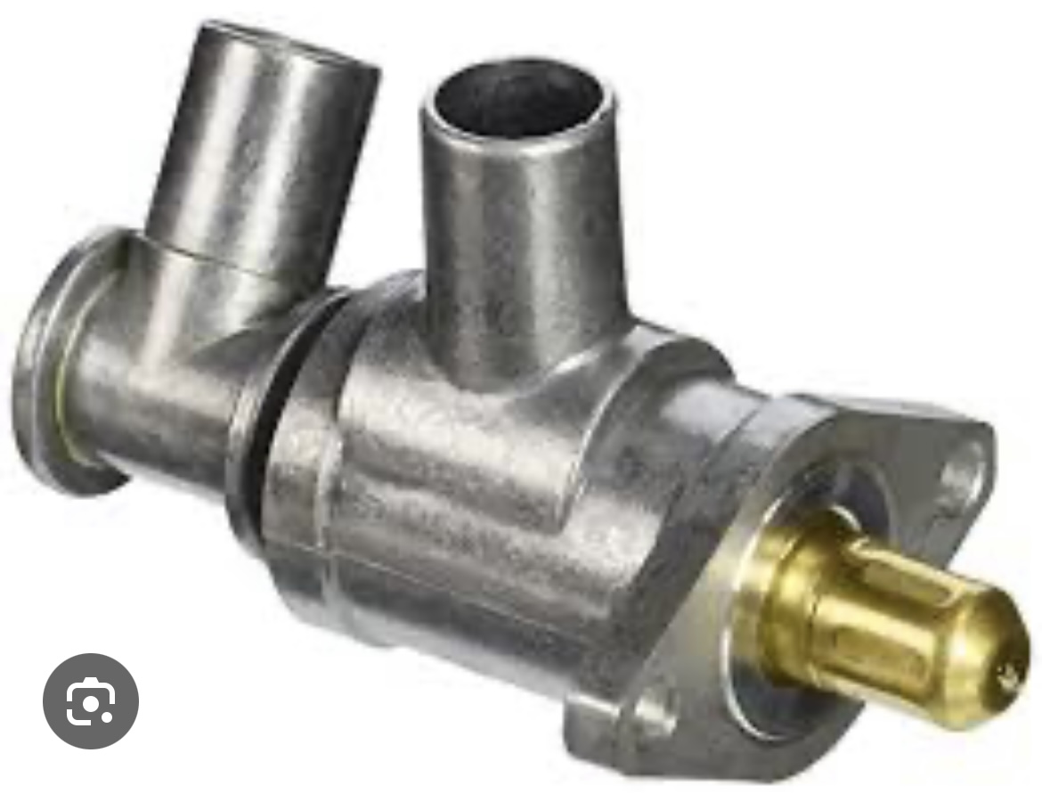

Like Don and Ada mentioned, check these parts. The AAV and cold start valve. I should check the AAV first (no 14 in schematics) based on the fact that it is running lean and that this type of valve has the possibility to get stuck after suchs a long time not running based on own experience.
Take it off and test it in hot water to see if it is still closing.
