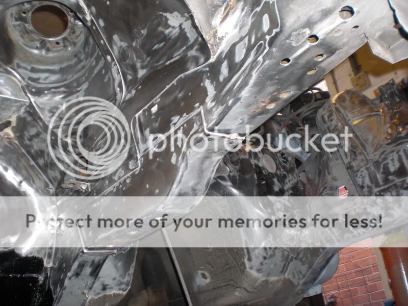

Re stripping paint, on my e30 race car i use Polycarbide pads on my grinder, they strip paint very quickly and leave a good surface. I did most of this engine bay in a few hours - it does make alot of smoke though!

A lot of prestige body workers tend to do it all with automotive paint stripper which they cover with kitchen cling wrap. You can then use a 3m strip and clean disc on a grinder to finish it off.
