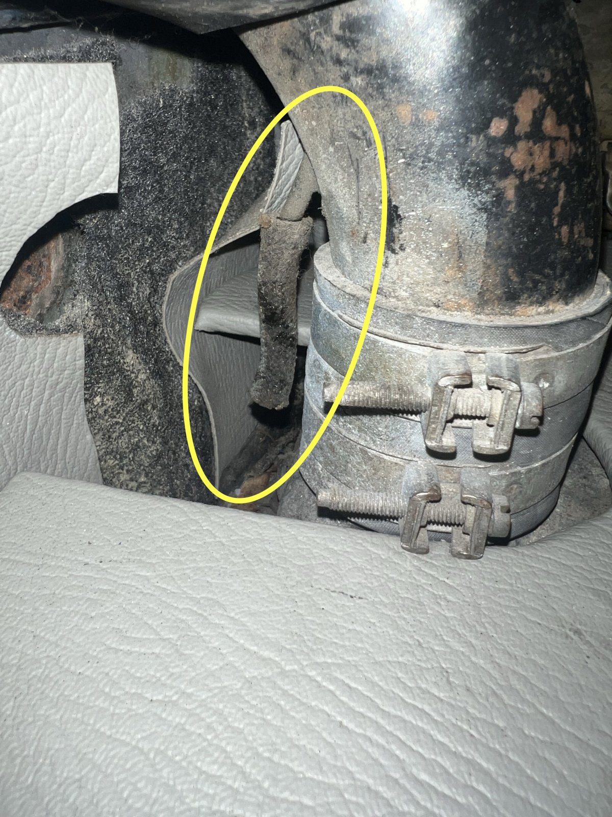

Seemed the fuel tank filler neck but now unsure (at least that’s where the concentrated smell is coming from). I realize this may be forensics. - I’ve read the great post by Chris Macha which I can follow, but hope to narrow down. In mean time, does anything look suspicious in this photo?

Is there a vent hose hooked to your filler neck, looks like it is missing?

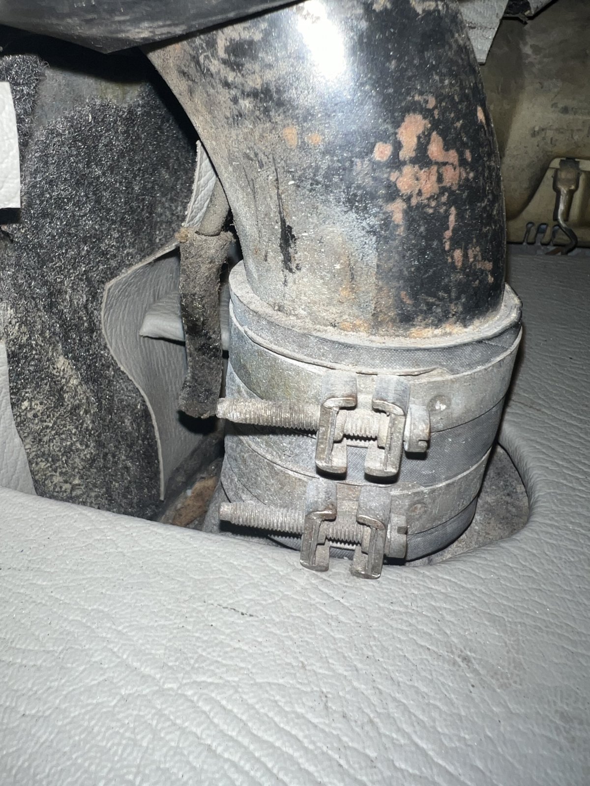

Just this two inch bit in pic. Should there be a longer line that vents somewhere?
You had mentioned this in your post - "The one that many ignore is the gas tank venting system. On US coupes the gas tank filler pipe has a hose that goes to the fuel vapor catchment tank on the right side wheel arch. From there a blue plastic line runs on the right side of the car and emerges in the engine bay in front of the passenger. From there it goes to the charcoal canister under the battery and then to the bottom of the air cleaner."
Also there is no fuel vapor catchment tank, if that matters.
