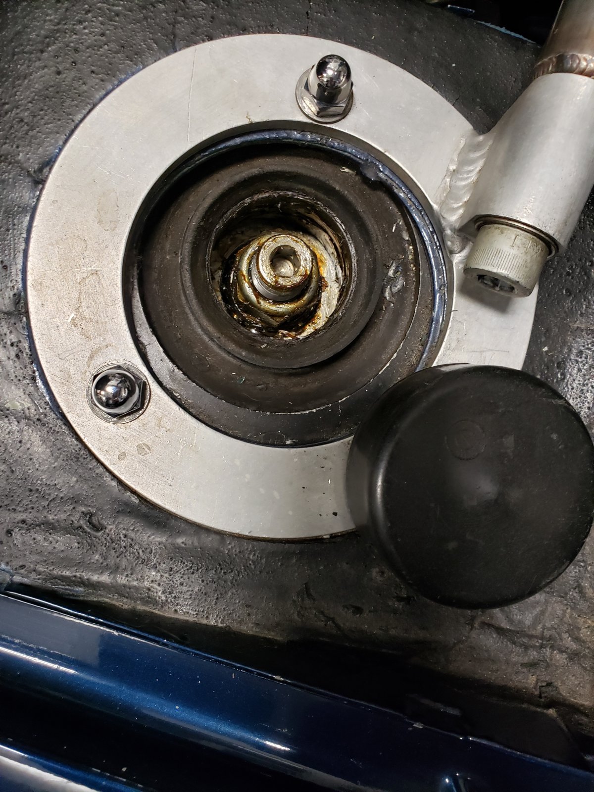

Is it possible to over-tighten the nut on the strut- under the cap and simulate the same effect of reversing the washers? I think I have the washers in there correctly- I can see the ball bearing if I take the plastic cap off, and I think the larger washer goes on the bottom, (smaller diameter but slightly thicker on top), which will allow me to see the balls. Anyhow, I seem to have a return-to-center issue... once again. Any help would be appreciated

I don't think overtightening would cause any ill effects other than stripping the threads and making the nut difficult (or very easy) to remove. Overtightening the nut of the strut cartridge would lock the piston, but it's free to rotate in the strut cartridge, which is free to rotate in the strut housing.
Return-to-center has more to do with caster IIRC. Or something like that.
But tell us, what strut bar is that?

In order...
From the top...
Plastic cap
Nut
Small thick washer
Dust cap concave side up
Big washer
There is a very big difference between stuck in position and won’t turn freely and won’t return to center automatically when the wheels is let go. One is a mechanical issue and the other is an alignment issue.
