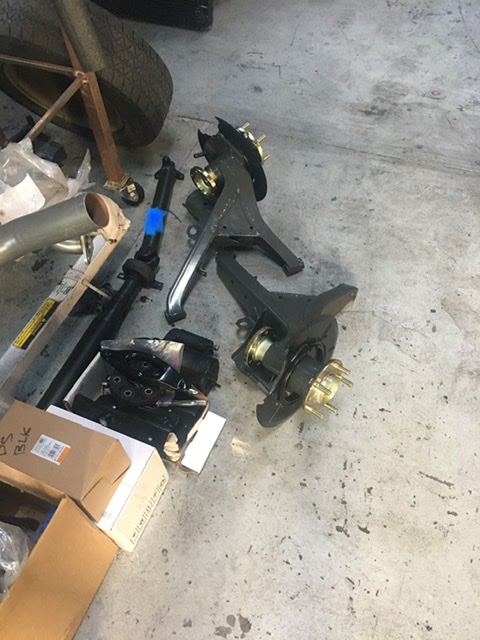

okay guys, i know this has been discussed before ... but here goes again to see if i can learn something for the FAQ that i am writing for e9 color placement.
there are reports of original struts / subframes being either a green gray or black. I have previously heard from well respected people that both were used. so my question is to try to figure out if there were any rules.
so what i would like to hear from people is
1. what year is your coupe?
2. what color are your struts / subframes?
the last question is, does anybody have a RAL color for the green / gray color?

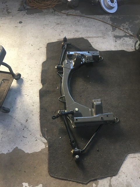

I like this color
It’s the color you see when you separate the subframe from the frame rail.
and the color inside the airbox and the color under the intake hose on the outside of the airbox on the csi and Csl.
i agree with Chris ... it looks perfect. unfortunately i do not have an original air filter housing or a CSi airbox ... and the later style airbox i have is black. would love to paint my airbox the right color ... and the subframes are a bit large to take to get color matched. would really like to know the color makeup that you are using.
Don, that is obviously gorgeous - well done.
