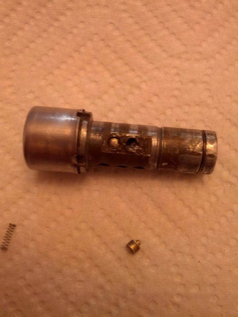

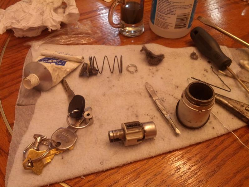

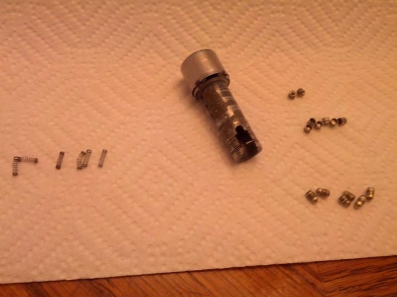

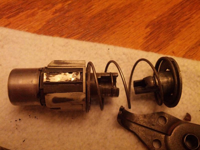

Cleaning the lock cylinders
I made the mistake of spraying WD-40 into all the lock cylinders thus gumming them up. Opening the trunk became a problem but with A LOT of fiddling I was able to get it open.
Once open I decided to rebuild the lock cylinder. It was surprisingly easier than I thought as everything was serviceable (read: not permanently sealed).
Granted once I did take the tumbler cover off the springs and tumblers came shooting out. But with patience and a clean work area it can be done. I am sure the door locks are also serviceable.
Cheers.
