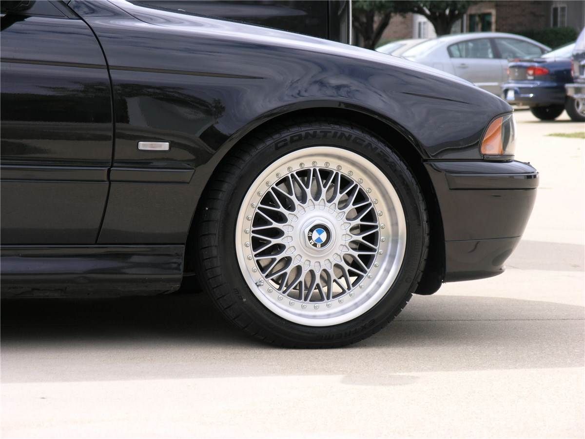

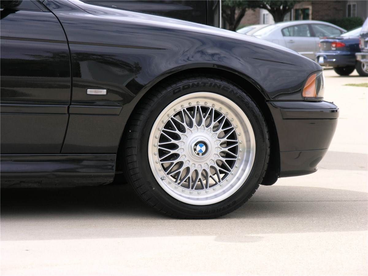

Factory E39:

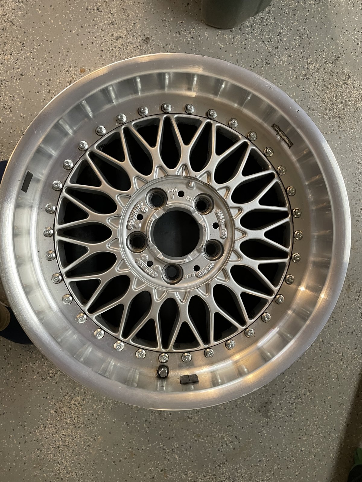

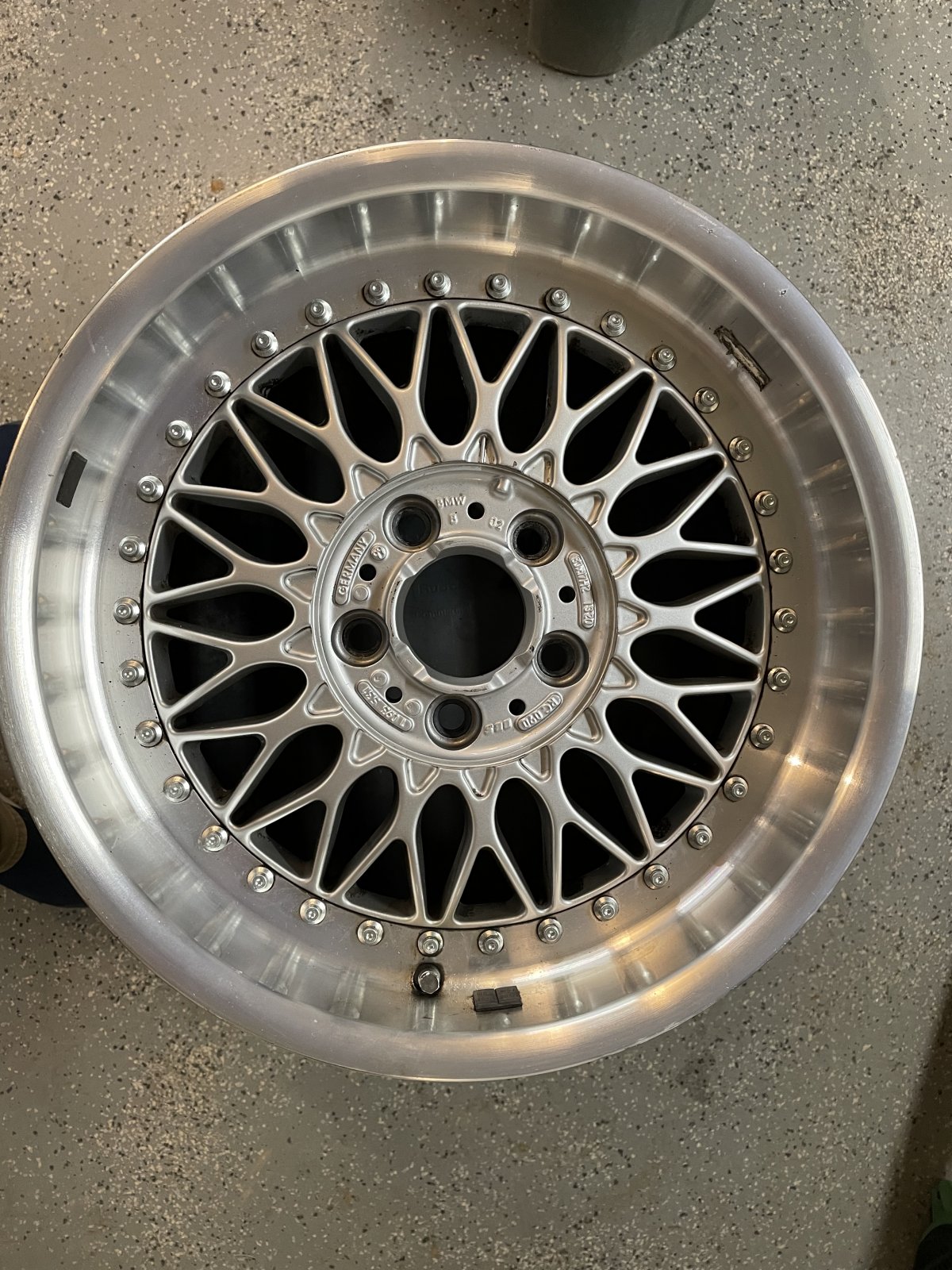

RC090:

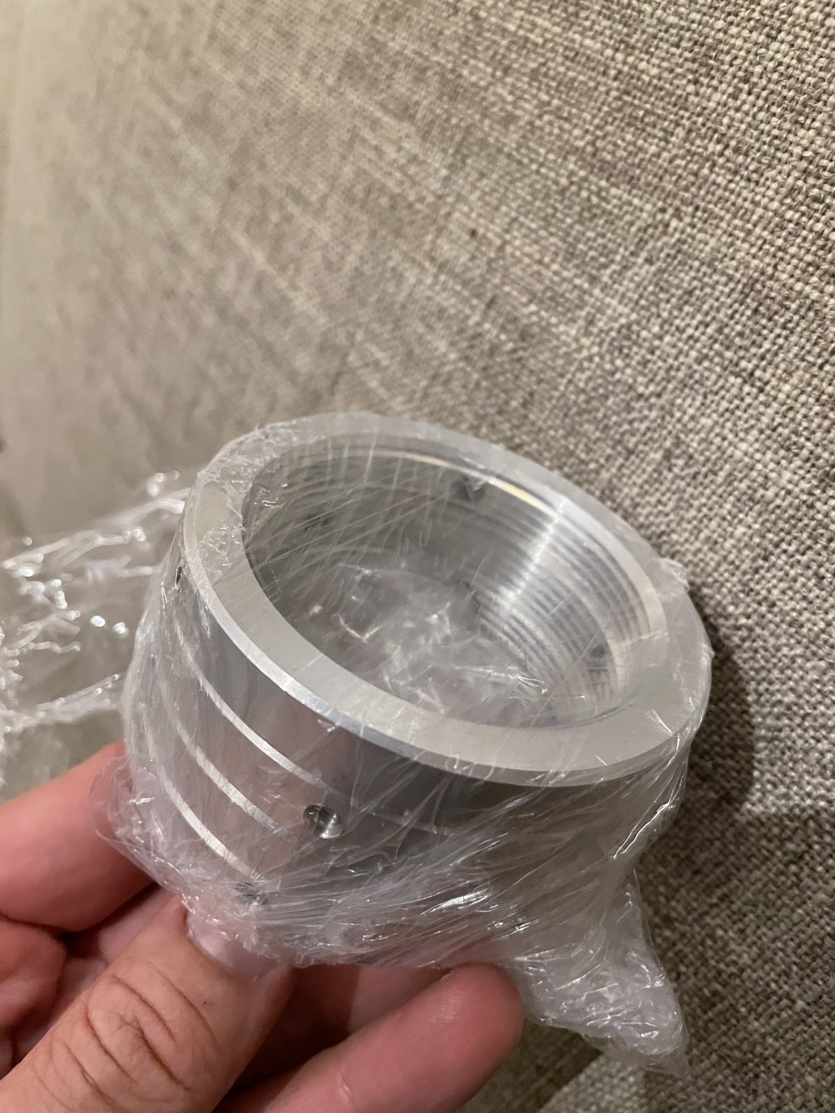

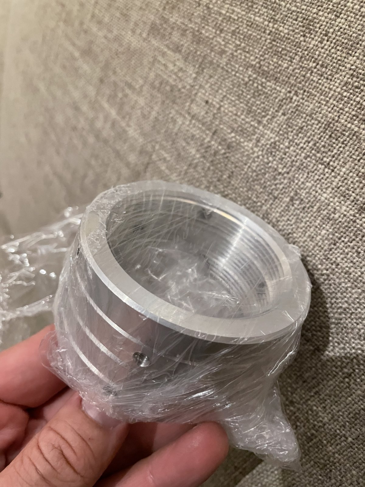

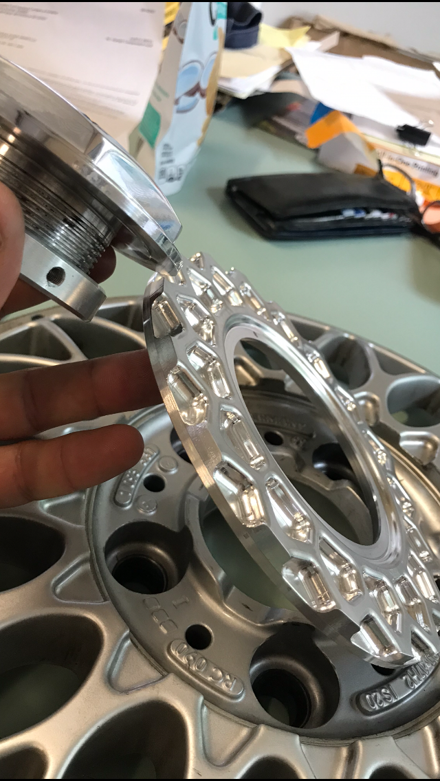

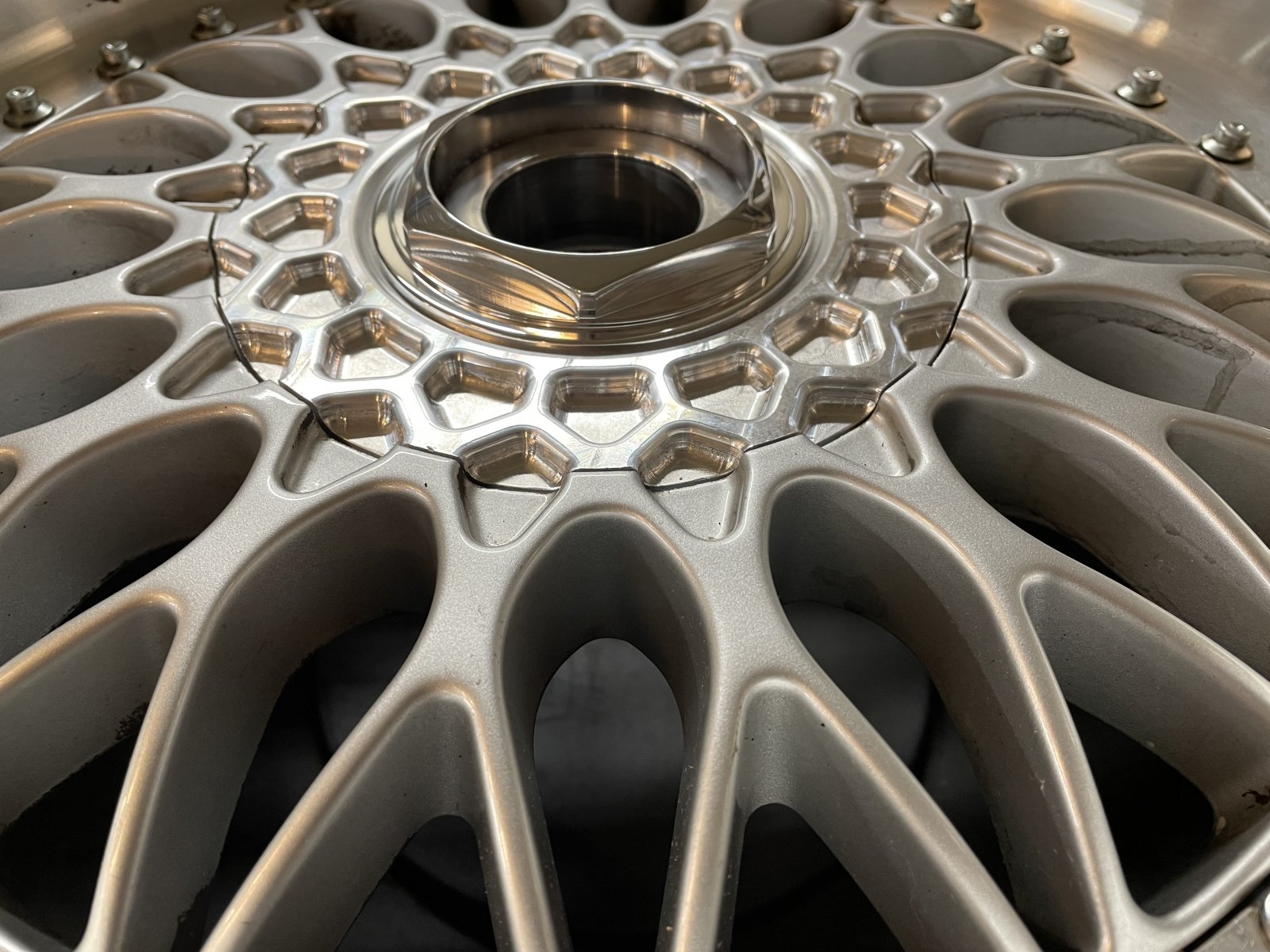

This threaded collar attaches to the hub center via set screws:

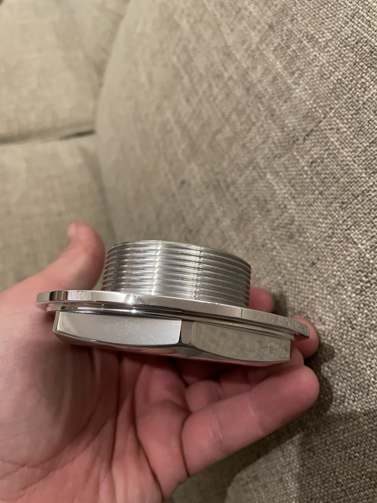

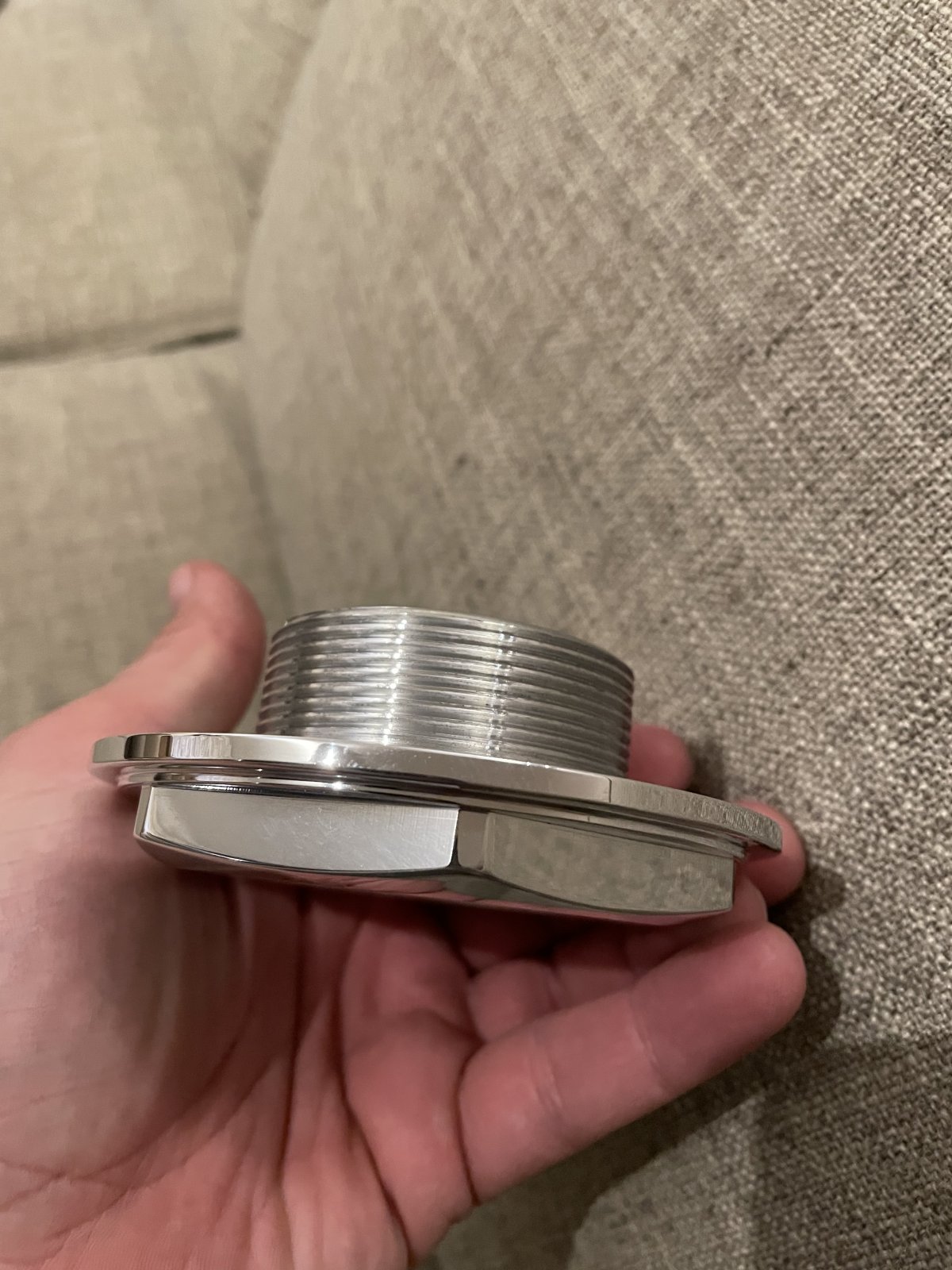

The polished CNC’d aluminum center lug threads into the collar

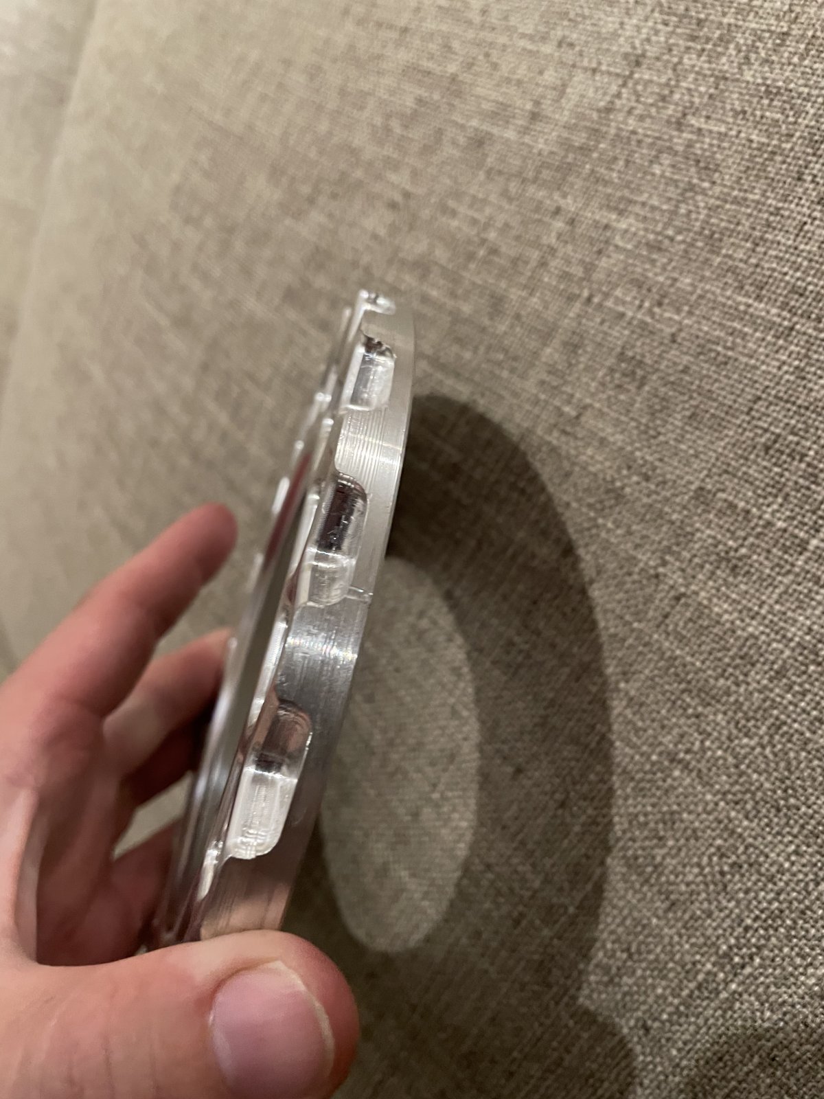

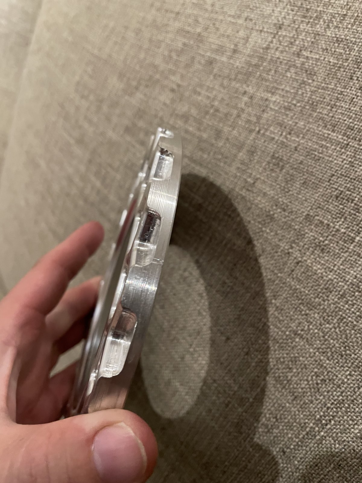

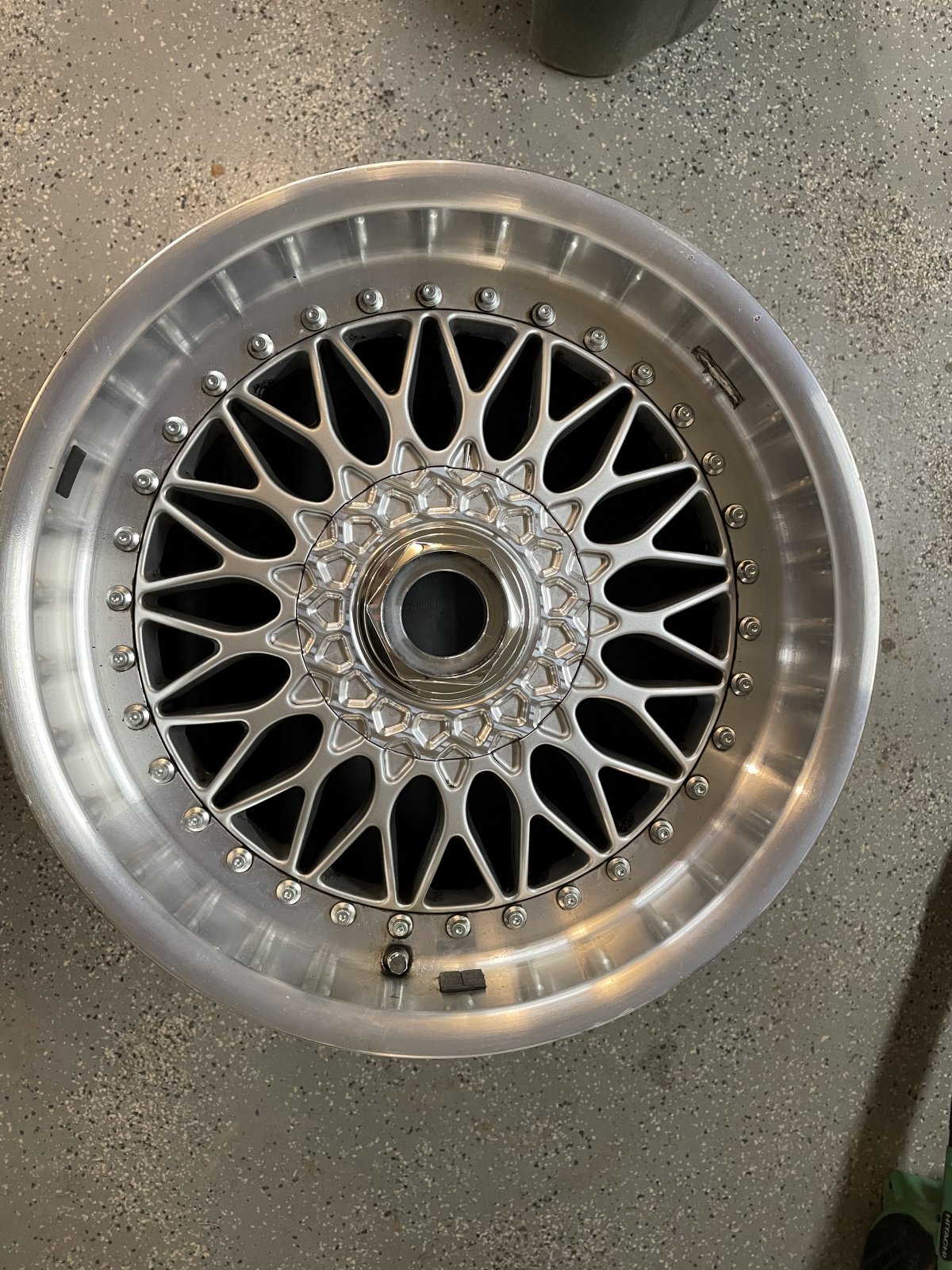

The “waffles” are CNC’d aluminum as well.
Quite stout:

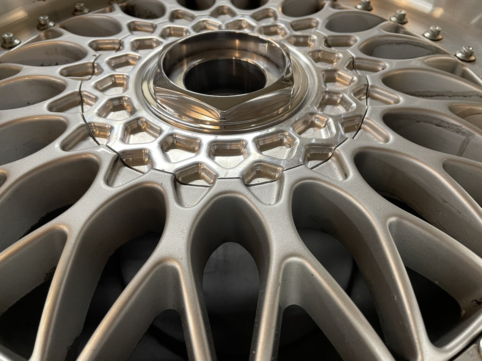

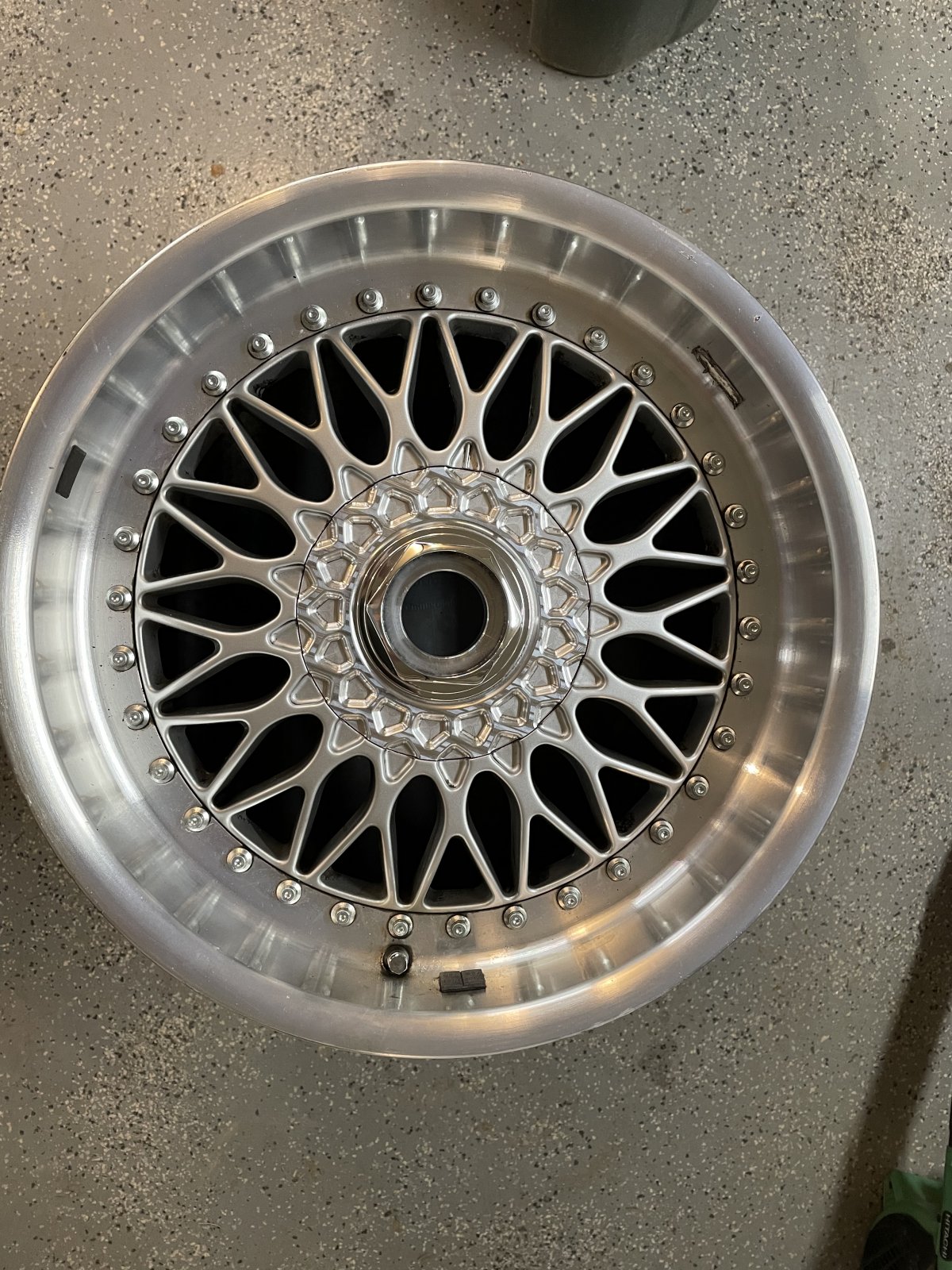

The result, sans BBS/BMW center cap:
If one is inclined, they can now grind off the center cap alignment mark on the wheel face.

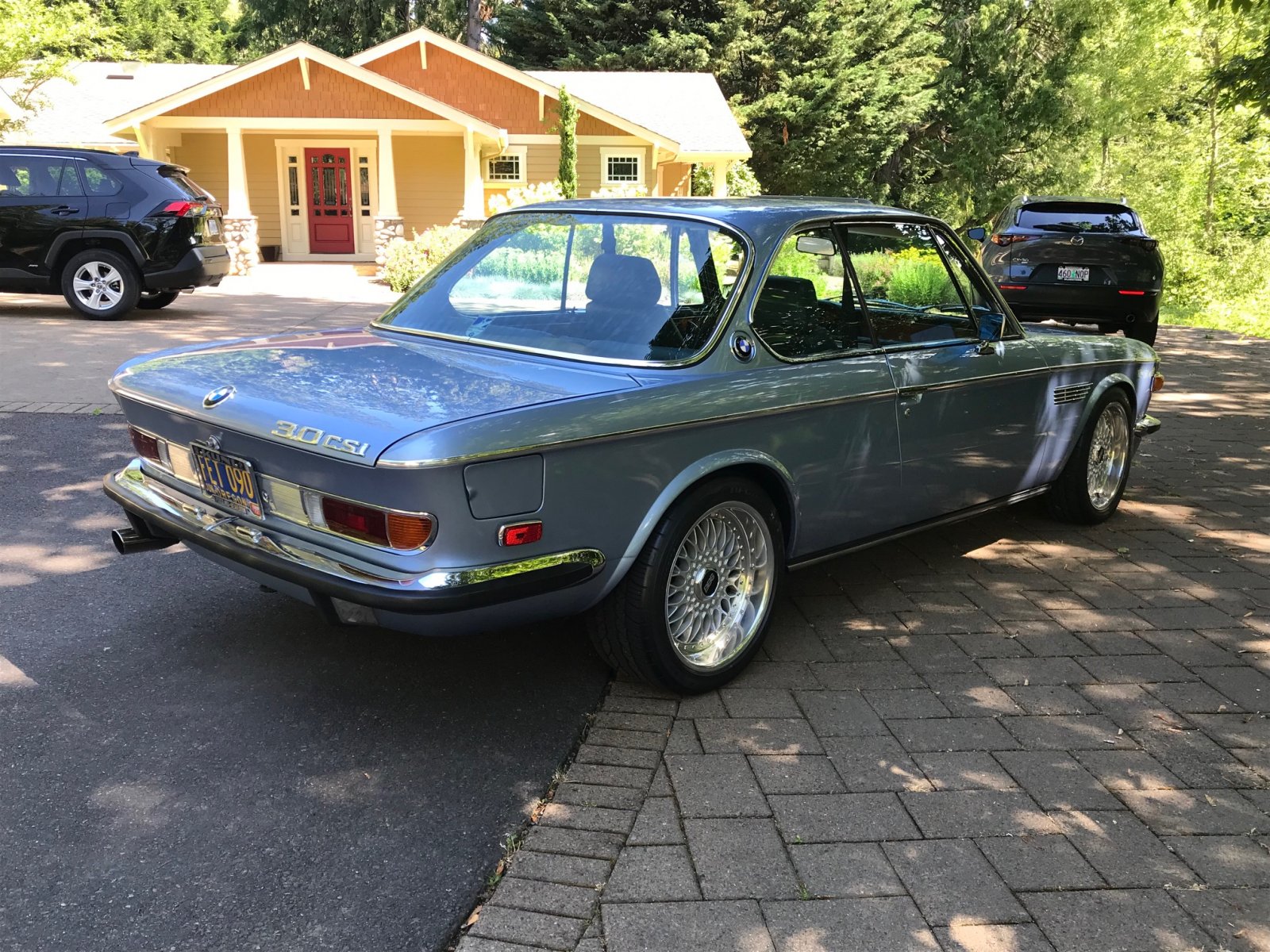

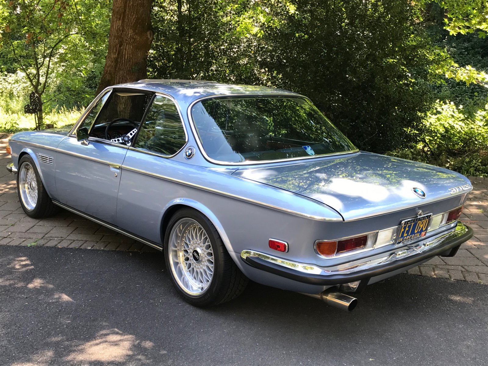

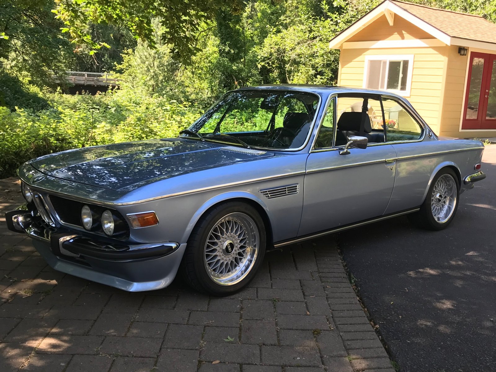

Yeah, I'm going to but them on the my staggered 17 inch Style 5s that are on my coupe. I might get started on them tomorrow. Here's the link to where I bought them, Paul and crew are great to work with.

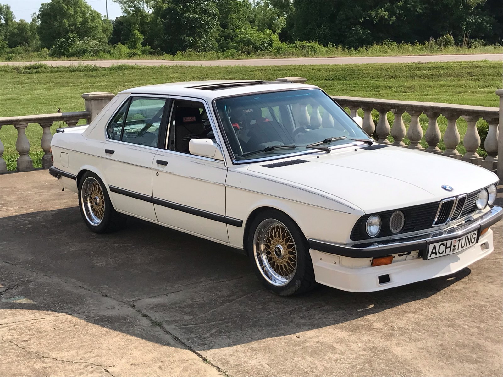

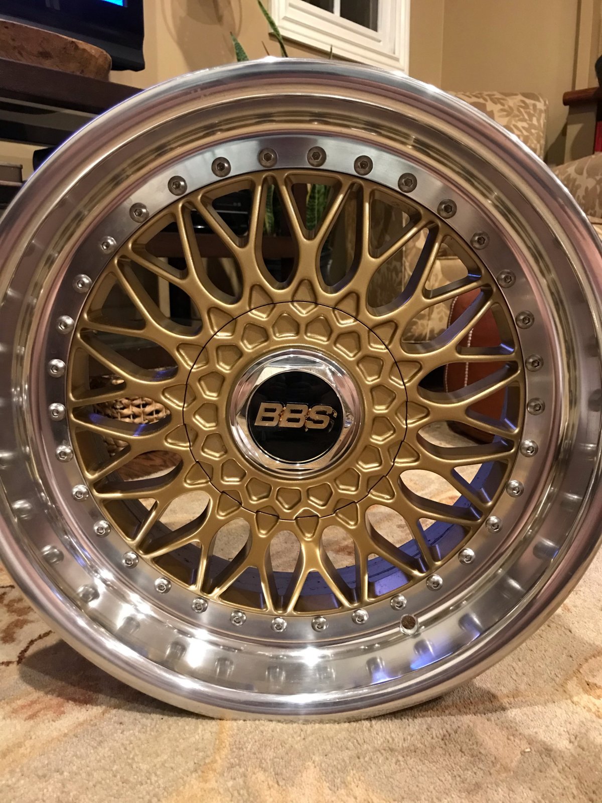

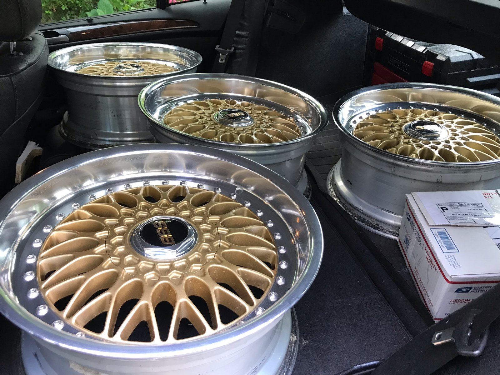

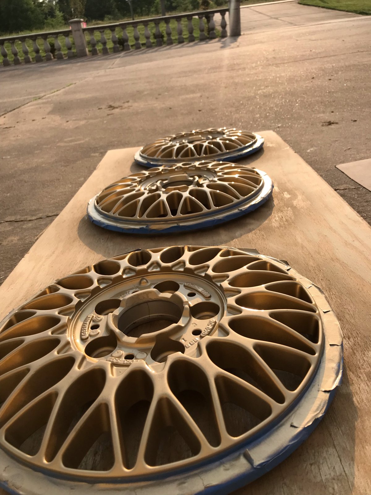

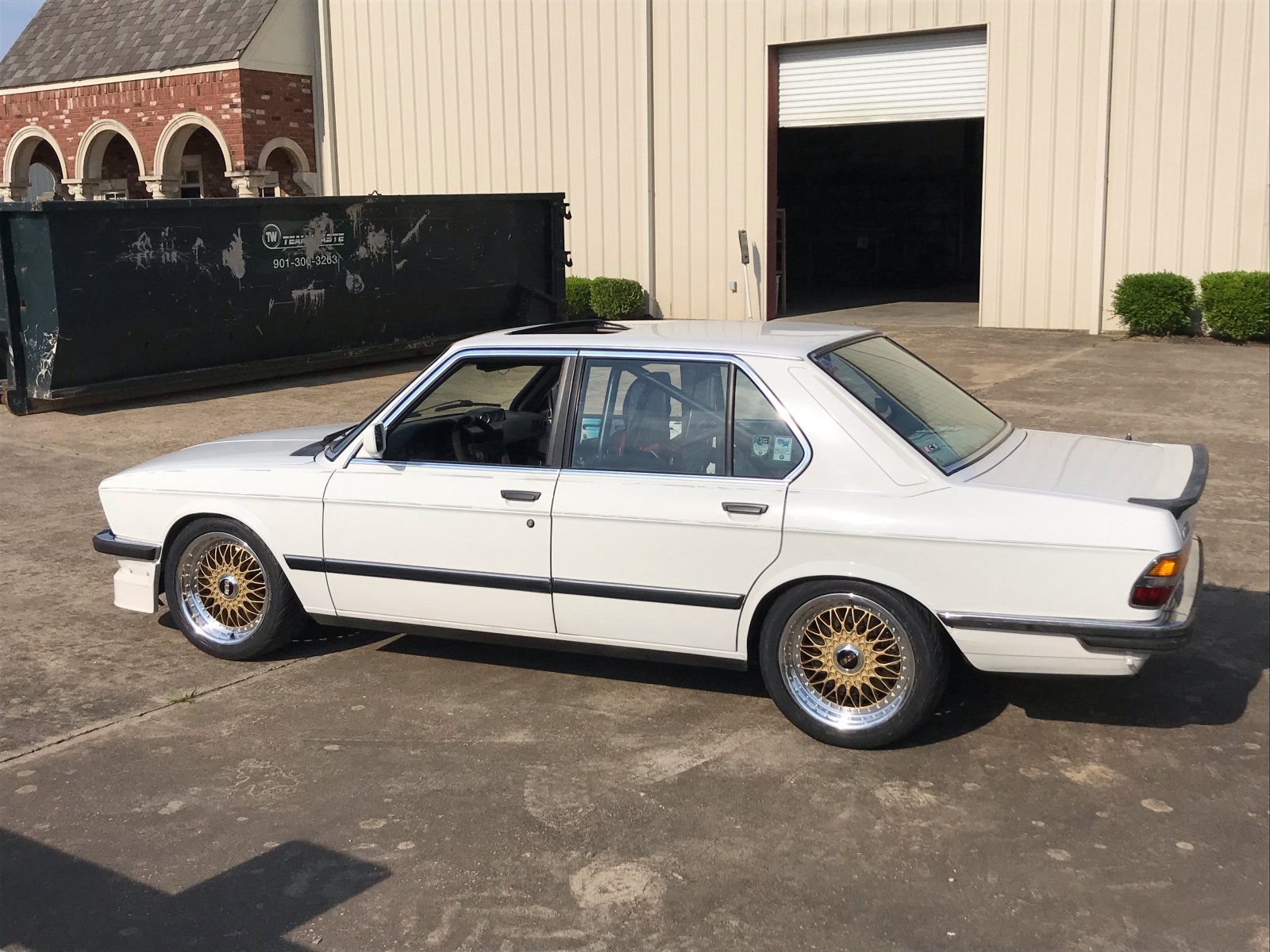

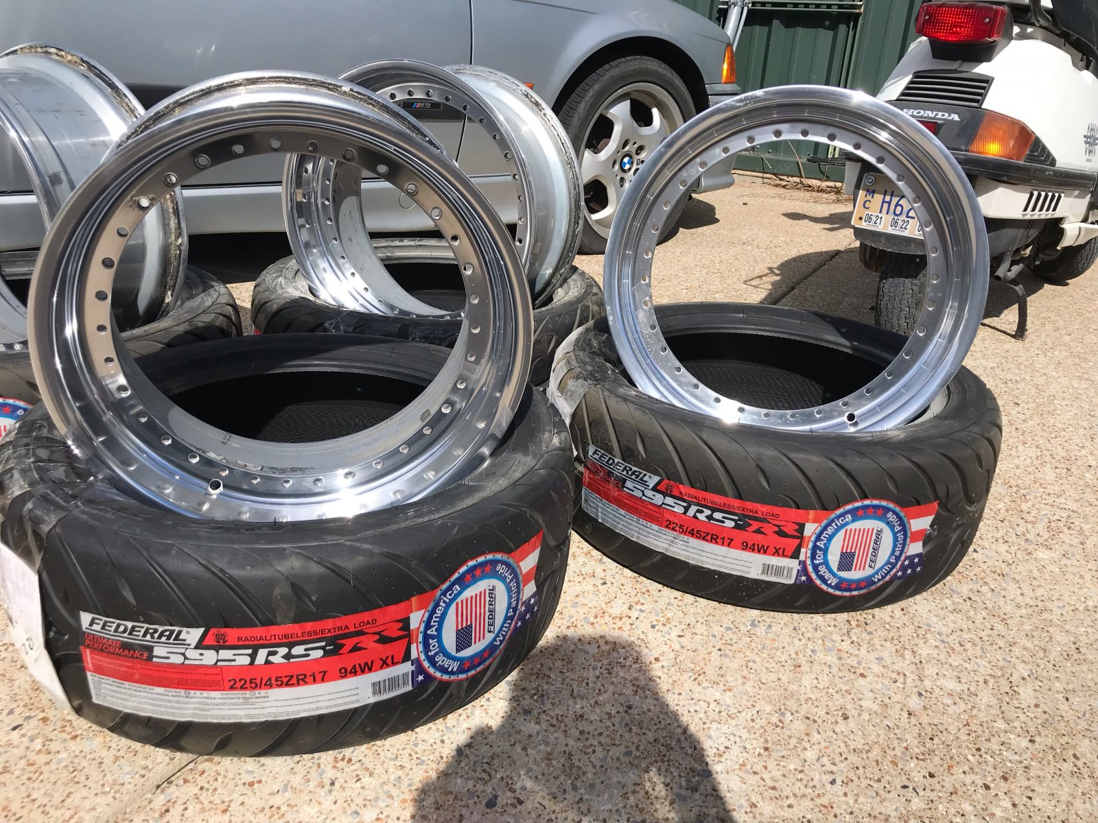

I ordered a set from Paul about a year ago. I subsequently ordered stainless round head Allen bolts with nylon locking nuts to go on the back. I wanted to get rid of the original hardware that made it difficult to clean and keep a polished lip shinny (and the amount of time and energy I have to devote to this task is little to none). I also ground off the alignment locator line to remove as much evidence of the rims being RC 090. Not that they are bad, just not RS’s, my preferred wheels for most all vintage BMWs.

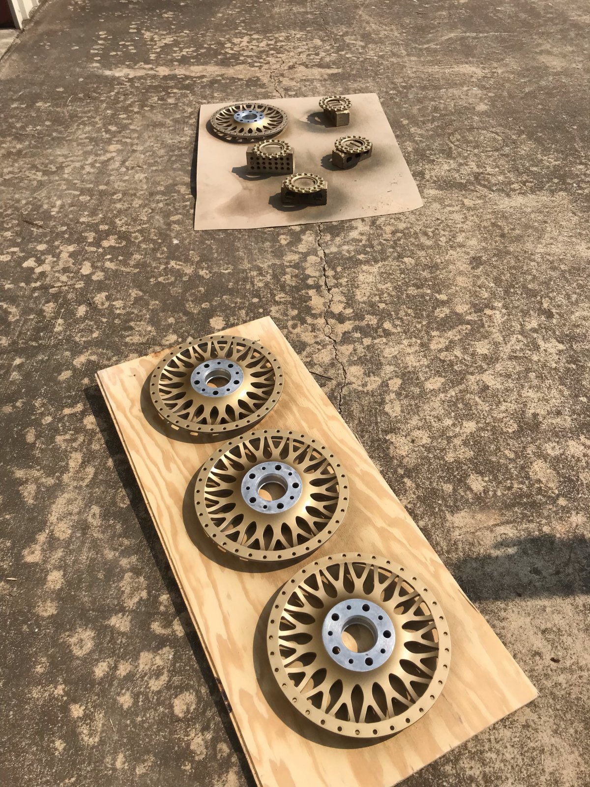

I’ll post a few pics of my process. I decided to go with a classic BBS gold center as the wheels were planned for my vintage e28 race car. I got the paint on line, they stated they had a proper match for original BBS gold. I have to say, the match to my original BBS RSs is spot on. Also, before I get called out on it, the inner beads of the rims were cleaned before I mounted the tires.

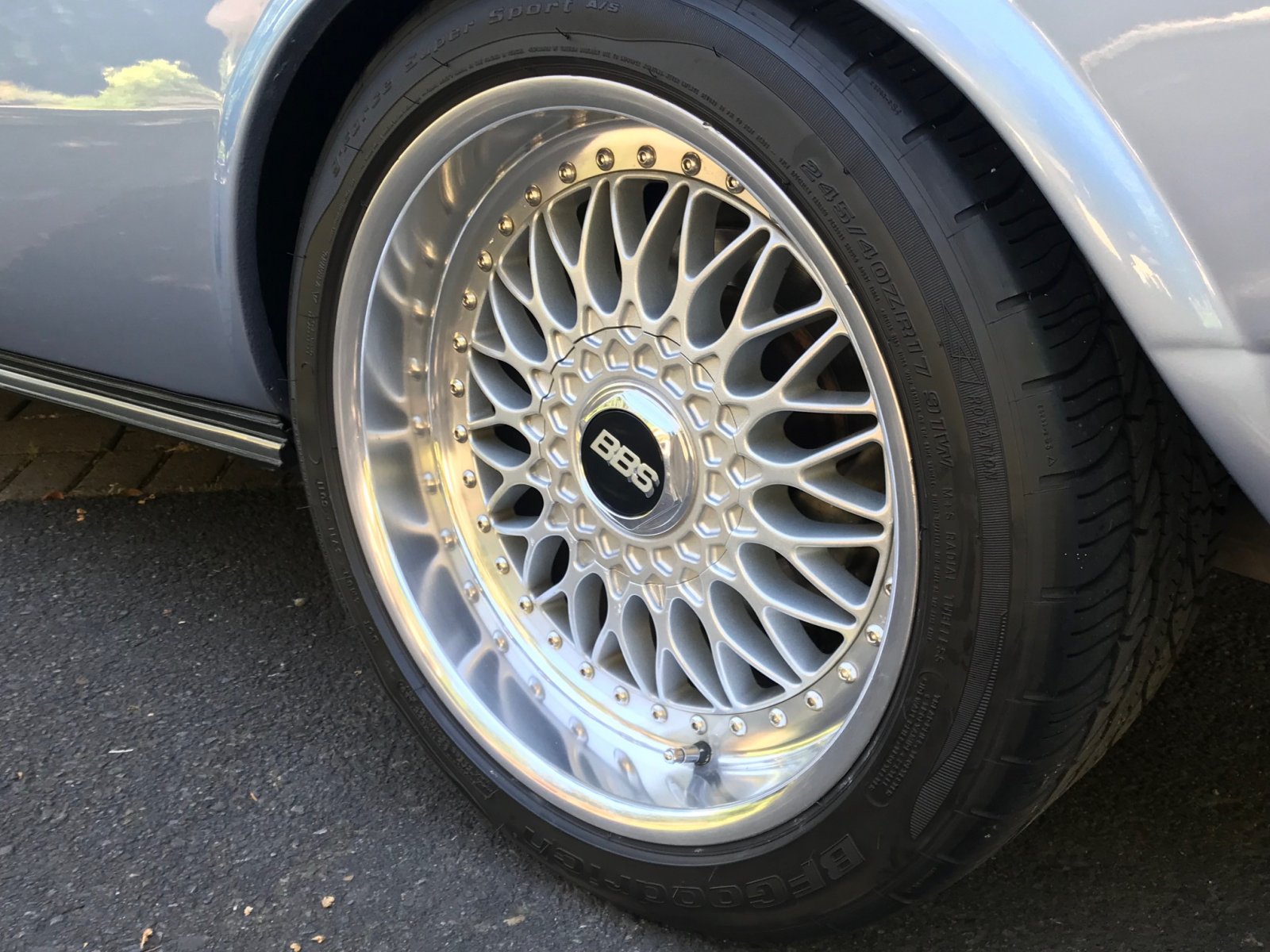

They look spectacular on that car, especially in that color. Had you previously swapped the hardware, or was it an “all at once” upgrade? I locktighted the small Allen set screws on mine when I installed the center cap holders. It’s a cool system and well worth what I paid for it. Now that I’ve converted, I just can’t stand the sight of the original plastic cap (even though it’s not that bad)
Thanks! I did everything this last week. Took it to our local BMW C&C this morning. At least two people want to do the same to their Style 5s.
Vince, i have a question ... since i know you focus on details. how was the color match of what you got from Ehrlich compared to your wheels ... or did you repaint them to match.
Hi Scott,
They come Ehrlich in just bare aluminum. I used etching primer, painted them, then several coats of clear. The paint on the wheel centers is years old, I got as close as I could.
