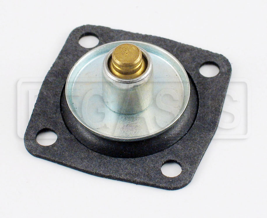

Couldn't access your video, but sight unseen I wonder if you don't have a funky accelerator pump diaphragm or something wrong with the checkball/spring that is also part of the accelerator pump assembly. (I have not looked at a 32/36 carb in a while and recall that while there are two nozzles (one for each venturi) some of them - presumably on the progressive 32/36 carb - only have one open port/jet. On the non-progressive carburetors, e.g., the 38/38 DGVs, the accelerator pump has two ports/jets.)
Is yours dripping - leaking? :sad: Inspect the pump diaphragm and related assembly.
