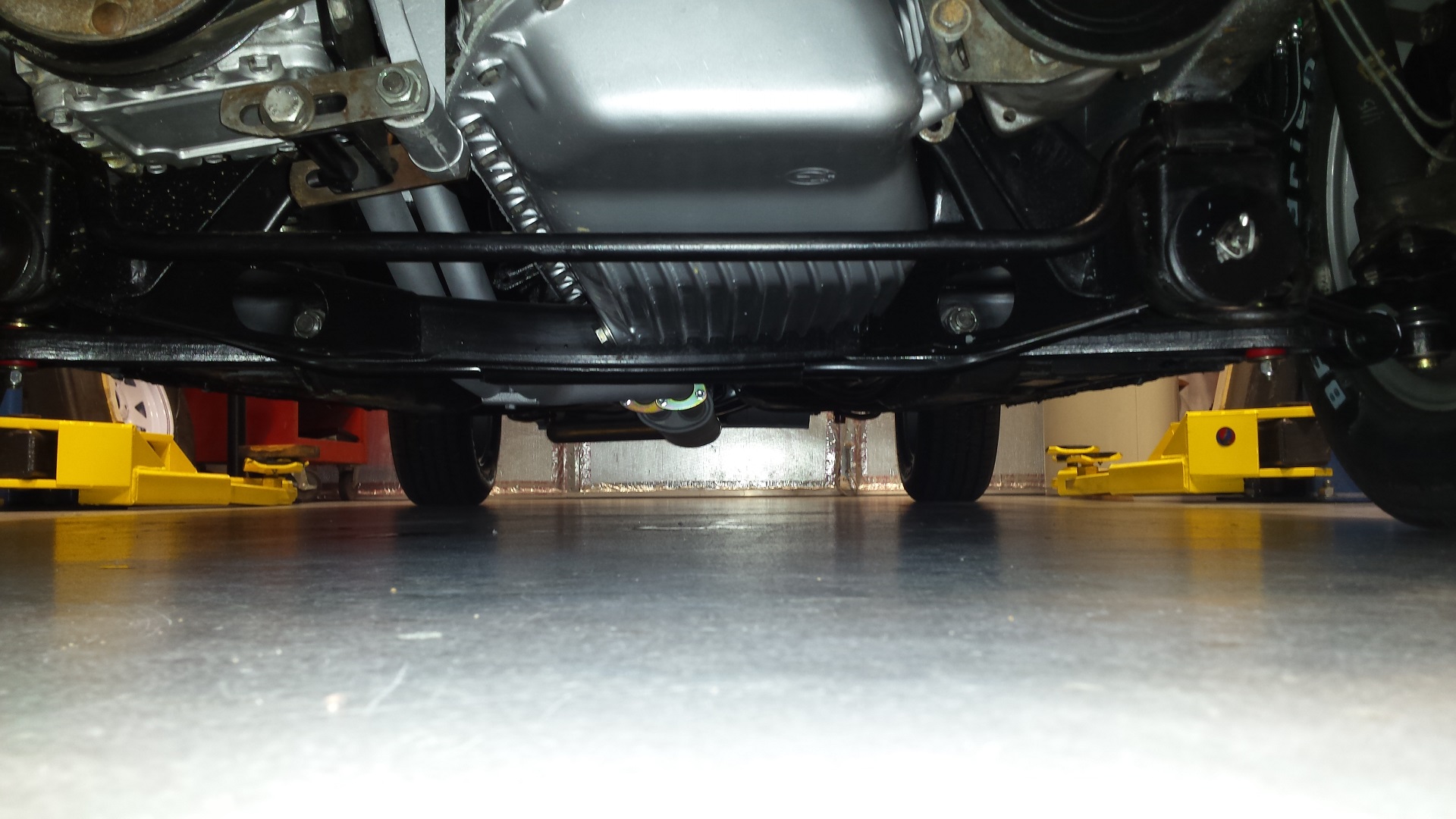

I forgot to do that before I started tearing my car apart and, boy, do I regret it! Cleaning years and years of grease and oil mixed with dirt is a horrible job, especially if you do it at home.
It is well worth the $100 or whatever to have the motor and frame professionally steam cleaned top AND bottom right away. If nothing else, the pros that do it have a proper set up which will either recycle or somehow clean the resulting sludge so it does not pollute our environment as doing it yourself will likely do. (Make sure that is the case! Don't go to someone who will let all that drain into the ocean of course.)
It will make your (or your mechanic's) life a thousand times easier and more pleasant. That, in turn, will result in a better job. A win win!
Working on a clean car is imperative!
