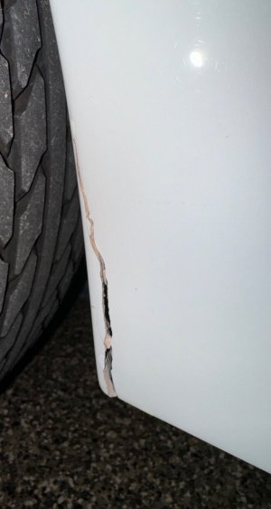

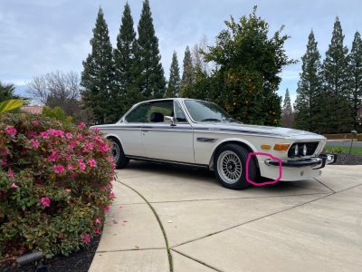

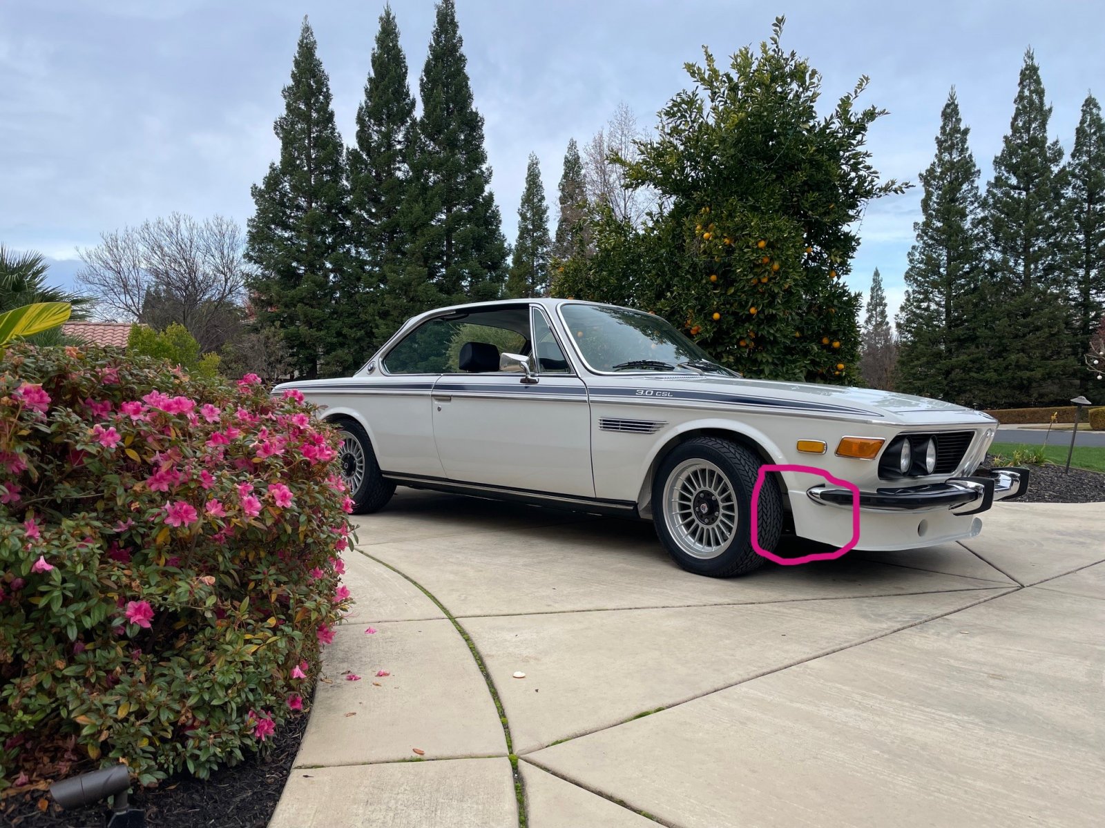

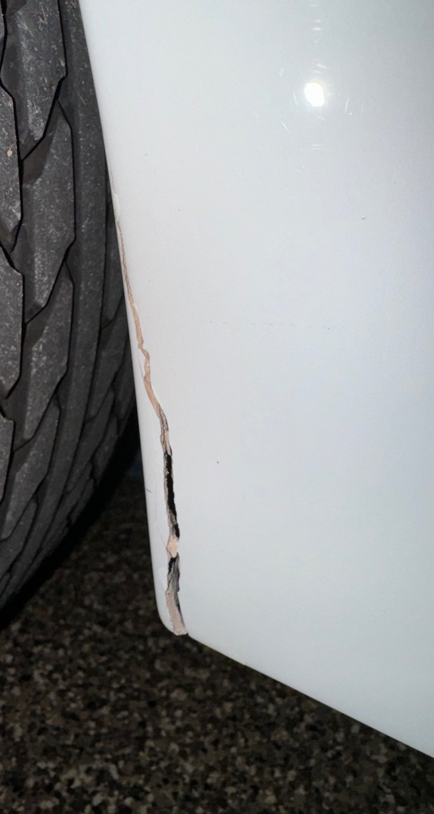

While tying down on the trailer, the e-track roller idler came loose and sprung up into the corner of the front air dam right in front of the tire. Looking close, the material almost looks like Bondo, but I suspect it's some form of a resin.
As I don't want to go through the trouble , and expense, of a full replace and paint job - not sure I can even find a direct replacement - I think I can "glue" the section back together.
Looking for suggestions on adhesive to use and possible approach. I know it won't be perfect and some body work and re-paint to that area will be necessary.
Apologies to all my Northern CA friends here that likely heard me shout all manor of unsavory things....

I broke my front spoiler on my m4 and had good luck with fiberglass cloth and resin. Bondo also is a good choice for the backside that does not show.

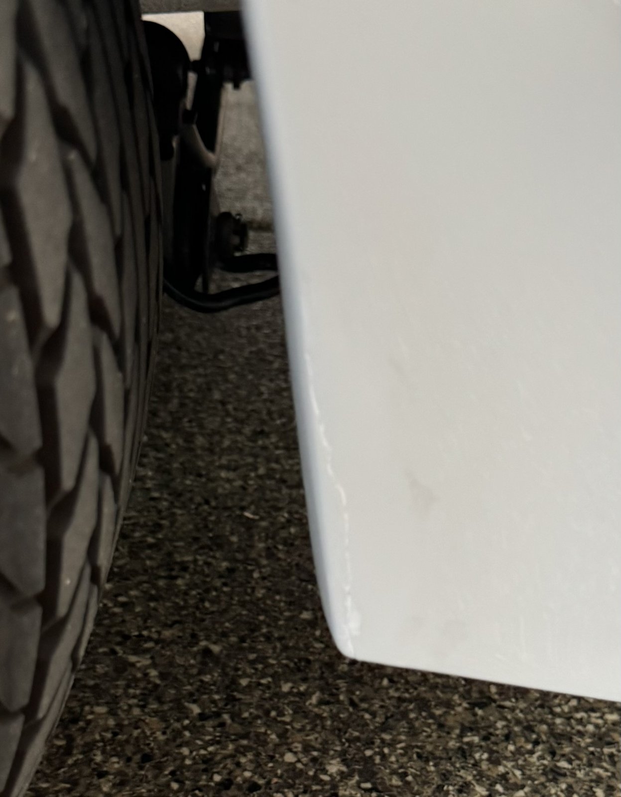

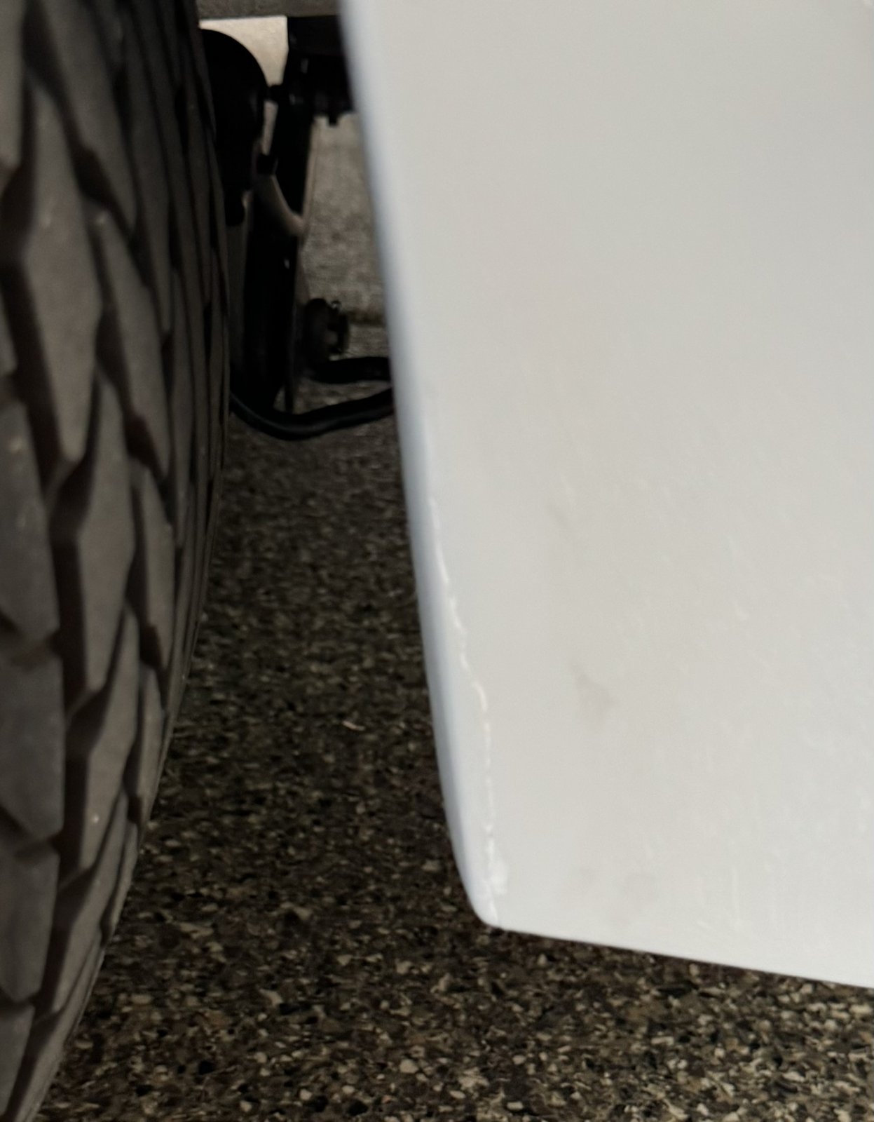

J-B weld two part epoxy in syringe https://www.autozone.com/sealants-g.../p/j-b-weld-autoweld-syringe-25ml/1265970_0_0
Seems to have done the trick. It dries white so almost unnoticeable on my paint. Light sand with 1000 grit wet/dry.
When I do more extensive body work this will be properly filled and painted.
For now, it’s a good quick fix without having to take air dam off and risk doing even more damage.
