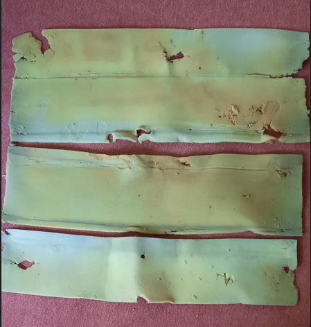

this picture shows the three pieces of foam, the thickness is 8mm.
The sizes in cm are
104x42
103x28
102x22.
Of course, after 50 years it starts to dissolve. Anyhow, I would use same type of foam, applying adhesive spray.
Regards
Thomas
