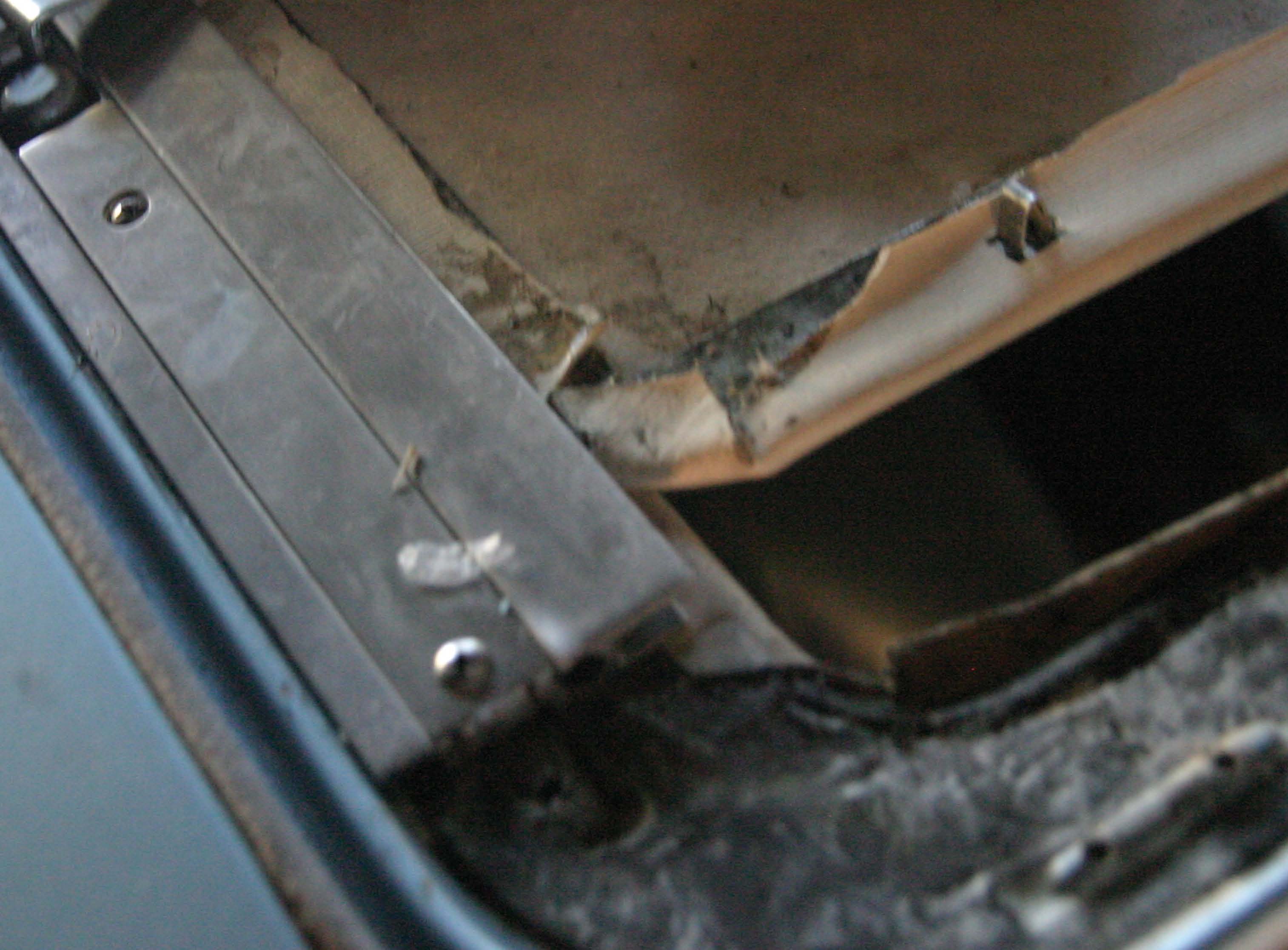

Left picture. Once you removed the SR you will see this (Passenger side). Right picture. Remove the small aluminum insert, about 5 inches long and 3/4 inches wide, held by two screws. You need to do this only on one side. Pass or driver, your choice.

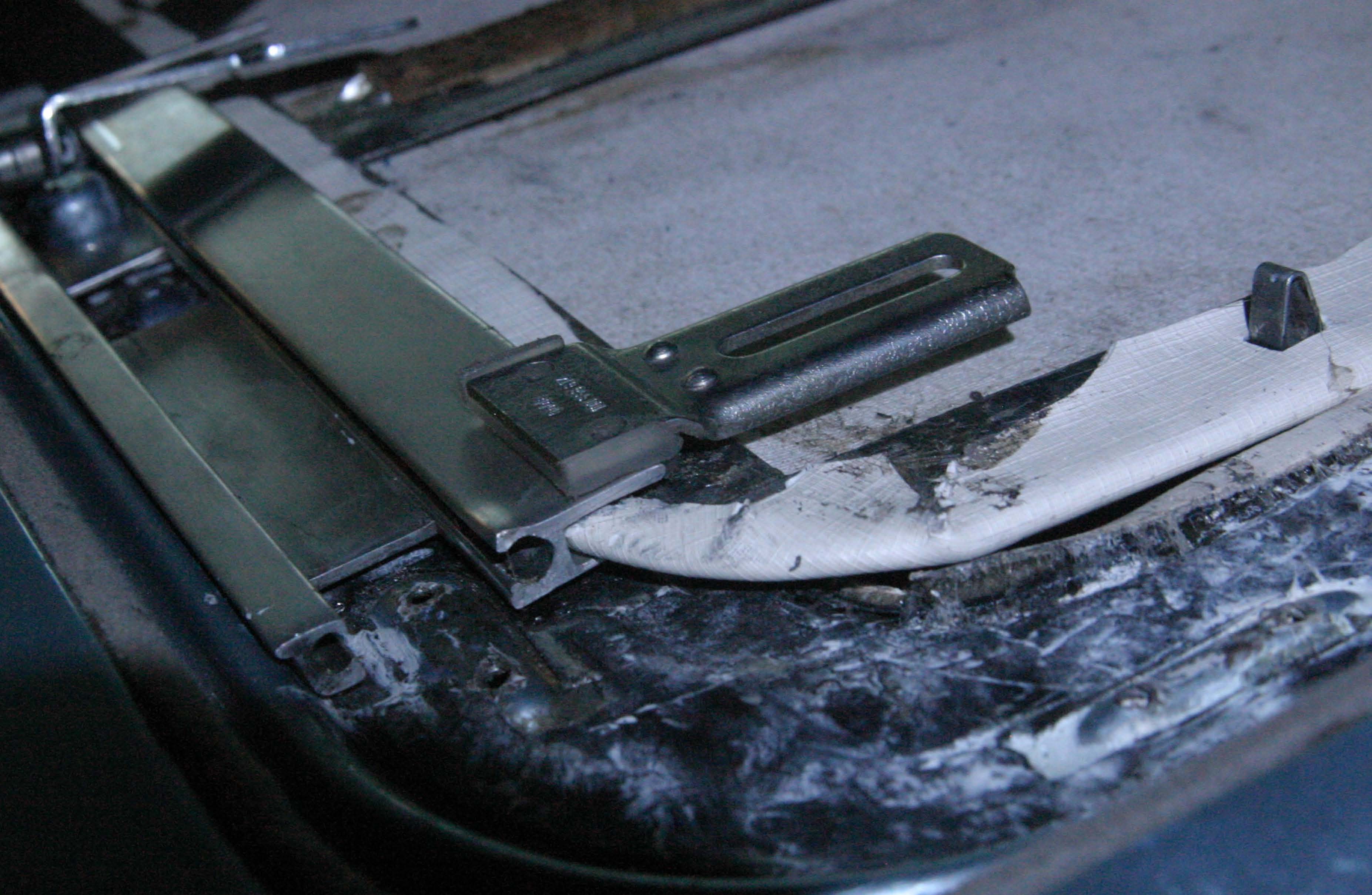

Left pictures. Lift the SR guide. You will see a groove. This is the groove where you will slide in in the sunroof liner. But first slide in the SR lining on the other side (the fixed SR guide)see right picture. NOTE: my sunroof bracket holding the lining will not look like yours. The PO lost the SR lining & bracket so I had to manufacture my own.
Left picture. Another view on how the SR lining fits in the groove. Right picture. Manually push the roof lining to the back making sure it is in both the left and right side grooves
Left picture. This is the position your SR should now be in. Right picture. You then carefully reinsert the SR which should then look like this from the inside. You can now screw everything back in but you will need to push the sunroof up a little in the back so you can align the holes for the screws after you reinsert the plate I mentioned above.
Left picture. Note the square holes. These are used to secure the roof lining/bracket to the sunroof in the front so it slide with the SR when you open it and close it. Into those holes go the clips shown in the right picture which should already be attached to your SR. What I say here is a pure guess because as I said above I do not have the original suroof Lining/bracket as mentioned above. I cannot think of any other purpose for those holes
I'm note sure but I believe this part is used to secure the SR lining/bracket at the back of the sunroof. Note that it swivels and is springlike. Again, not having the original bracket this is a guess. You will need to figure that out.

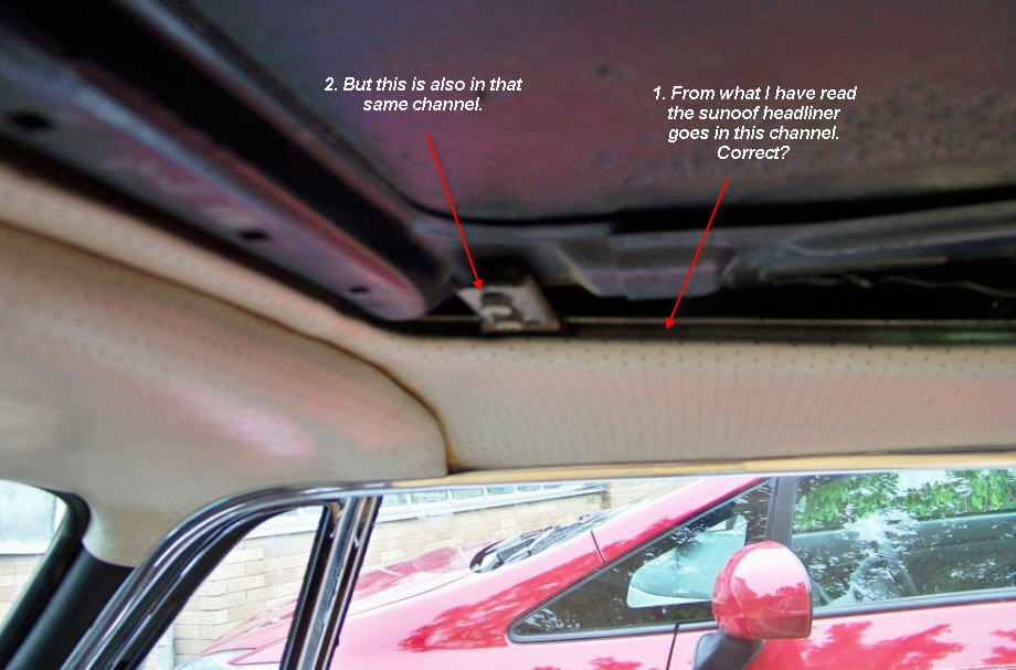

Sunroof headliner problem photo
I'm adding a photo to the file to show the problem I am having trying to reinstall the sunroof headliner. My original question was: "Do I need to remove the sunroof." Seems like the answer might be 'no.' But how does the headliner interact with the guide (P/N 54121815144 in Mobile Traditions) that fits into the guide rail channel? Seems like 2 things in the same channel. Please see photo.

Jim, see my edited post on this subject. To answer your question above, yes, they both go in the same channel.

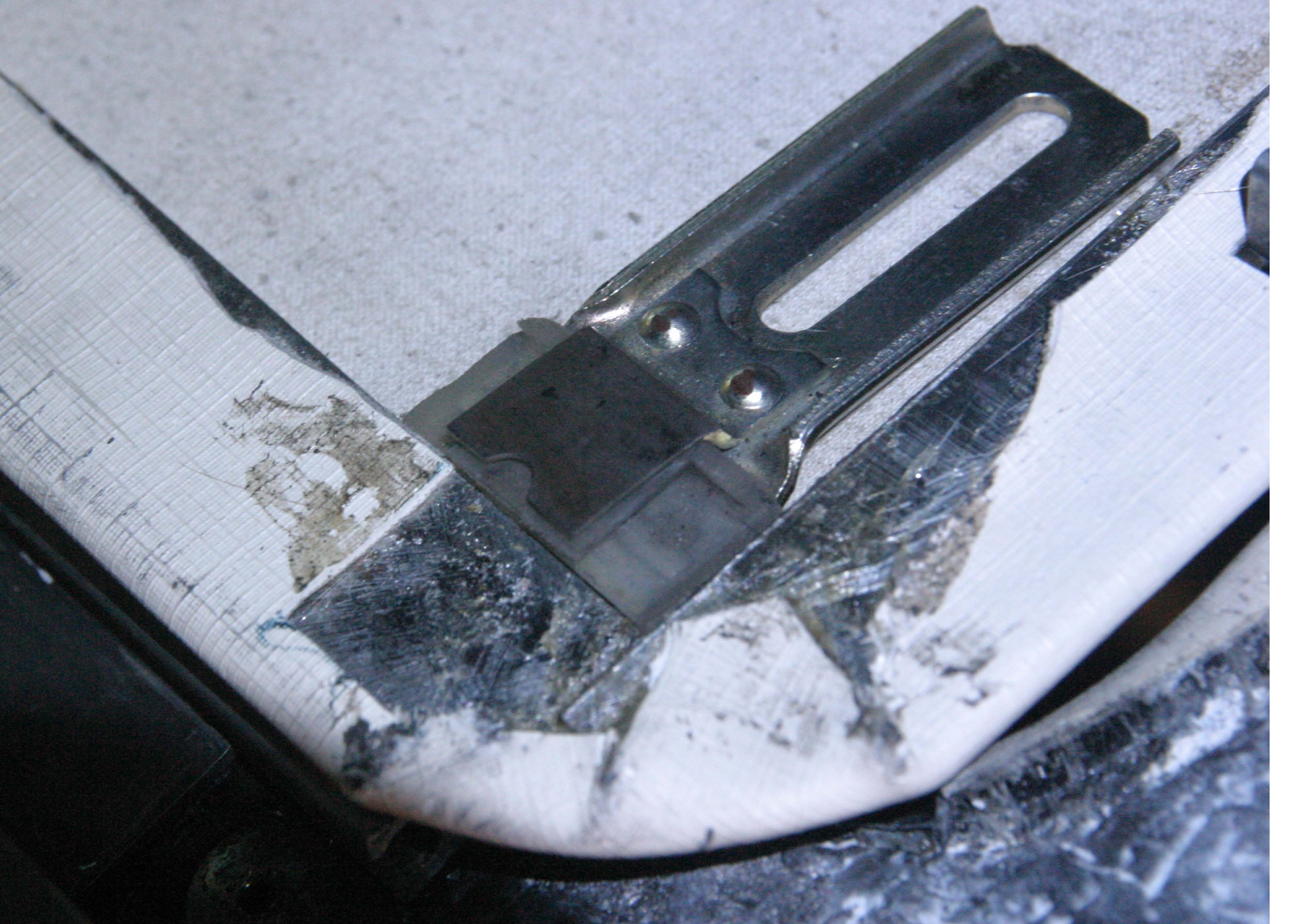

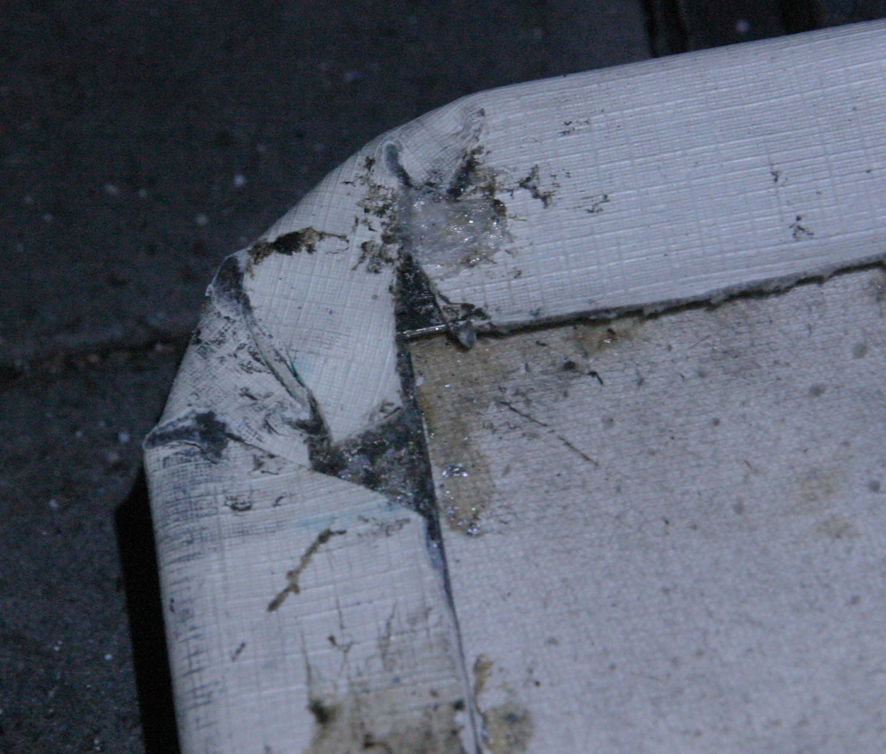

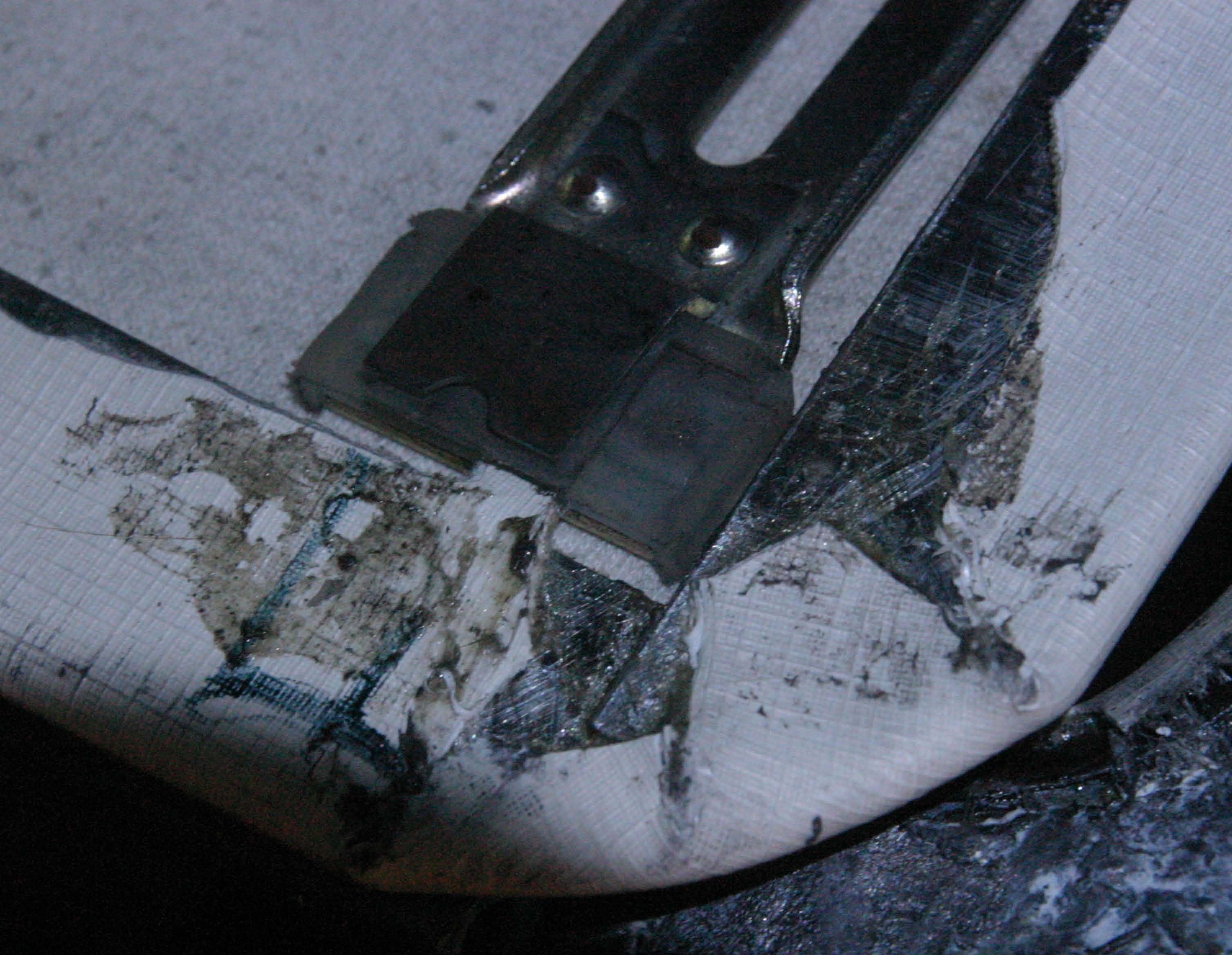

SO I COULDNT WAIT
THE first thing to do is make sure the corner wraps of the cover on the frame dont overlap
mine were on top of each other and it makes that part to thick to slide smoothly
so after restting that then the bracket is at 95 mm to center line of the unit
so i lined it up and removed the top material of the fabric where it is going to sit next to the frame
once it was removed and set in palce
IT DOES SLIDE EASILY --SO TO SPEAK
so that is the best way to resolve the problem
also - its imperative to use woths rubber glue to secure the fabric as once it sets it wont come apart again
even on a super small section as you can see on my panel
one other thing is you can set some thin white grease on the edges as it is well covered and
i just tested it --IT SLIDE SUPER SMOOTH
