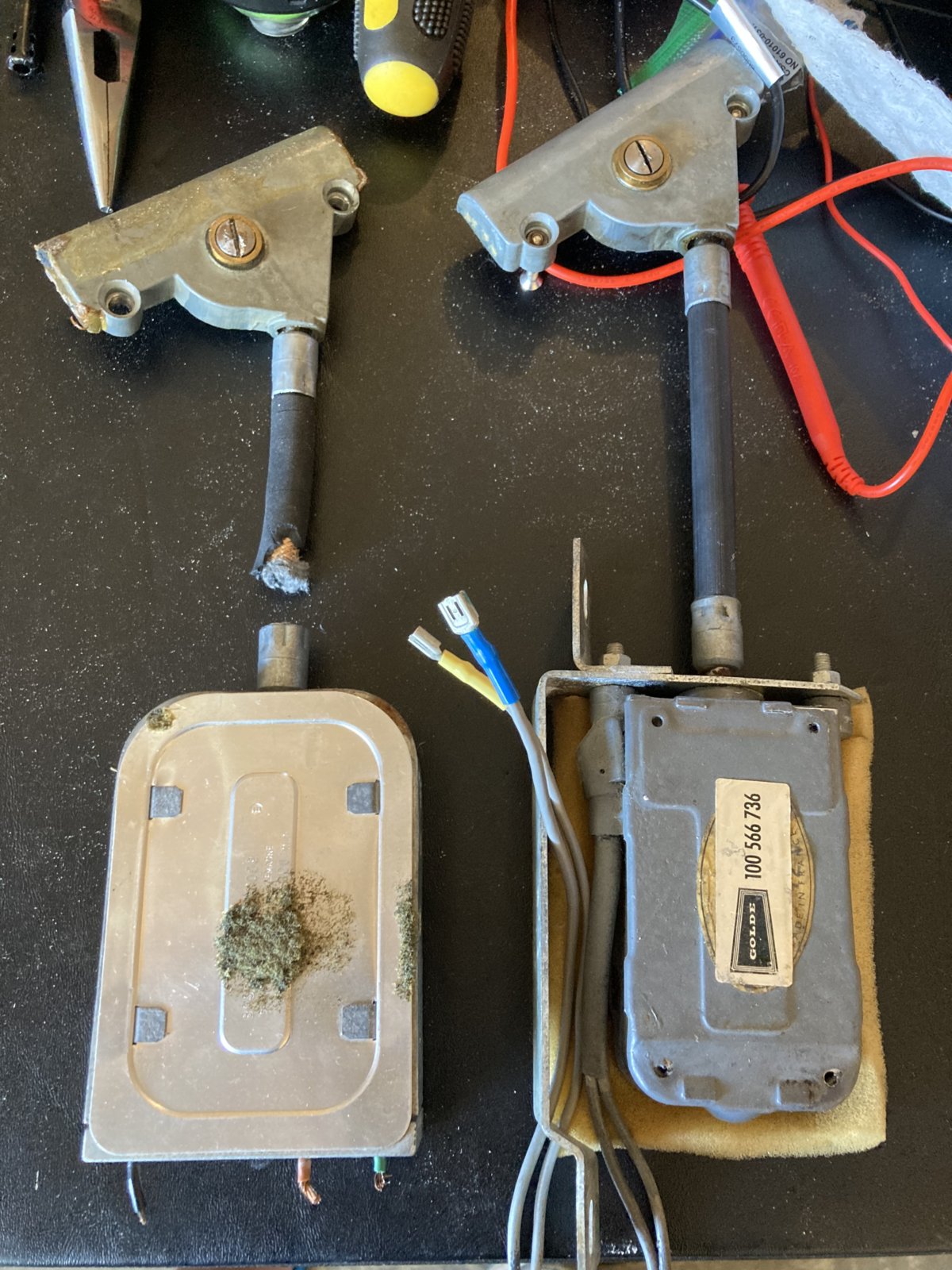

Before I pull these apart to move the Bowden cable, can someone assure me these are the same motors internally. My Bowden cable failed and I am looking to simply switch it out. Also, the original motor has three wires, one being a ground to the frame. The second motor has two wires that I think alternate being “hot” — so I am thinking that motor requires a different switch. Appreciate thoughts. I have read the existing posts which I so appreciate. One specifically states these two motor are exactly the same so I should probably already be pulling these apart.
