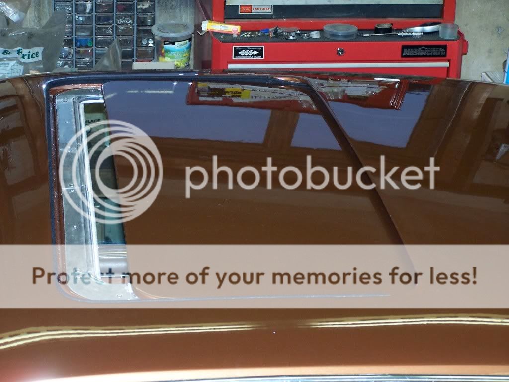

Here is a shot...hope it helps. The best advice I can give is to head to your local Volvo repair shop and look at a 240 sunroof sedan. An '84 was the example I followed. Tough job and about impossible to get perfect. Best of luck to you.
Thanks alot.
The Volvo 240 point: that they had the metal "bullets" instead of currently available in grey plastic?
Good view of the front seal, and how the ends are bent down, BUT: how can you get the rear ends to join in a nice, flush, straight way, without cutting them in an angle to meet the front seals that turn down in a curved manner???

If you look at Pamp´s picture above
it is clear how the ends of the front seal are tucked down. Fine, but how do you match the ends of the rear seal to make a perfect fit when the sunroof is closed?
At a corresponding angle forward. Doubt it, but it would work in theory.

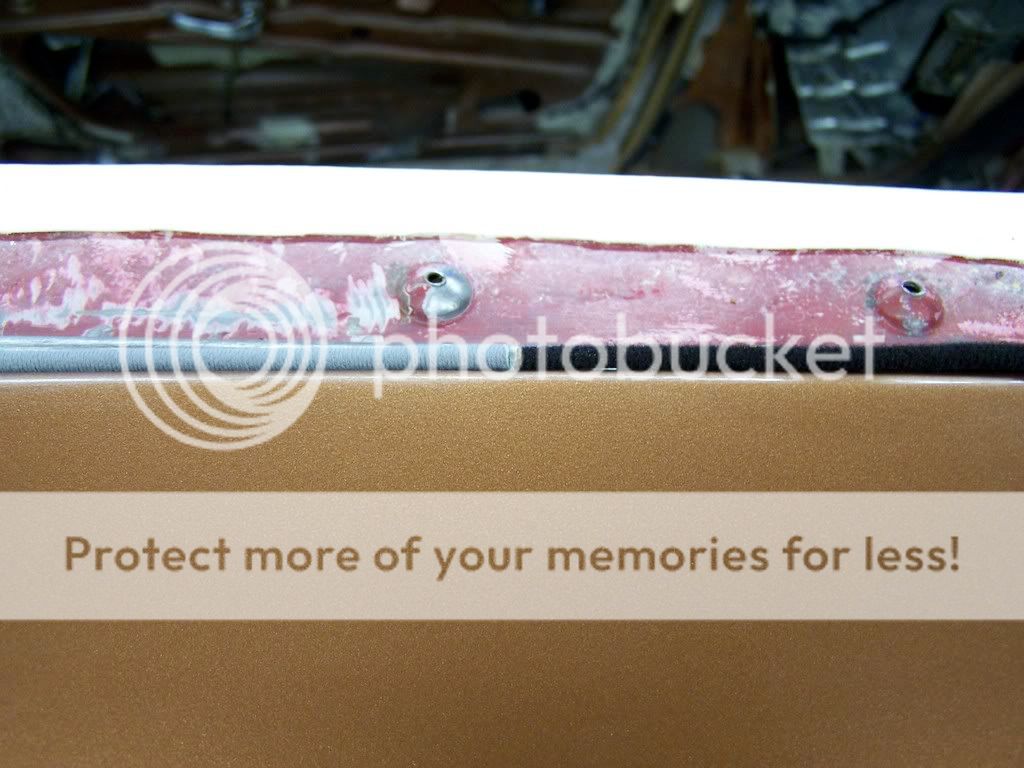

I would use a well established independent Volvo repair shop. Again, the example I used was a 1984 240 GL sedan. Felts also ordered to this spec. on-line for I believe $80 for the set if I remember correctly. I still have the OEM set in gray, I preferred the black. Also the Volvo material lacks the metal backing, making the job easier. Wurths Rubber glue is the way to go as recommended by Carl N. The previous felt install on my car was a hack job and they were pop riveted to the body! Extra work to fill all the holes, for sure.
Here is a shot I took to compare the colors (note my car is pretty much in tear-down mode at this point)
