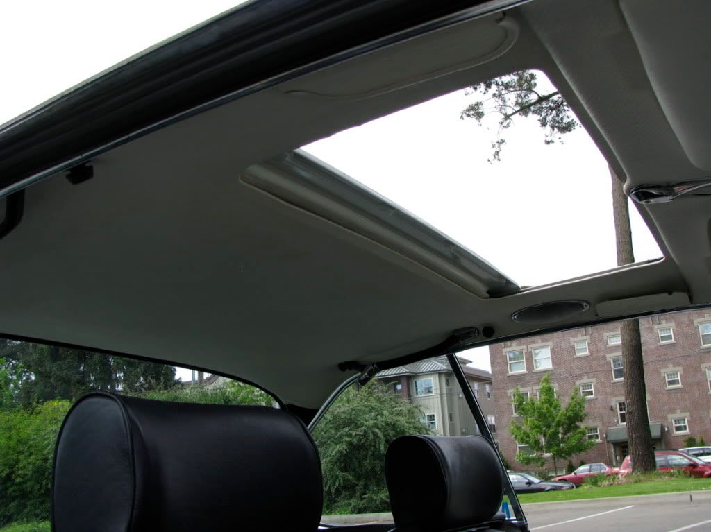

The Roof
Sure looks like a factory roof to me (Golde?) My guess would be that the entire roof came from a donor car. Manual crank to boot, which is nice. Spent many hours on the refurb of my own roof (electric) and it still needs a little help for the final "pop-up" There are other forum member owned cars out there with after market roofs. (decoupe?) who could give advise. Oh, and life long exposure to welding (flash burns) haven't helped my vision either. Gotta love the new auto-dark hoods...best invention for welders since electricity!
This car is supposed to have had a sunroof installed after it was sold.
The ebay ad reads: "The next owner was Steve Jensen who moved the car to LA. Steve put in a new transmission and sunroof in 1982".
I interpret that to mean that the car was delivered from the factory in 1973 with a sunroof, then over the next nine years the original one rusted/broke, so Mr. Jensen had the roof repaired/replaced in 1982. As Pamp wrote, from the ebay photos the sunroof certainly looks like an original Golde - if it was added later, the addition involved welding on a roof clip from an OE sunroof e9 - not sabresawing a hole and pop riveting in something aftermarket.

Roofs
Indeed...The archives do not show the options on the cars as shipped, so a guess. I looked at all areas on my car and concluded that the sunroof was original. A very good body man could fake a later install and make it look as an original, but that would be an expert for sure.
