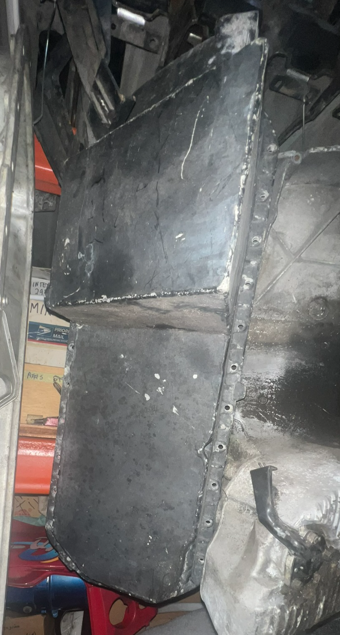

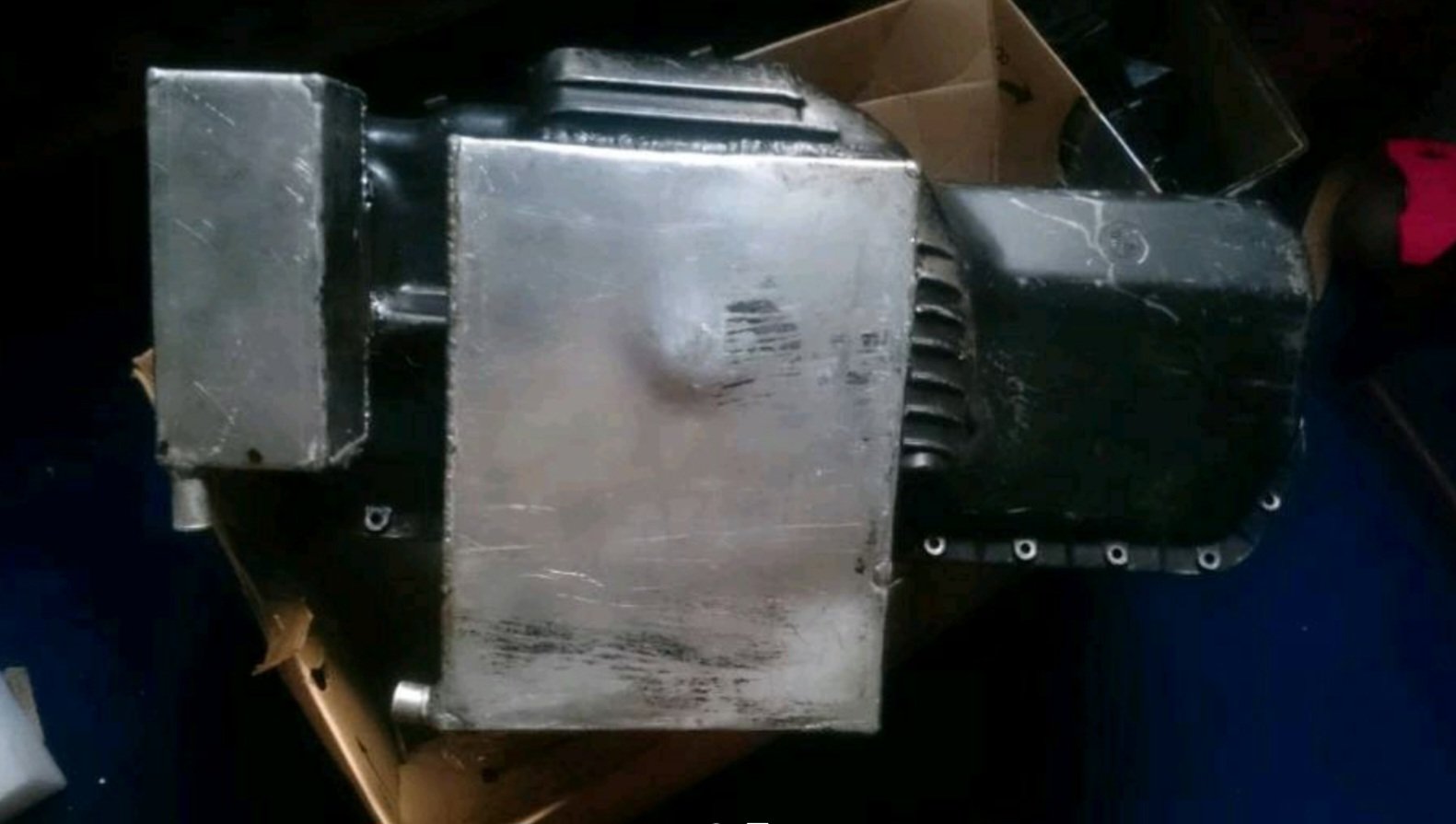

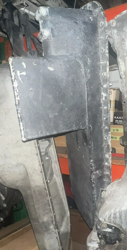

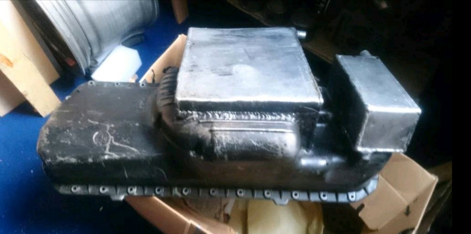

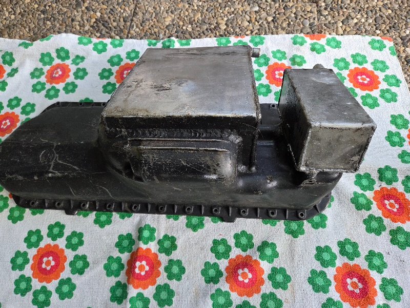

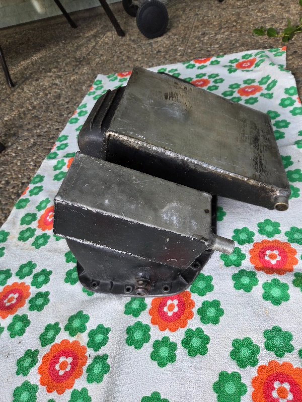

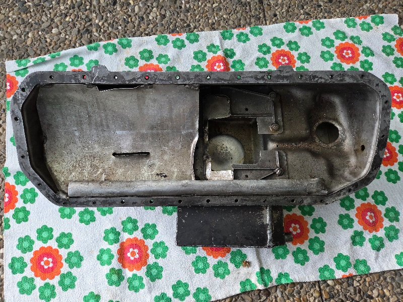

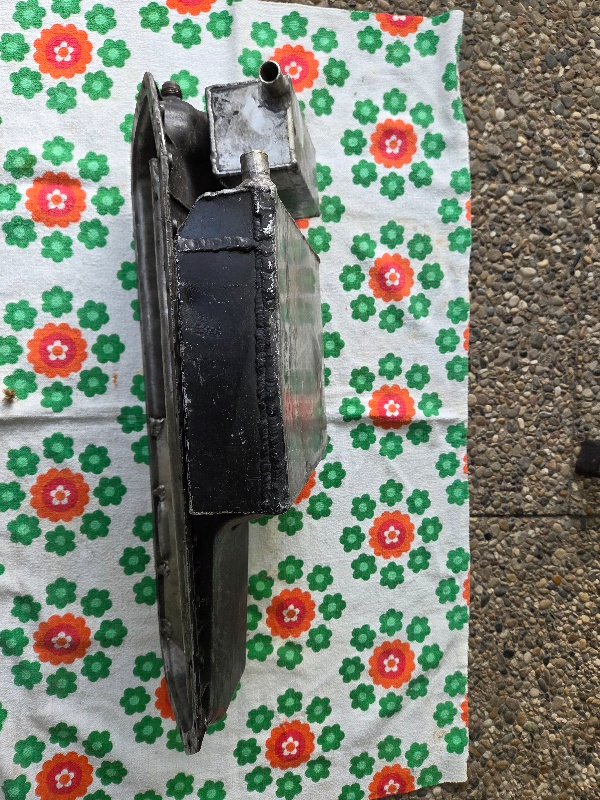

I would be very thankful for your expert support on identifying the M30 oilpan / sump displayed below.
Does someone know of other similar oilpans and where they were used?
I will be happy to tell you with which parts it came and share the little knowledge I have about the parts, but do not want to bias the discussion from the beginning.

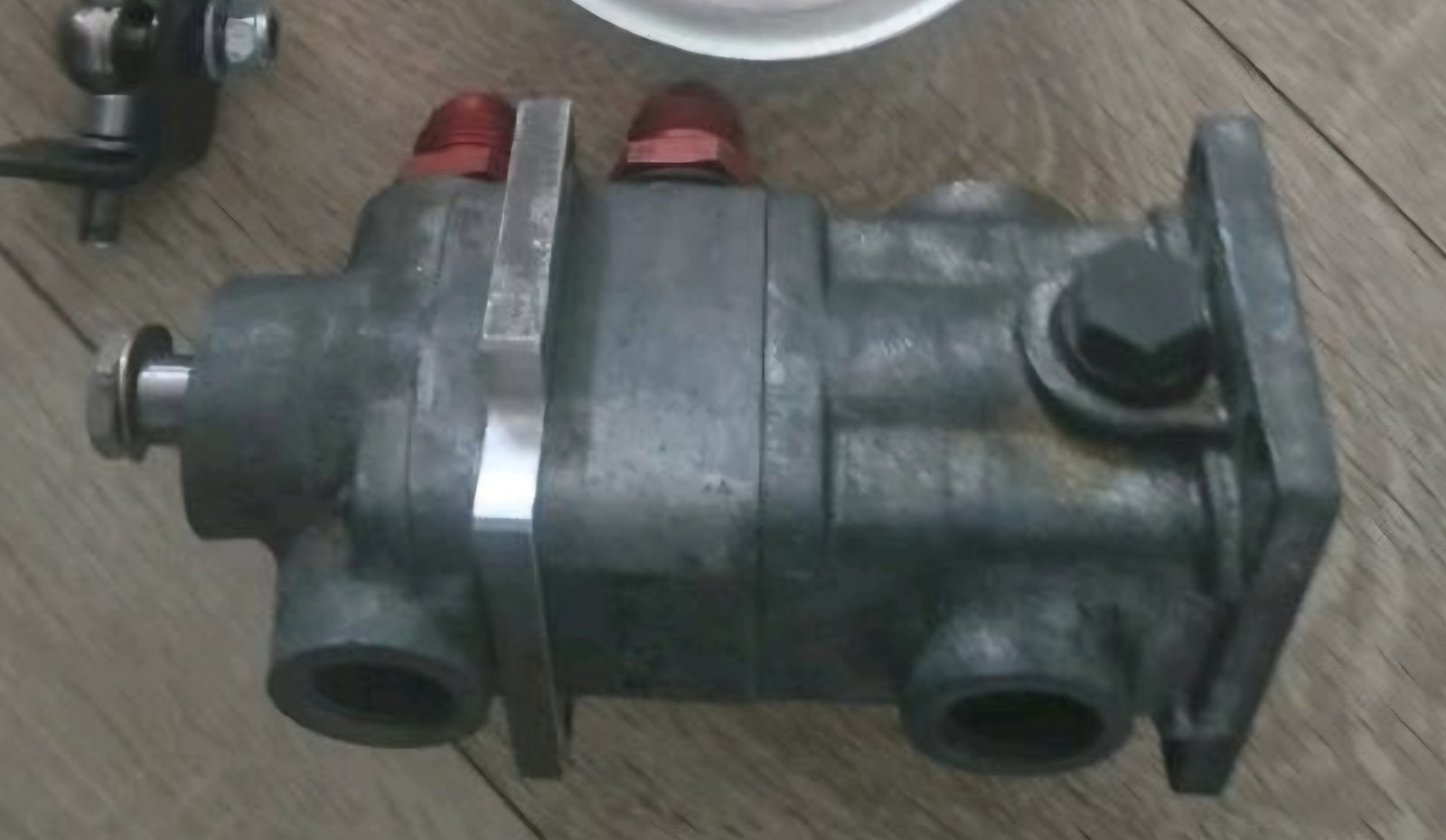

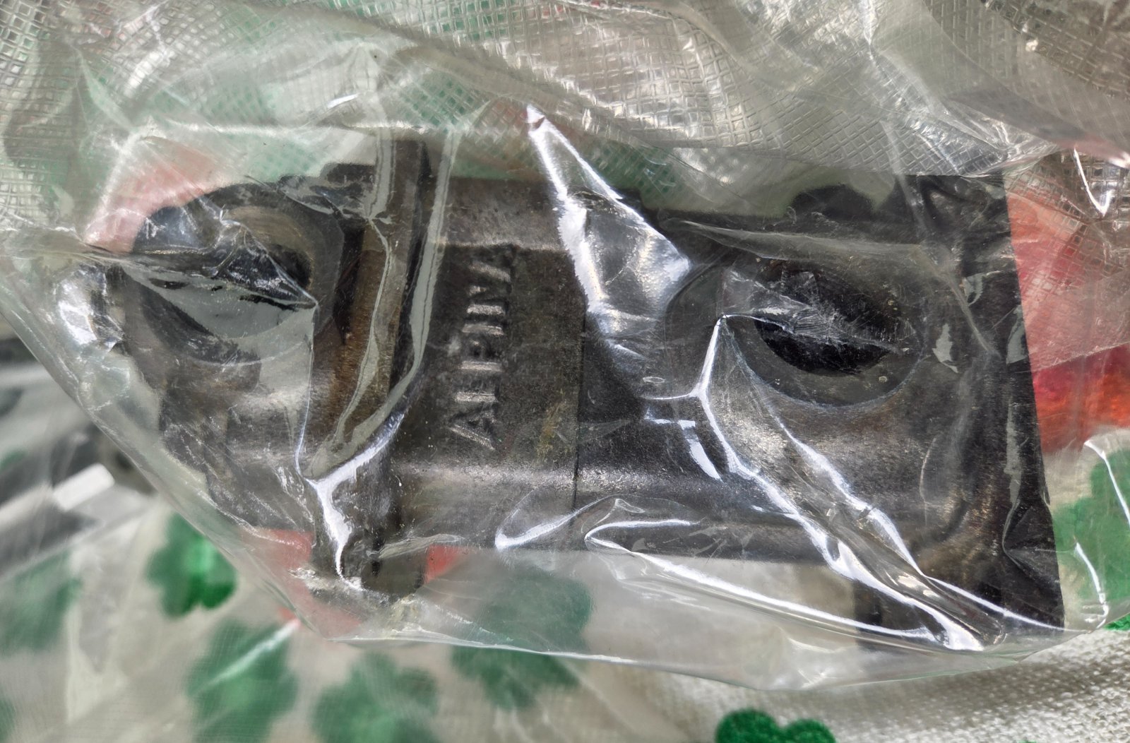

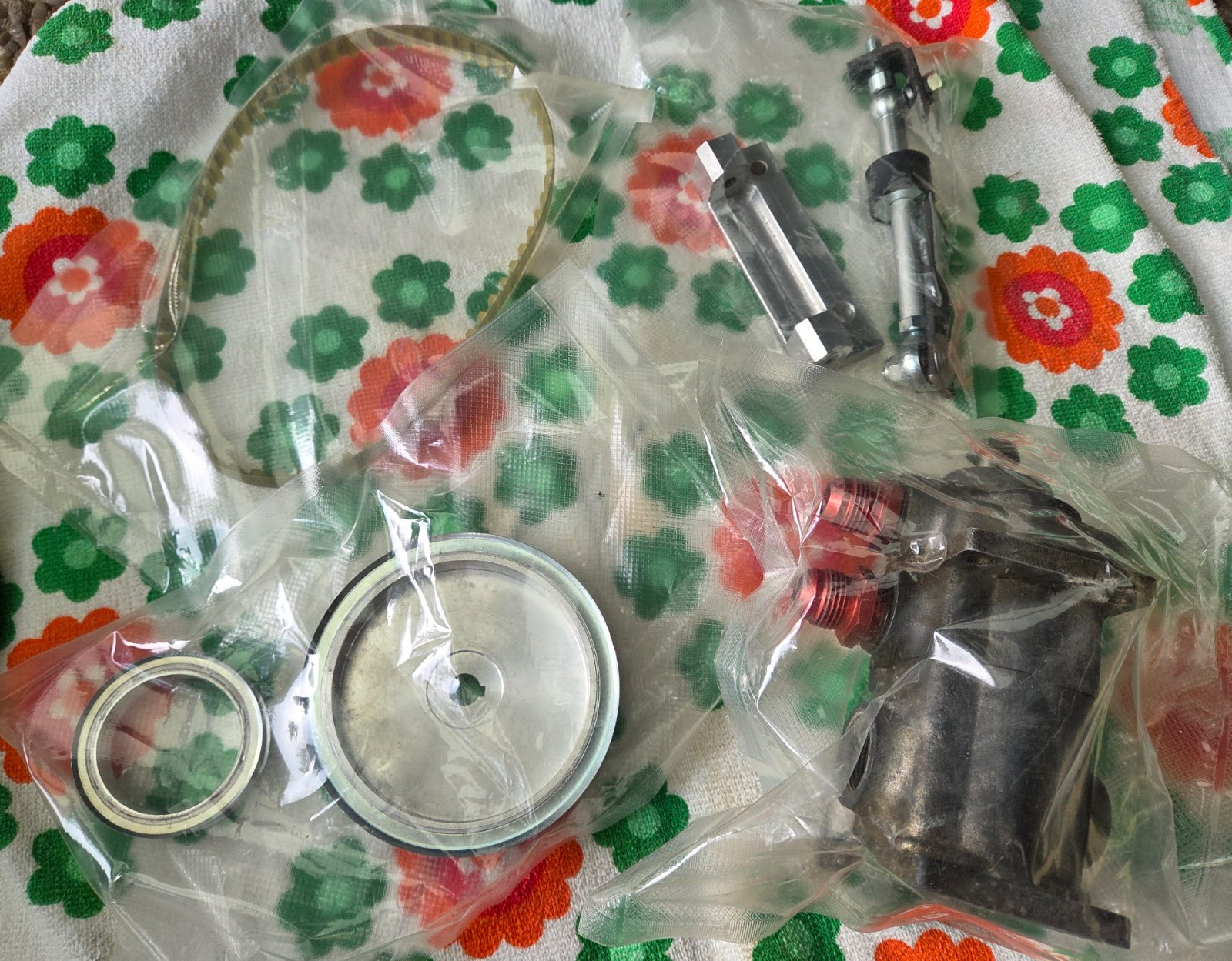

Alright, not much direct feedback but with the support of a very friendly expert here on the forums I have been able to verify from a second source that the pump is very likely a genuine example of the homologated 3 stage drysump pump in Alpina version, so externally mounted on the exhaust side of the engine. I also got the mounting parts.
Photos from today, parts are wrapped for storage currently.
Also got the lines and tanks.
So, I just still wonder how this fits with the oilpan, as it is definitely not like the works pan and does not look like any drysump pan I know. More like the oilpans with increased oil volume and internally mounted pump...
Also during the semi-dry period they used internally mounted pumps as far as I know. And I never saw a picture of the semi-dry pans anywhere...
And the pan clearly has the fittings for the oil lines.
Cheers, Dan

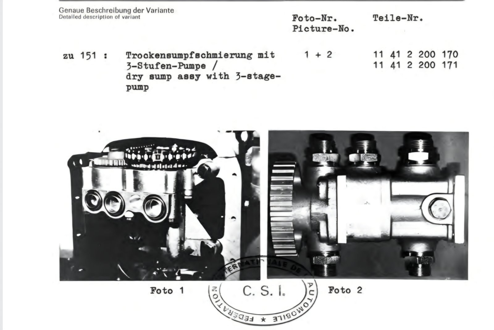

It is not a problem to get FIA homologation sheet 1648 - however, it seems like only the pumps were relevant for homologation. There are also pictures of the internal as well external version (and the later pumps also):
But no entry for the related oilpans...
Or do you know about additional homologation papers?
Kind regards, Dan
Edit: and know that the Works pans looked different. The one I have rather looks like the wetsump ones modified for larger oil volume. I just try to sort how these two different technical approaches fit together. Maybe I need to dive more into literature on that subject...
