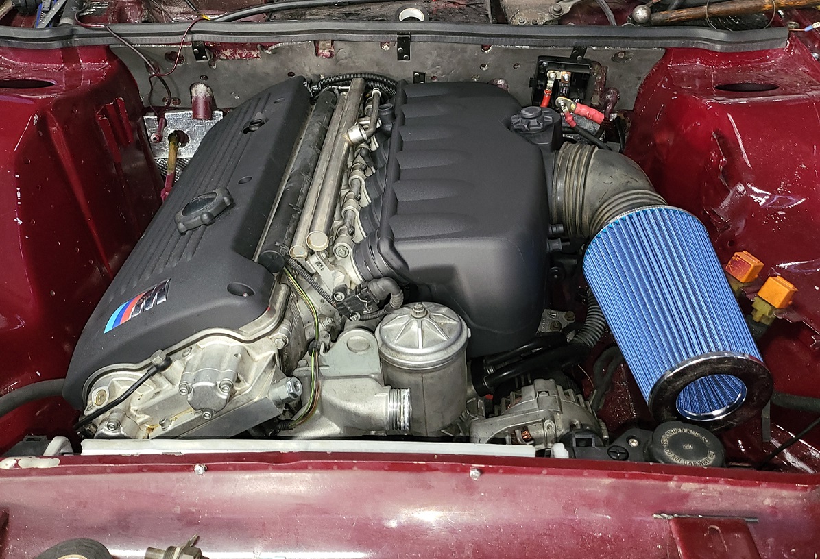

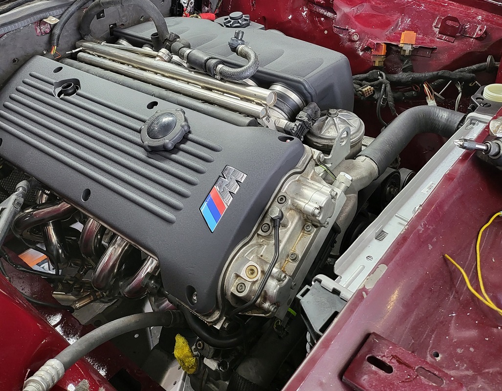

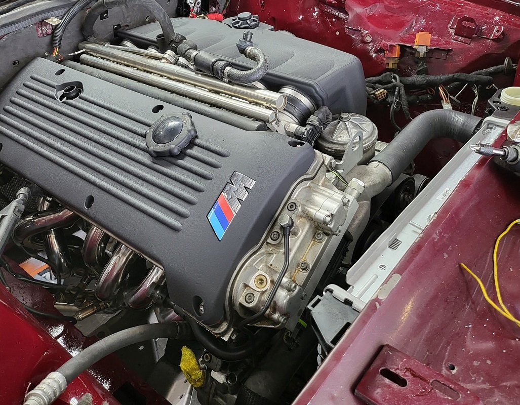

I take care of that that was easy part I cut the pedal box short booster pump is very close to fire wall and cut part of the box and molded with fiberglass it look original and it worked perfect but that was 5 hour job and today end of the day we start it and works like it should and pay all that hard work I was afraid oil pump not going to work since we use deferent type of oil pump But worked with no problem today was my happy day with big happy face, but I can not drive yet there is no front end and drive shaft and the break system I have to upgrade the break, but I didn't figure out what we use yet I have to take care of AC first before we move to front end and break system I love this engine it look like made for E9 just check the picture
just check the picture you can not see the booster or master cylinder and more important and challenging was wiring we took big bunch of wire from back of engine to inside under the dash as you see is one clean engine there is no wiring around it and that was more challenging than box and the booster pump
