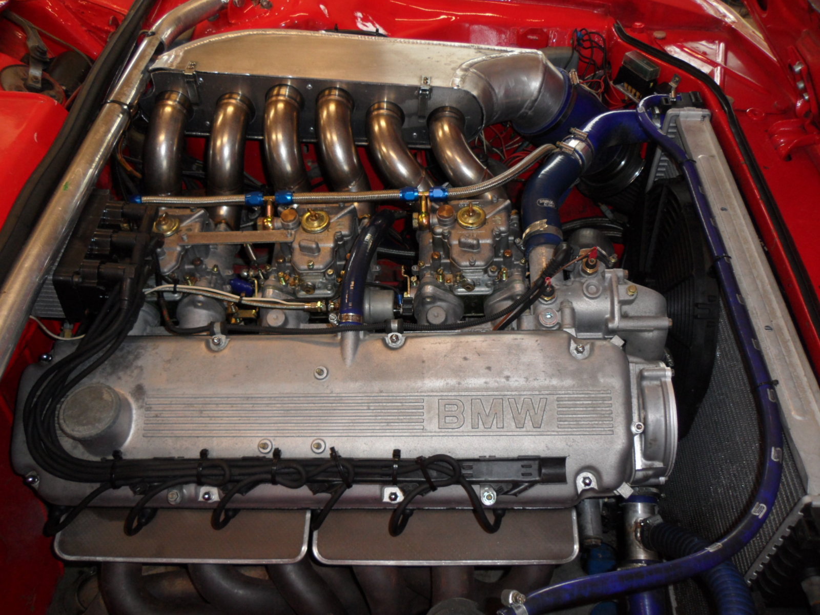

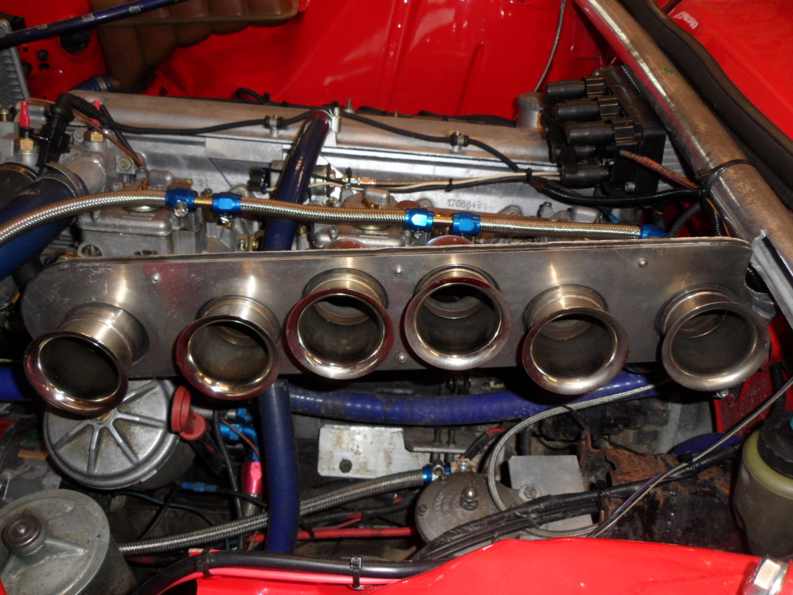

Johan, HP was the same , but we went down from the oem "300 NM" to only 240 NM torque !
We had to build longer inlet tubes ( and at the same time a air box and filter) to get again the 300 NM.
