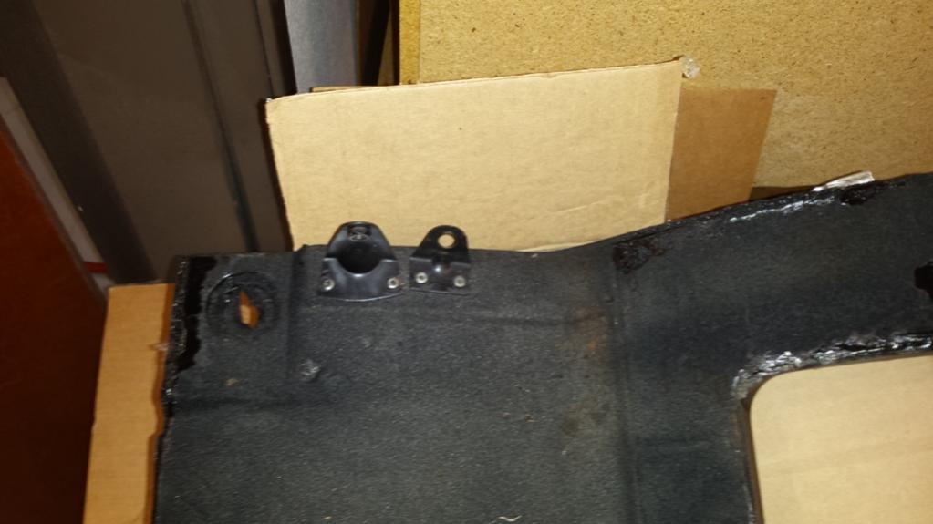

My cable still has the bracket on it, together with 2 broken-off rivets... The thing just dangles there. I don't see where these rivets were attached to the under dash.
Do you maybe have a picture of where it's supposed to be?
Here you go!
might be tricky re-attaching it-
nope.but I think there is a metal plate in the dash piece so you could drill in and use a small pop-rivet. should not be seen from the outside-
