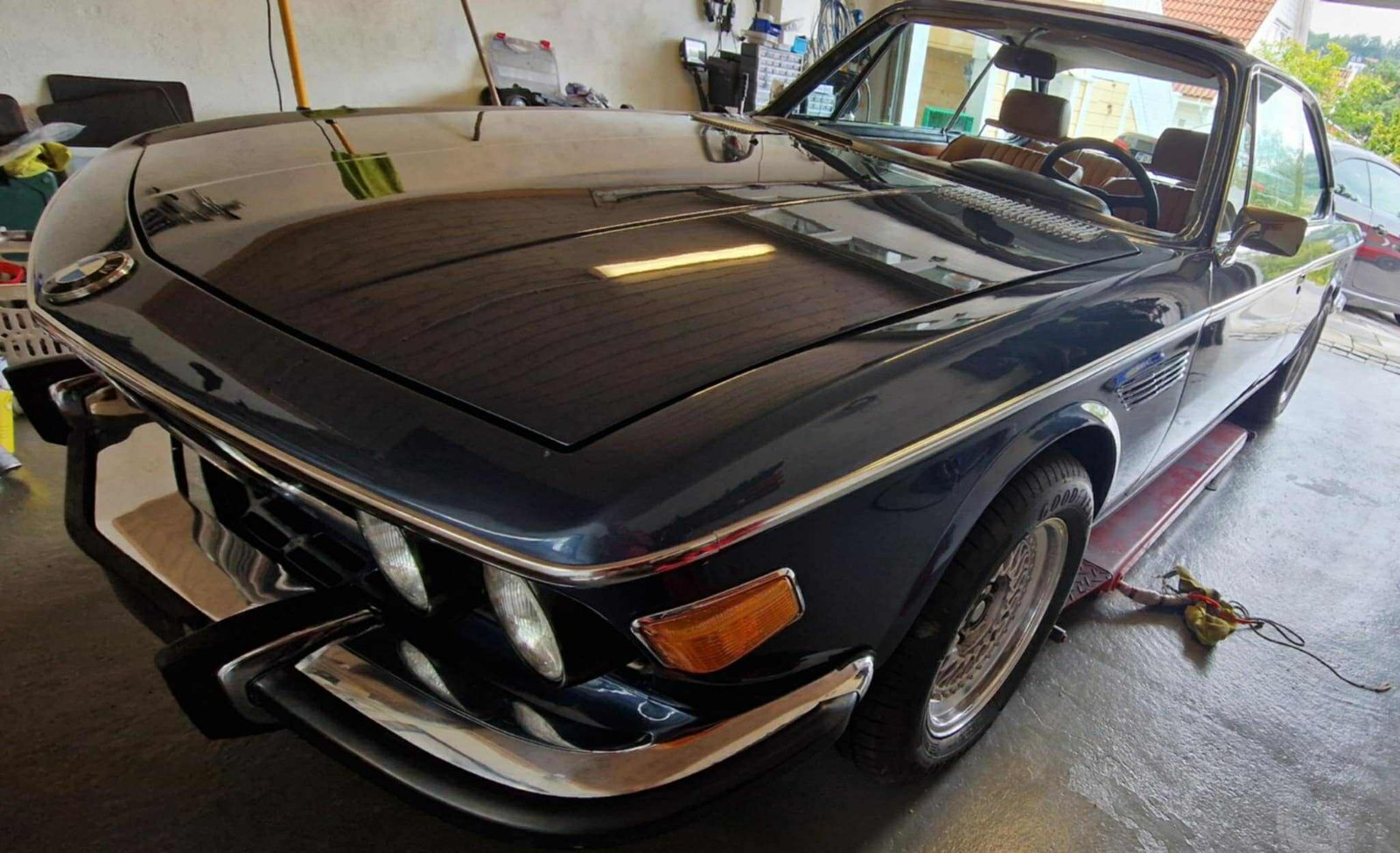

I have a Bmw 1969 E9 2800 cs that I have installed a Bmw 735 I engine from about 1982,it has motronic 1.1.
Have also a 5 speed overdrive gearbox.
I have had the car since 1980, and it have stand still in 29 years now, but now it is nice and restored.

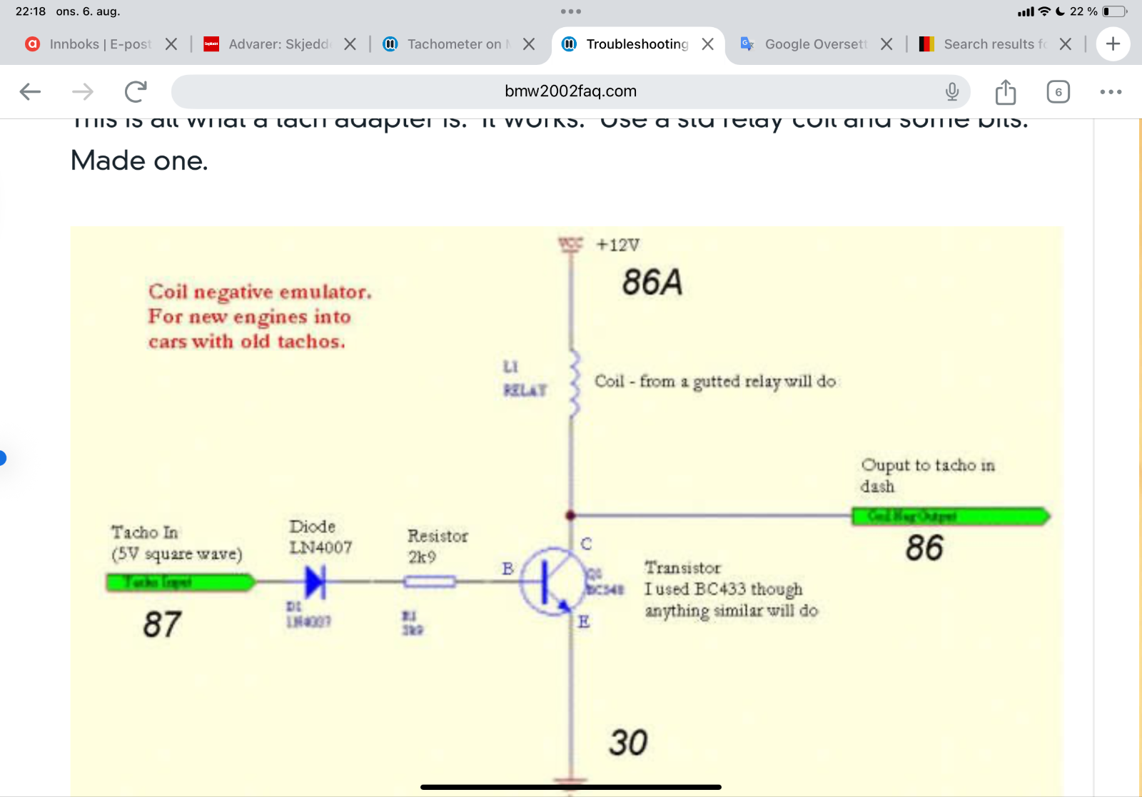

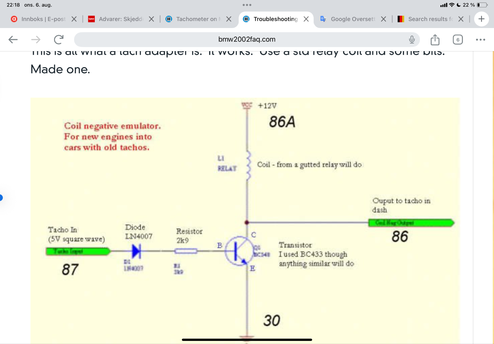

The problem is that the tachometer does not work properly.
It can probably break if you connect it directly to the coil's minus pole I have heard.
Therefore I have made a small circuit that I found on the Bmw 2002 group, see the pictures.
But, the tachometer shows a bit too much at idle about 1500 and it jumps a bit sometimes.
Does anyone know of an adapter that I can use and that works?
Mybee I made the circuit wrong.

i will start with - i presume you have checked the grounds at the instrument cluster ... that is the biggest cause of gauges not working correctly, that aren't mechanical in nature (like a speedometer / odometer).
on the coupe, the black wire that comes off of the back of the tach - goes straight to the tester plug and then to one side of the coil. what i don't know is if there is any difference in the way the car is wired for motronic 1.1. i don't think so, but not sure.

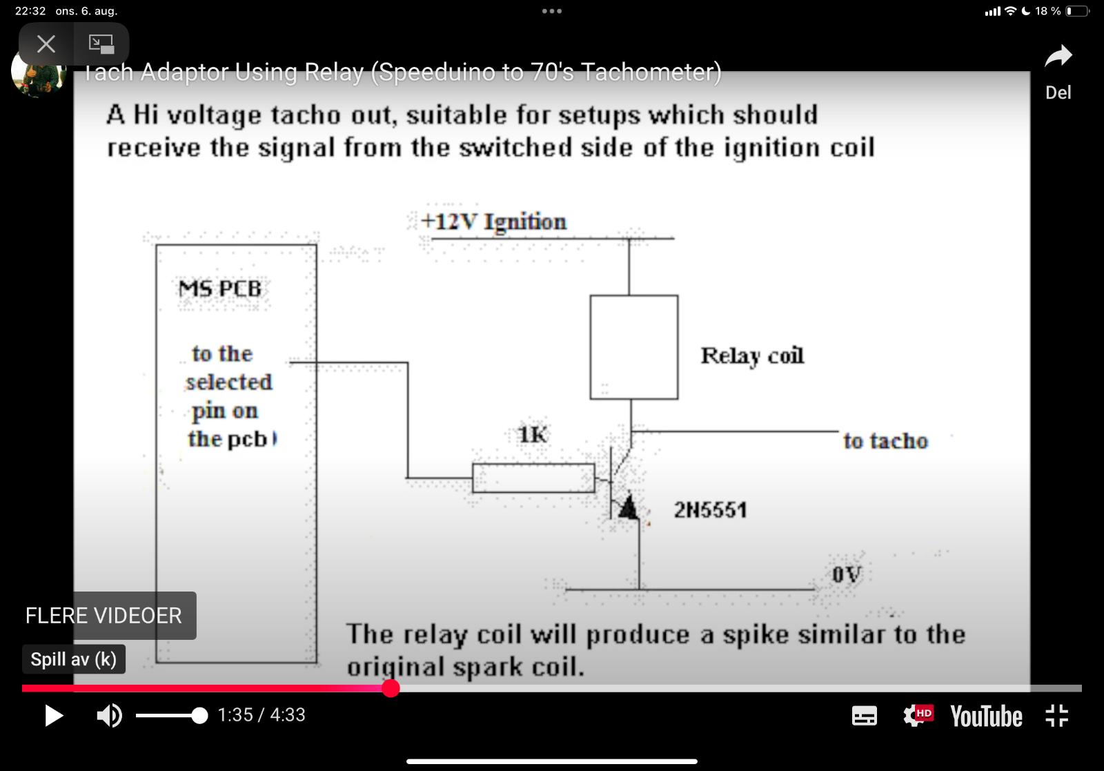

See video where ->Tacho attached direct to coil.
After previous engine start the needle was hanging on1600 o min.(Possible residual voltage that makes it).
And it is not working correct, mybee grounding problems as rsporche said.

I have never had an issue connecting direct to coil negative. My M88 swapped car still runs original motronic 1.1 and I've no issues with tach being on coil negative. if possible run an extra wire and have tach removed from the vehicle with direct power/ground/signal wires to rule out wiring issues. If you have a good known spare tach/coil swap those and see.
I have done dozens of cars.
All the same.
Direct wire from - on coil to tach.

Thanks for the reply.
Tested my other tachometer loose in the engine compartment and it worked fine.
Connected to the newly overhauled one in the car, it hangs up and is slow sometimes.
I took it and banged on the glass a little then it dropped down to the correct speed.
so I think the grounding is good, it's the needle that's a little slow.
It will probably get better as I use the car.
Now all I have to do is get the new windshield installed, it's probably worse.
