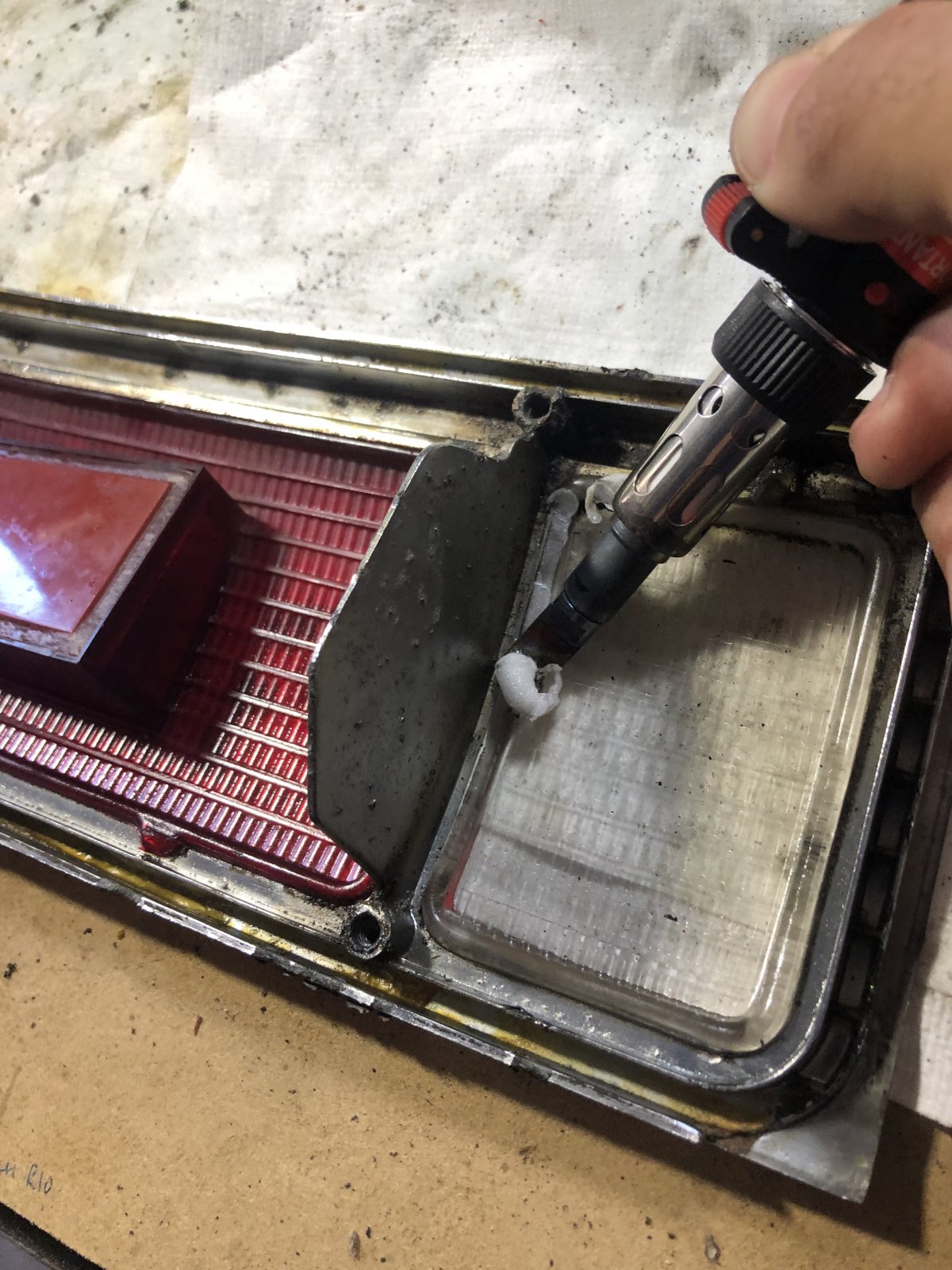

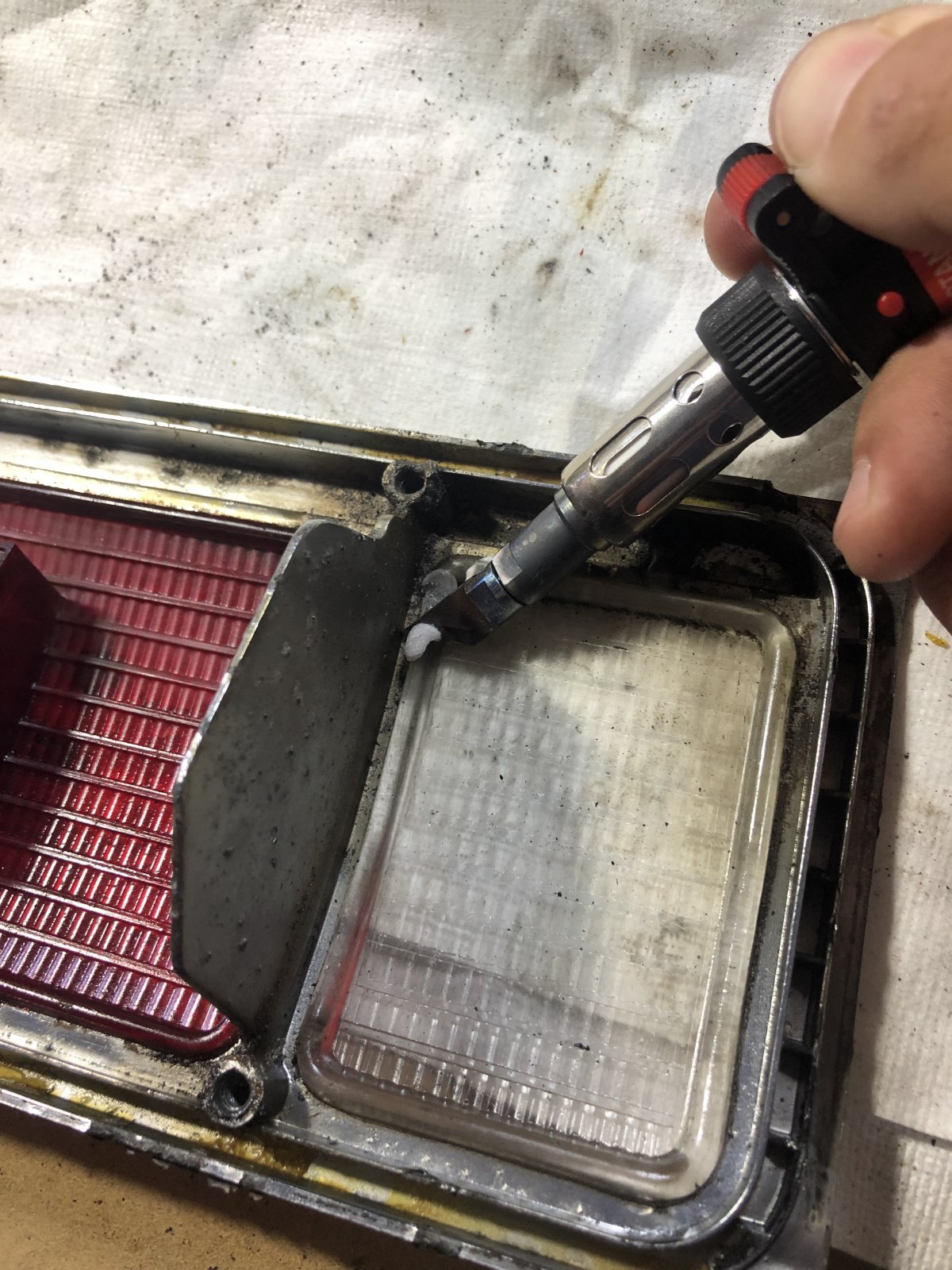

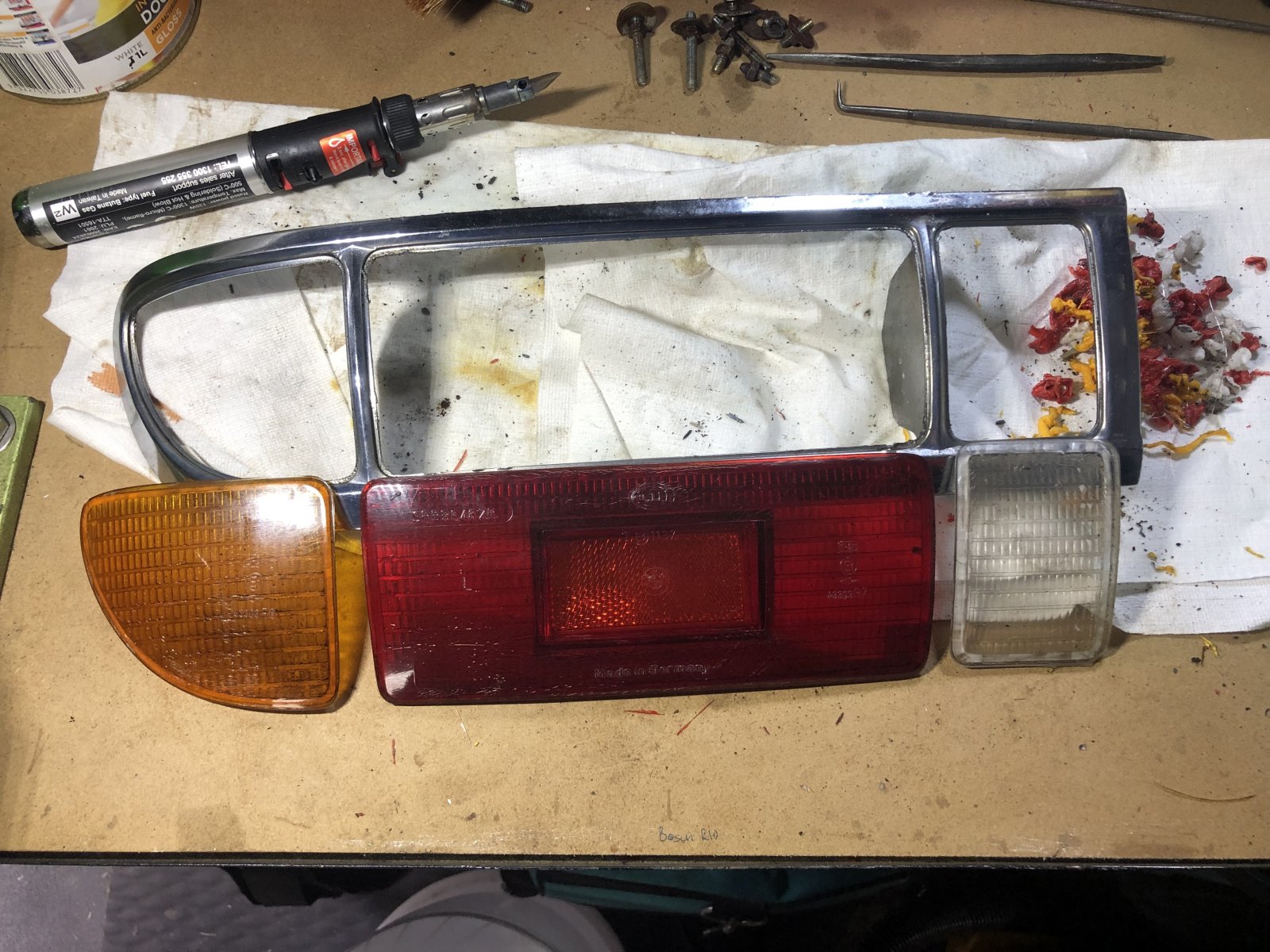

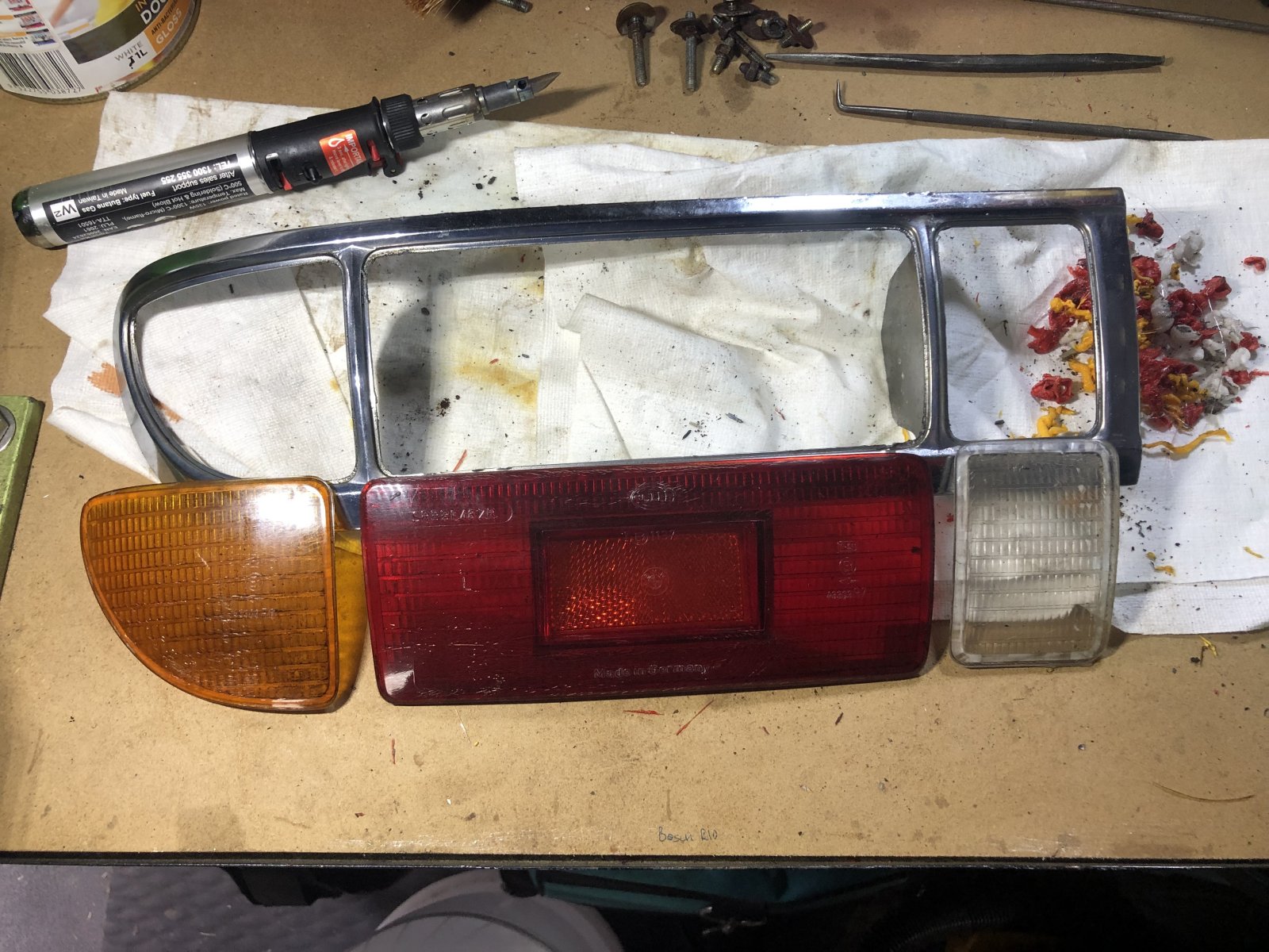

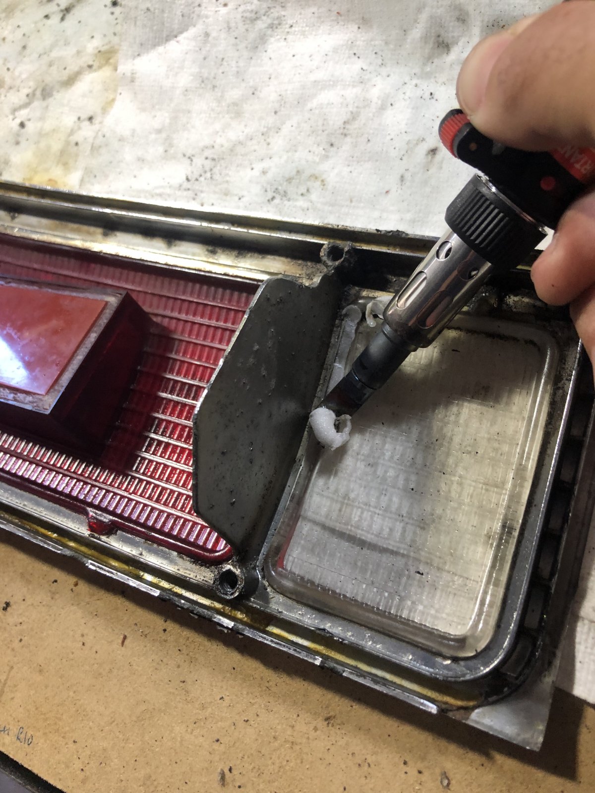

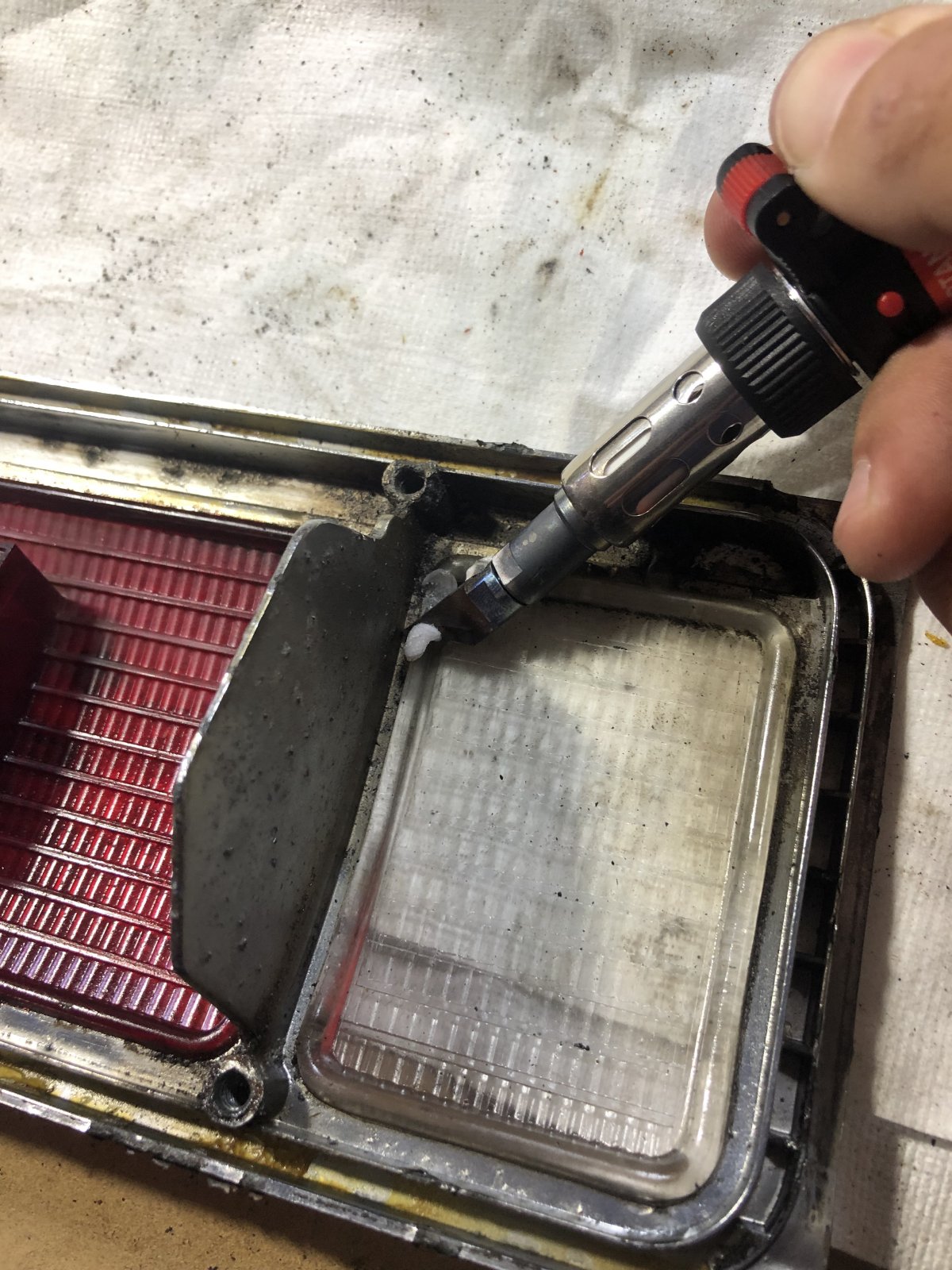

Hello all, How can I take the tail light lens out of frame, I want to re chrome the frame then glue it back, I will be appreciate if any one can help.
I recently did this. If you use a butane soldering iron with a knife tip it works really well with a steady motion.
The key is to go slow and at a steady speed to keep melting the inside edge of the lens.
Hopefully the pics explain what I mean.
