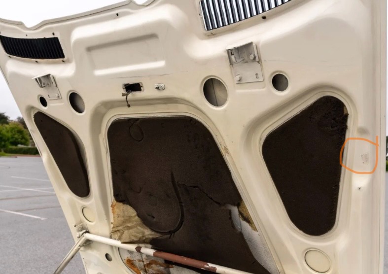

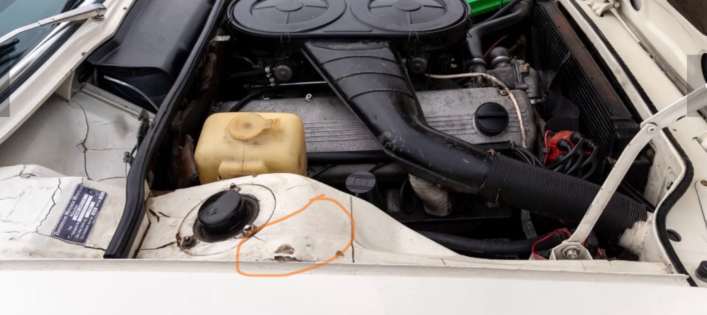

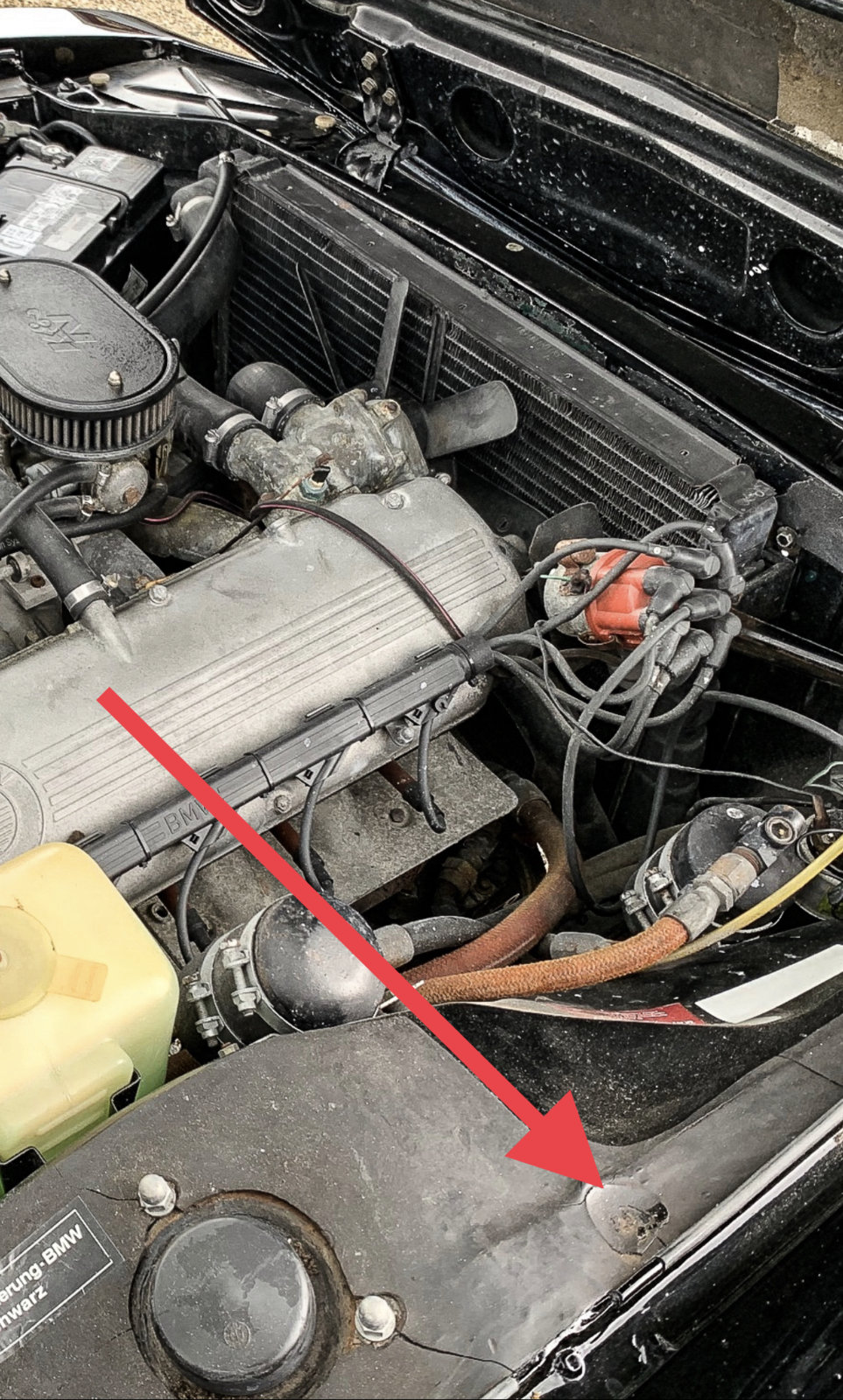

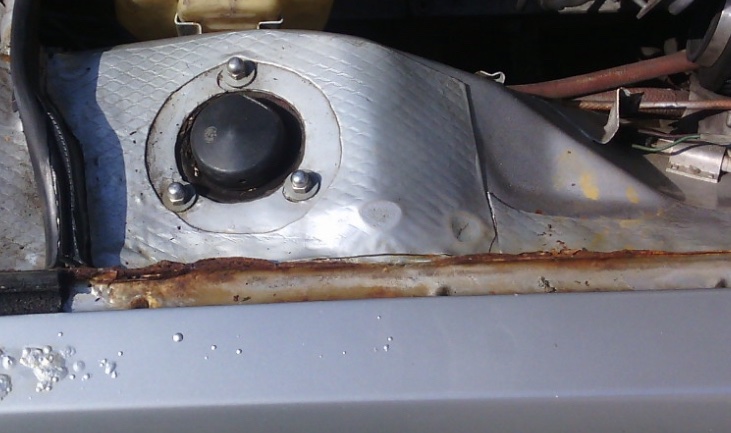

Hi everybody, I’m new and in the market to buy an E9. I’ve read most of the excellent resources on here about inspecting and buying. One thing I’ve seen mentioned several times is the “migrating fenders” where the front strut tower bulges up and rubs the hood.
I haven’t seen any discussion of the significance. Is this caused by rusting of the inner fender spaces? I.e. does it signify hidden decay? Additionally, have there been problems caused by this, such as affecting hood alignment? I know rear shock towers occasionally blow out (metal fatigue) but has anybody seen this front tower “migration” lead to a blowout, or affect drivability?
The reason I’m asking urgently (my first post) is that there is a car on BAT that looks very nice but does have this phenomenon. The auction ends in a couple days and I’m wondering how important an issue this is.

It's a good questions, but straight up: i do not know the answer. I've heard people say it, and i think it can happen if there is a lot rust.
But i try to be precise, and hear say isn't enough for me....
So I've tried researching it by measuring an all original non-welded survivor. I can dig that up for you on thursday.
Curious though what others know about it.
I suppose that could happen on a car with VERY severe rust that basically allowed the inner fender to move relative to the body, but I would imagine that would be pretty obvious, since there would be movement between the two in other areas, not just one spot
The weight of the front end is carried by the strut, and that attaches to the shock tower, so the primary force is at the ring/hole where the strut attaches, and in your photos, that looks normal. If the body was dis-attached from the inner fender (allowing the entire inner fender to rise relative tot he body) I would imagine you would see lots of cracks or wrinkles or gaps in the surrounding area.

Could be rust under the bitumen pad, causing the pad to rise up (I'd consider this to be the prime suspect. Check the same spot on the inner fender. Could be rotted through from the other side);
Might be some sort of swelling of the pad itself.
A good ice pick would tell you a lot about the two above possibilities in about 5 seconds..
Is the hood perhaps sitting low relative to the fenders? That might lead to the wear pattern you are seeing -although that would be fairly obvious with the hood closed.

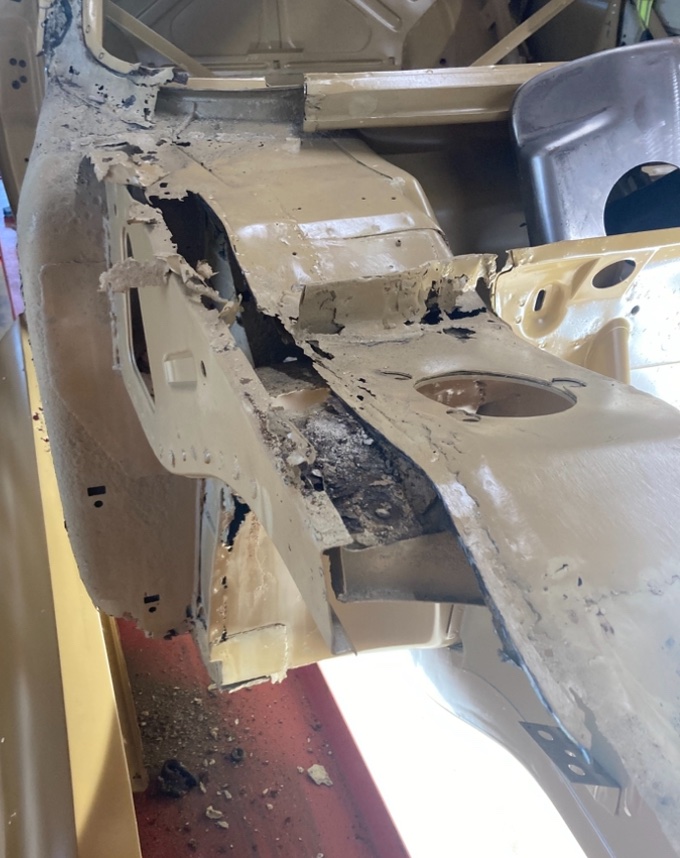

Can think of only three ways that this can occur.
1. Structural rust causing the inner fender, and more importantly, the shock tower bracing to fail as it cannot withstand the upward pressure from the springs. If you put your head in the wheel well and look up you will see a rectangular section at the top of the inner shock tower. In this scenario you would also see bonnet mis alignment. Unless you are planning a full restoration run away..
2. Significant rust on the top of the inner fender underneath the sound deadening, which then lifts as the rust grows. This is probably the pre-cursor to (1). This may impact bonnet alignment but think unlikely as there are rubber seals to seat the bonnet.
3. Crash damage or poor past repairs. If a car had a punch in the nose it could push the inner fenders back, which would distort them and possibly see them want to lift around the shock tower. Think of what happens if you try to bend a ruler how the middle rises up. I'd be looking for signs of past repair or crash damage.
Another possibility is just poor bonnet alignment, or a combination of more than one of the above.

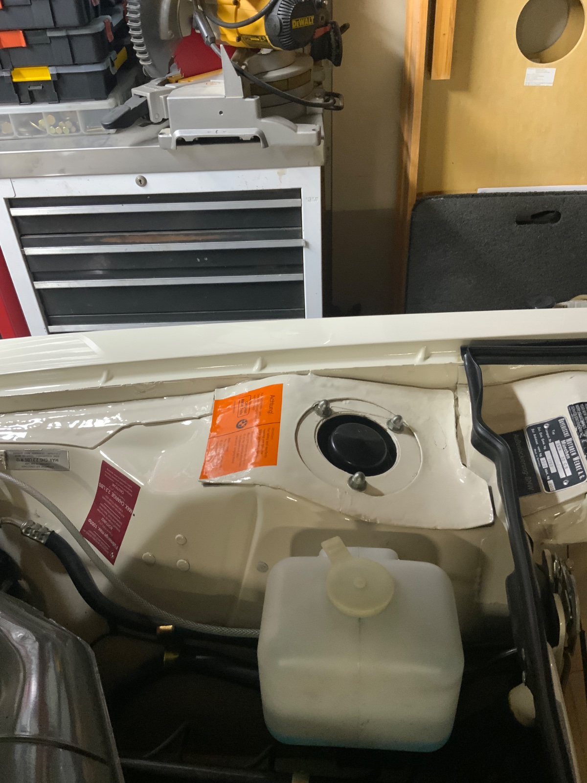

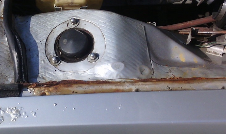

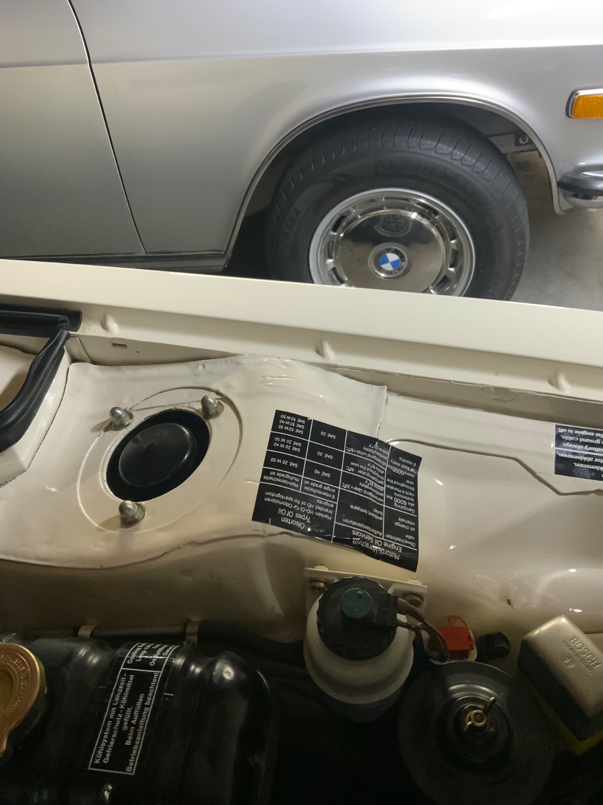

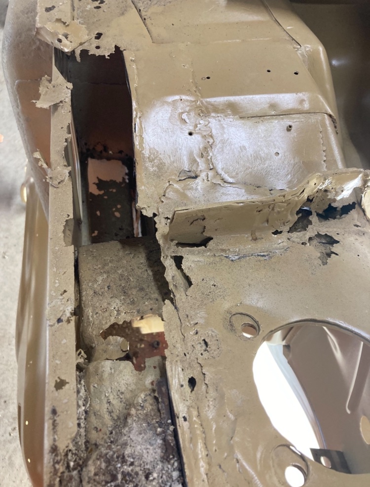

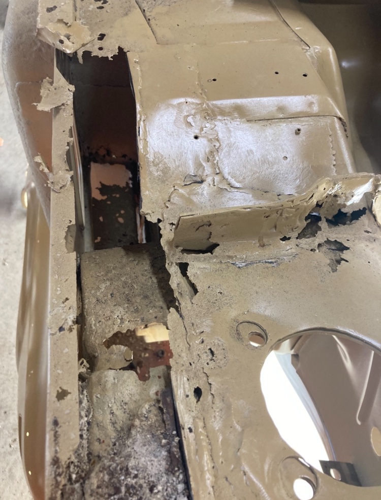

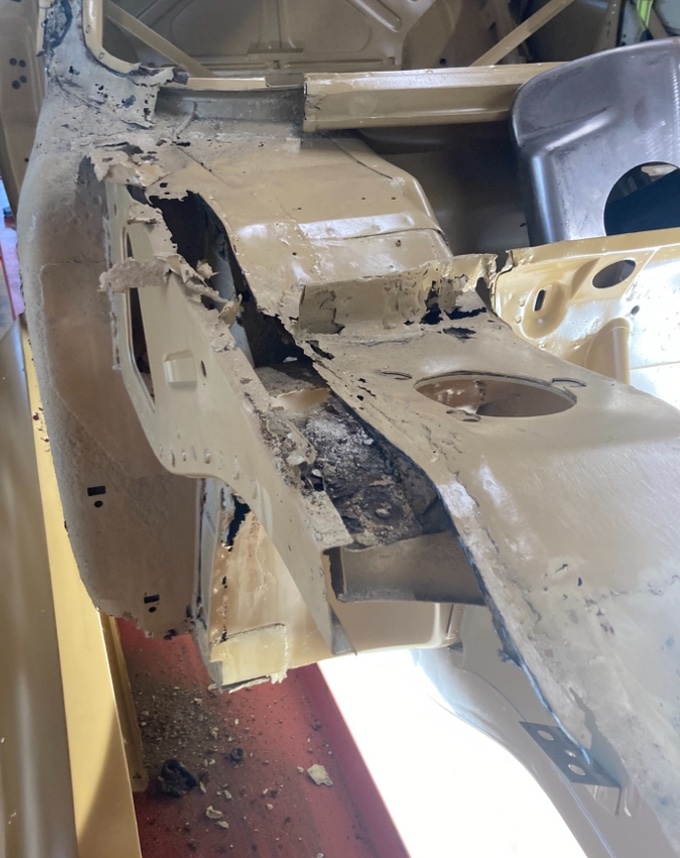

Some pictures for example. The first pictures is before the restoration (only a tiny little rusty spot :) ) and the same car after the coating is removed and the fender is removed. You can see the impingement mark of the hood in the sound isolation. Is the front strut higher?!
  • Like
Reactions: Wes
Some pictures for example. The first pictures are before the restoration (only a tiny little rusty spot :) ) and the same car after the coating is removed and the fender is removed. You can see the impingement mark of the hood in the sound isolation. Is the front strut higher?!
Scenario 1..

Hello Erik, in my car there was an metal sheet welded over the original (rusted one). So that takes approximately 2 mm of the free space.
