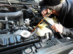

It is often difficult to differentiate between normal and abnormal without actually hearing the noise. Prior to removing the valve cover, it might be prudent to use a mechanic’s stethoscope or big screwdriver against the ear to localize the sound source. Is it toward the front or back of the valve train? Or, could it be lower and nearer the crankshaft or even emanating from one of your belt driven accessories, e.g., power steering or alternator? (Could a cooling fan blade tip be contacting the fan shroud?) A minor exhaust manifold leak due to a loose gasket could also be an overlooked “rhythmic” noise source, although it is typically described more like a knock rather than a tick. (Your tick might be someone else’s knock.) Depending upon the noise level, it is also quite possible, as suggested, that the oil spray bar is loose. Electronically triggered injectors ordinarily make a minor clicking noise, too. A vacuum leak where an injector tip fits into the manifold can sound like a squeak.

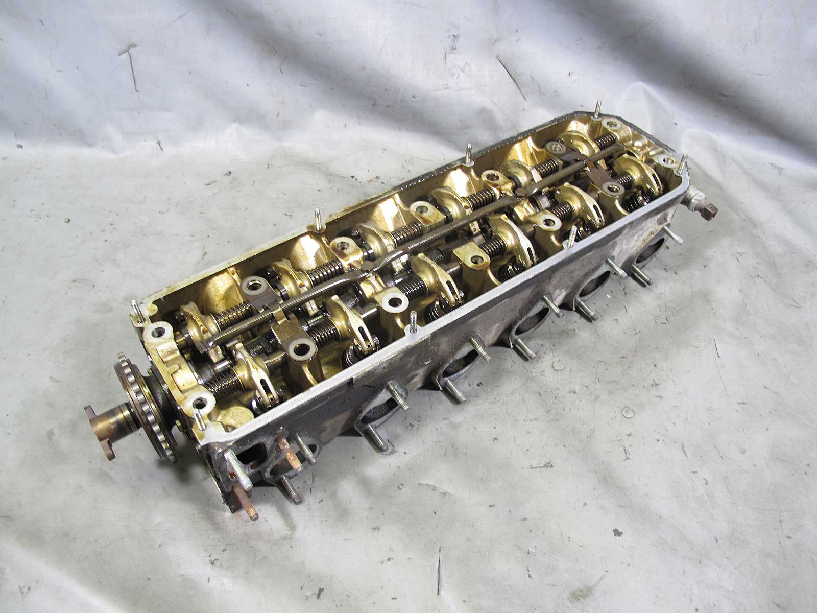

iu

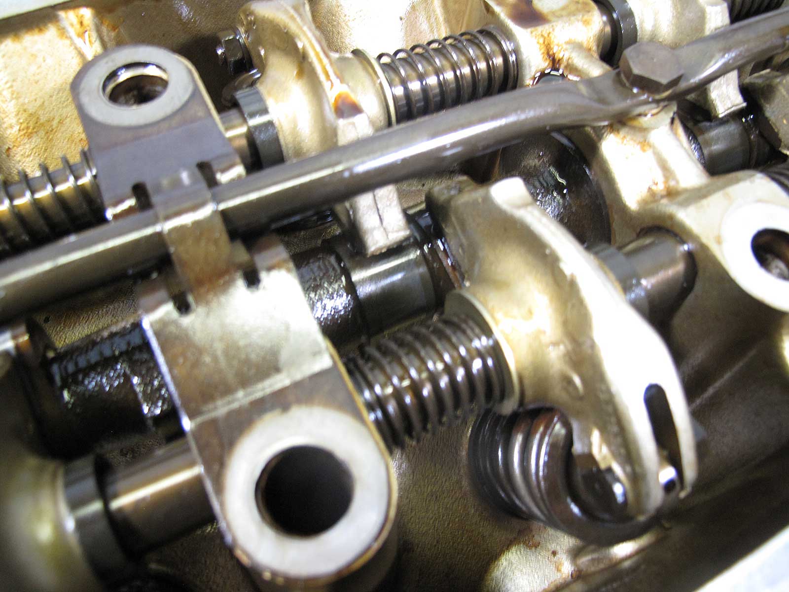

oil spray bar?
